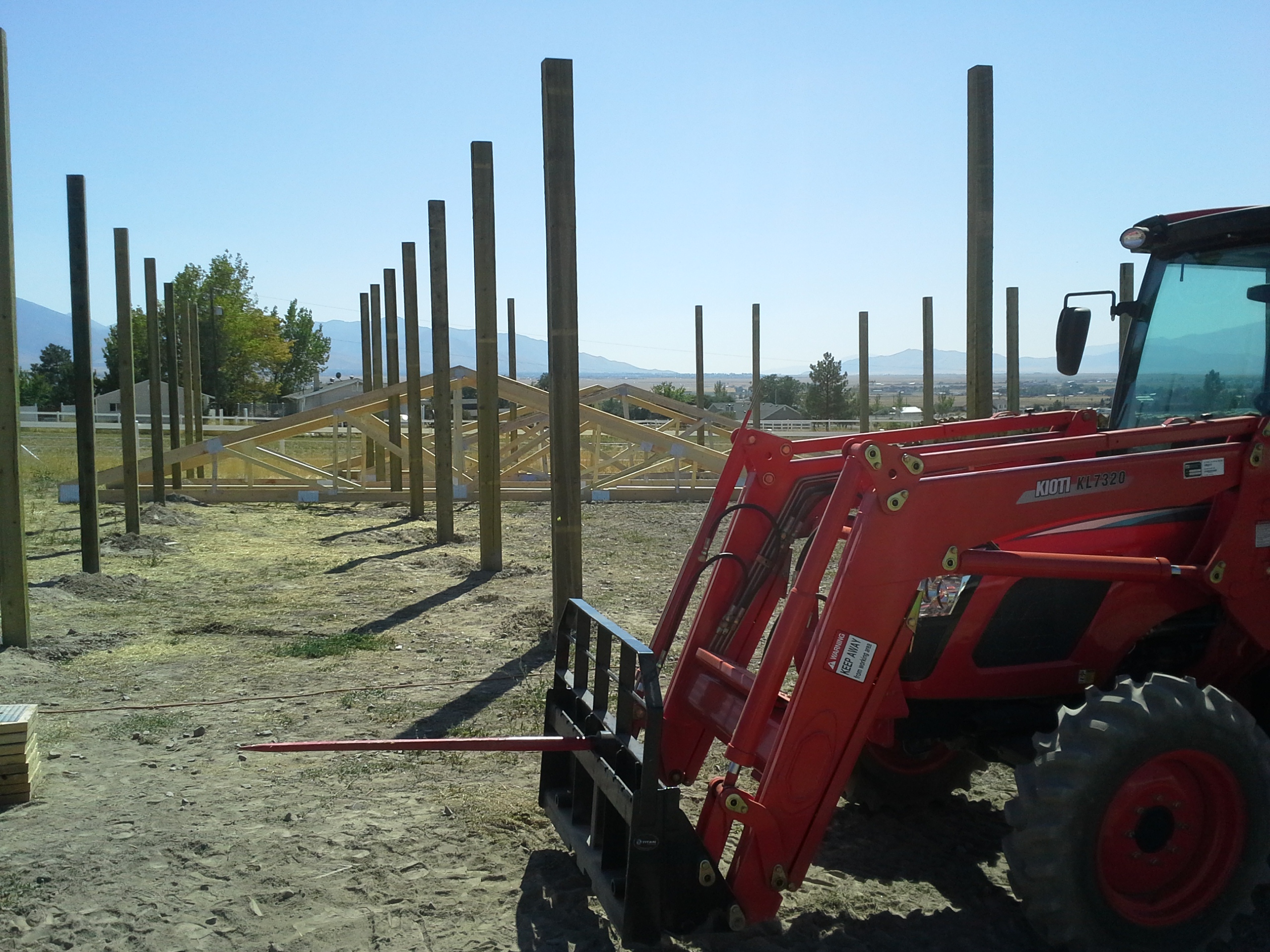

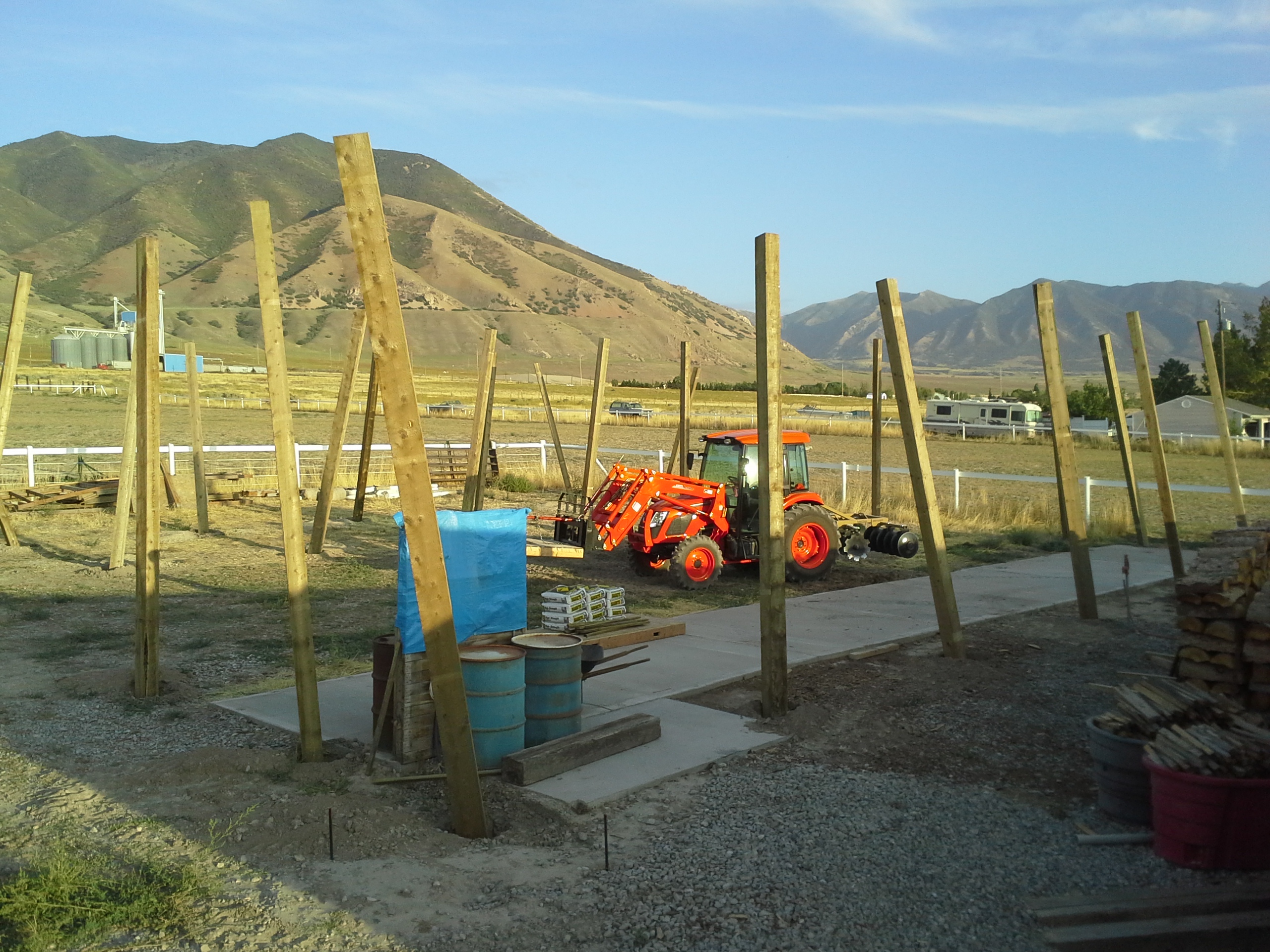

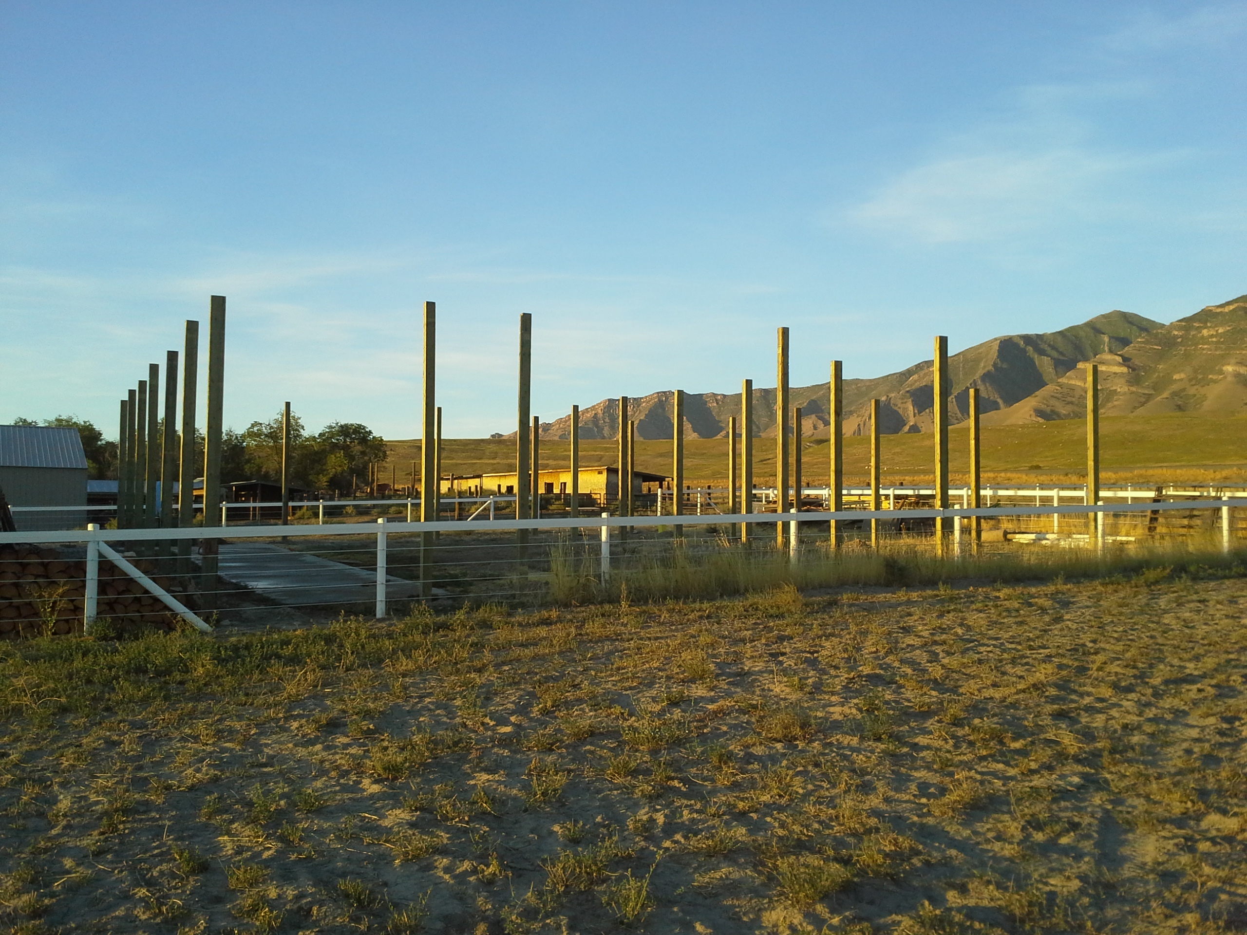

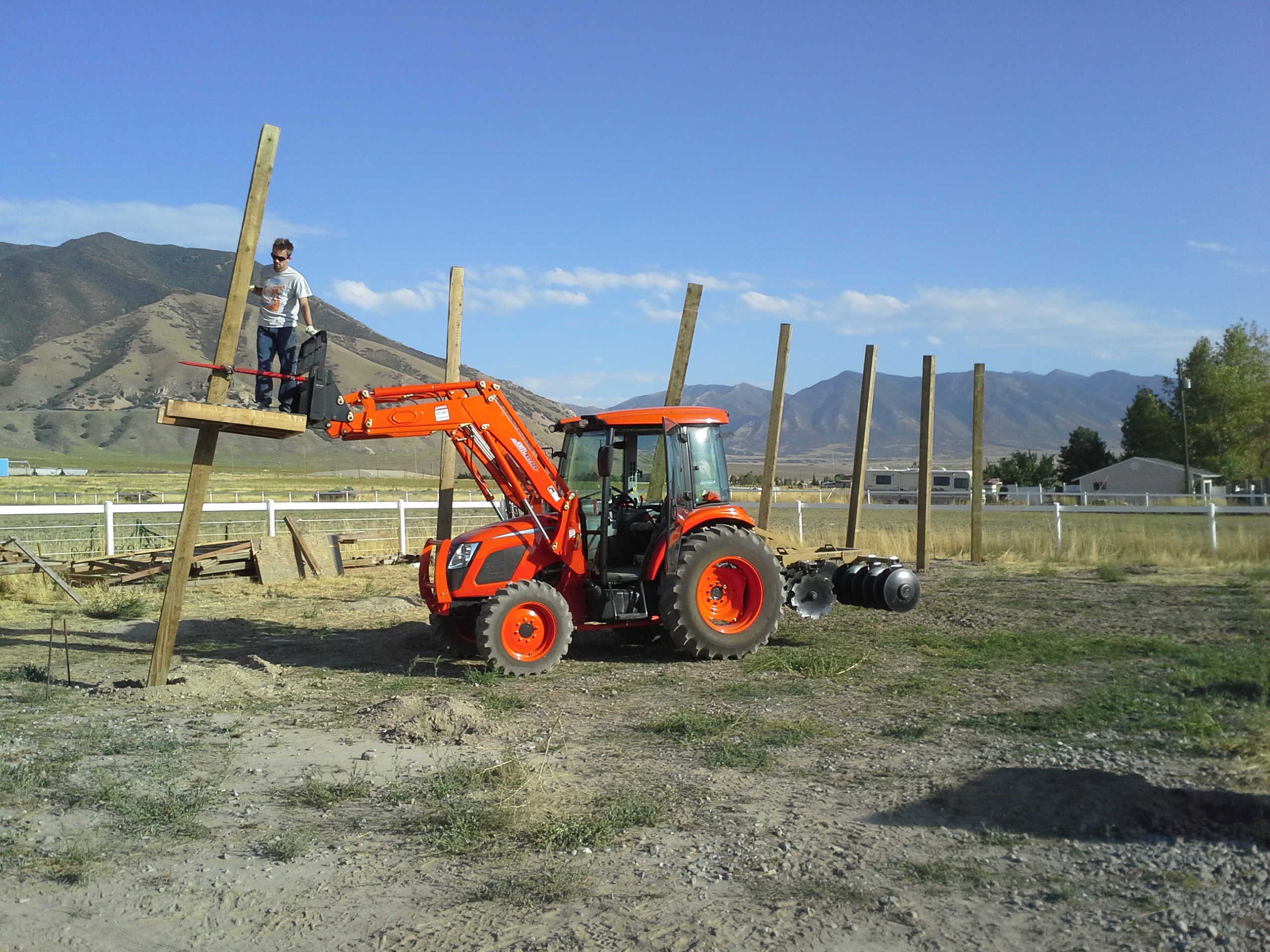

I have built 3 pole barns over 15 years. The first two were just dirt packed around the post. The last one I put concrete in the holes. Mostly because there were so many I couldn't bare the thought of tamping that many post with dirt.:laughing: I have no rot or any concerns with any of the barns.
Here's a couple pics of the poles being set. 6X8X18

Thanks for the pics ! Very nice looking job. Are those 'wall side light panels ? I have then included in my plans, both sides. I have an addition to the home I put on 8x8 treated post 8 years ago....still looks good. They are pretty much sheltered from the rain. I am always looking for new products that make building better. If I get the post direct bury I will only put concrete in the bottom of the hole....those post will rot quicker if totally enclosed in concrete. If I was younger (66 ) I would do it myself, but getting on tall roofs is a chore !!

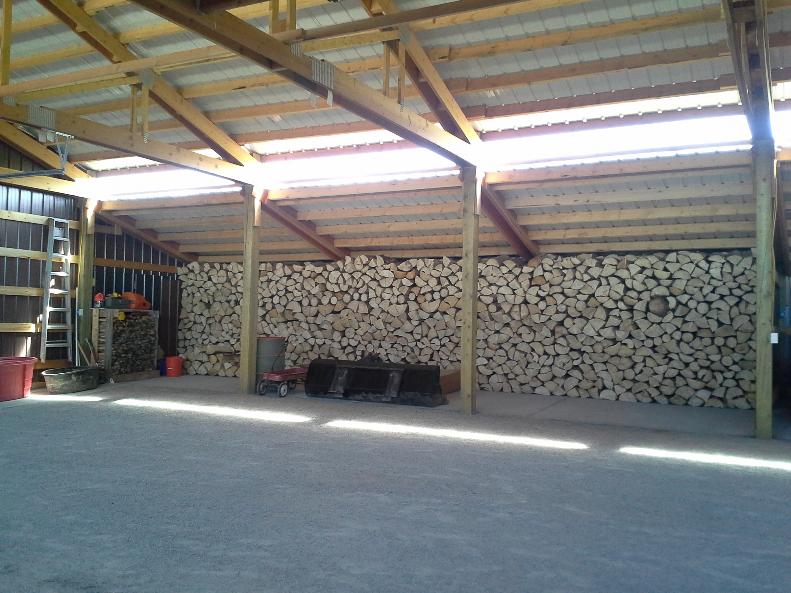

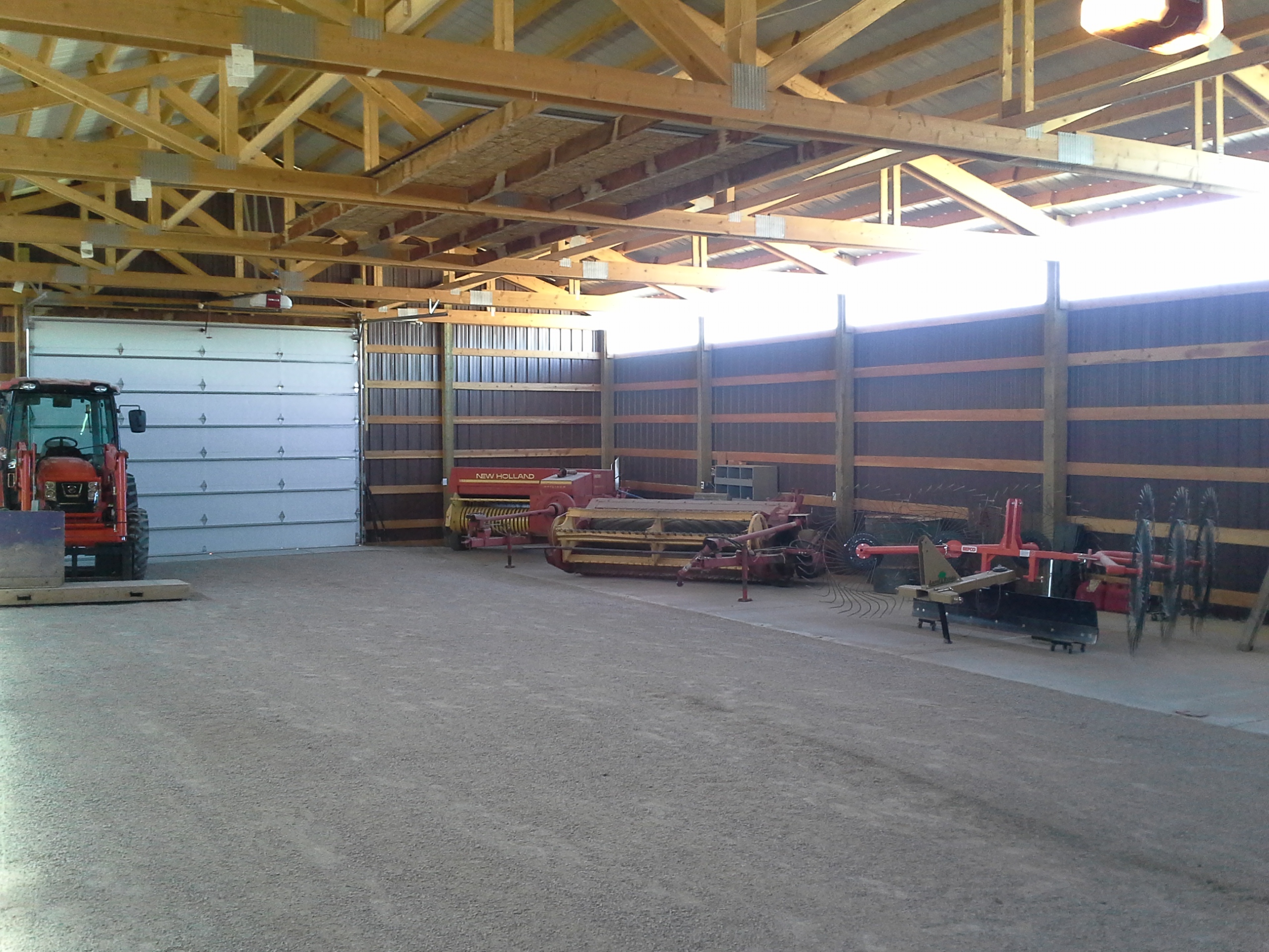

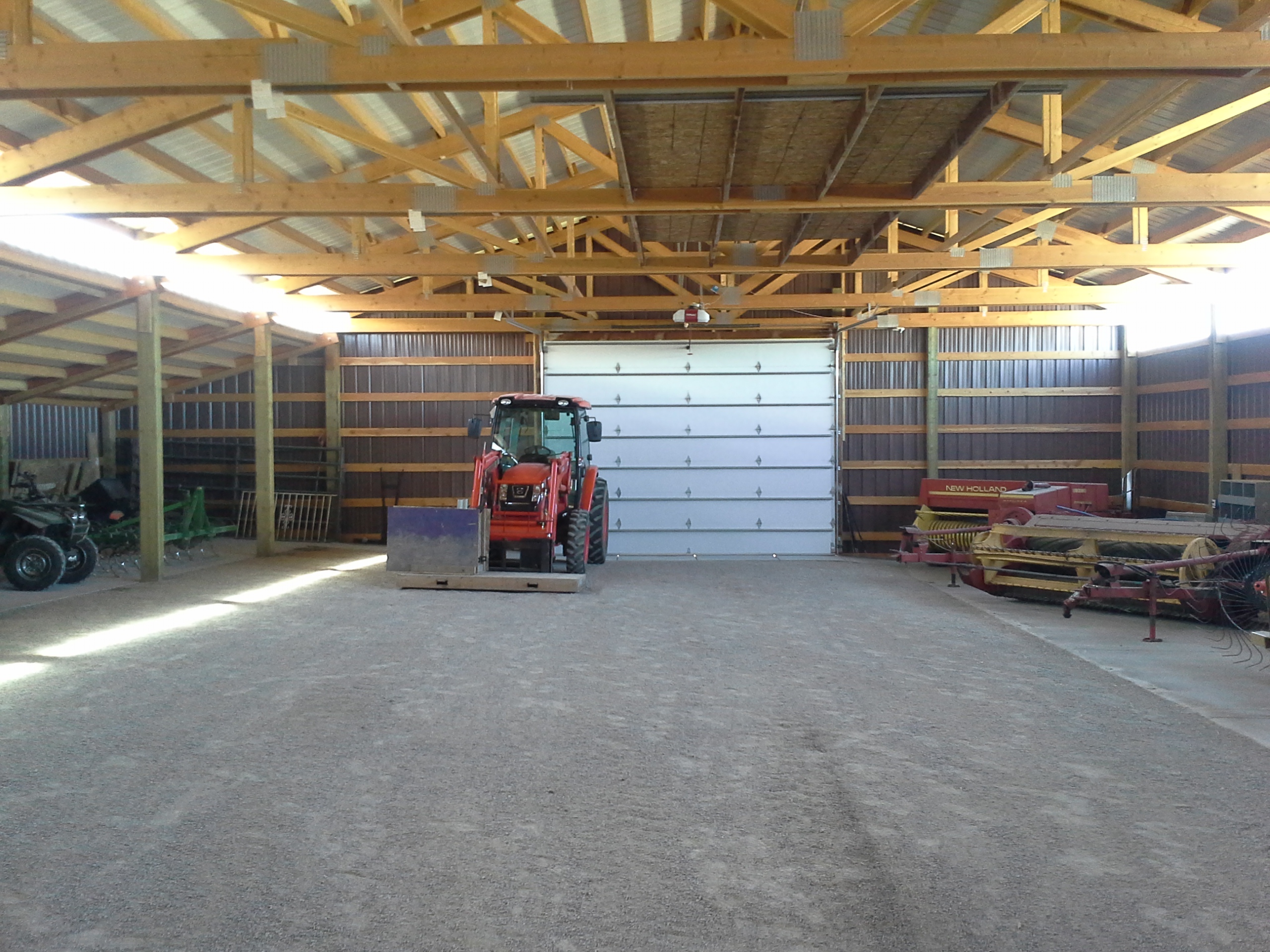

Yes, they come in 8' lengths. (I think, can't remember) We cut the size we wanted.
On a cloudy day with all the doors shut you could easily work inside without any additional light.
These pictures it was a sunny day but you can see how much light they let in.
