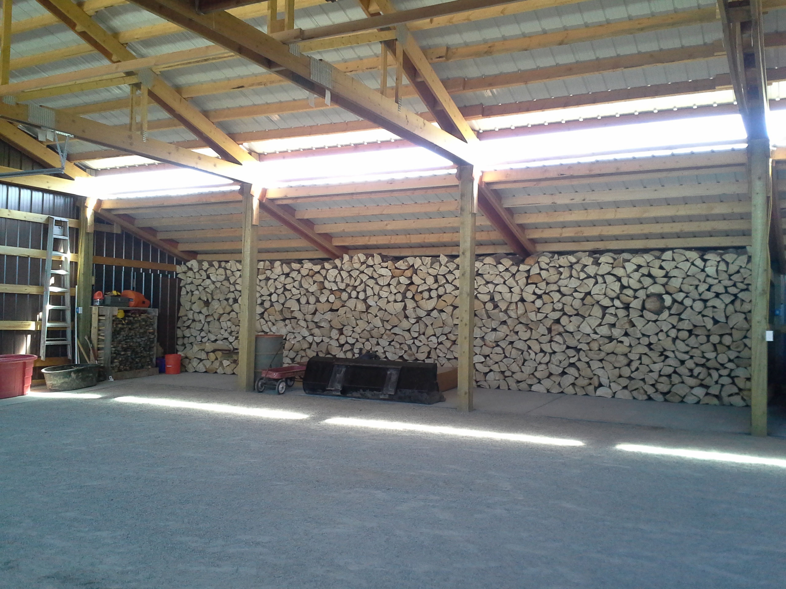

I usually get firewood every year but don't burn it all, so it just keeps piling up.

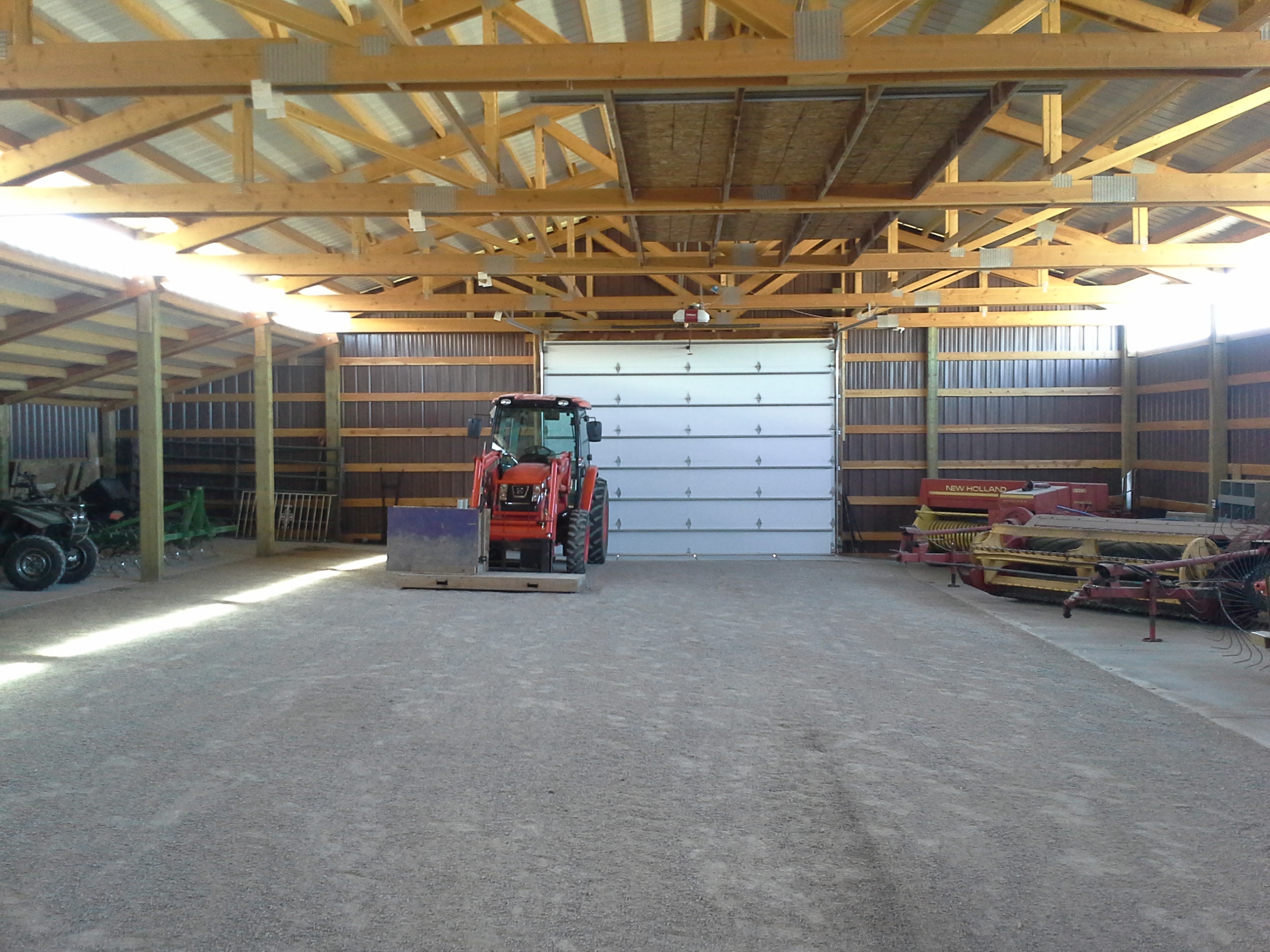

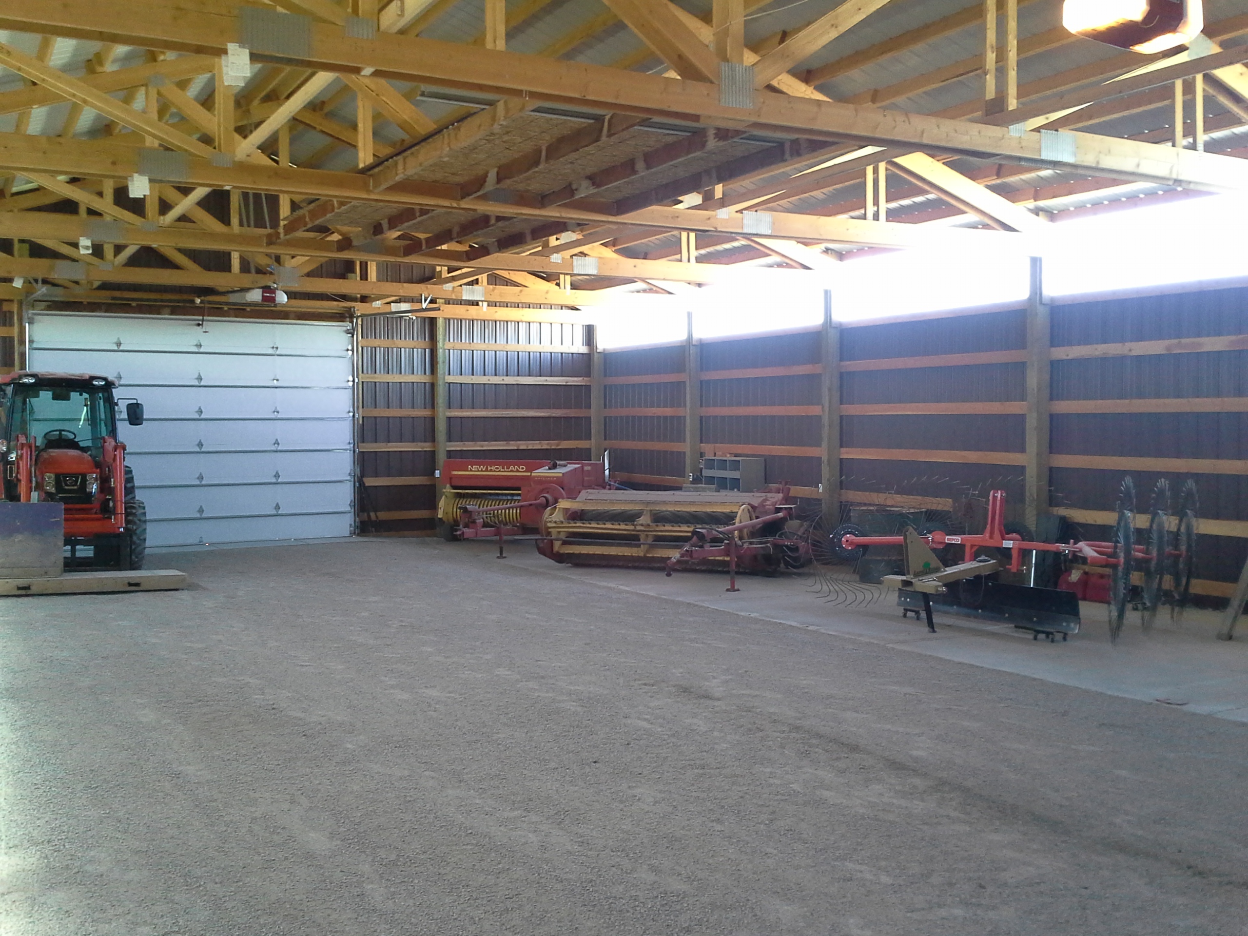

I bought all the material on my own, the plans were in my head. Kind of made it up as I went along.
In the "Rural Living" thread I detailed the building of my barn. The title is "Raising a Barn".
Mine is 72X57X12 the awning is 12' of the 57'. Total cost was about 30 grand. I did all the work except the concrete and big doors. There were a couple small mistakes along the way, but only a trained eye would catch them. My family and friends sure didn't see any of them.:D
View attachment 539250View attachment 539251
Thats a big barn and good price ! I just don't have the time to build myself...although I would luv to the DW wants it done yesterday ! I will look at your 'Raising a Barn'.
