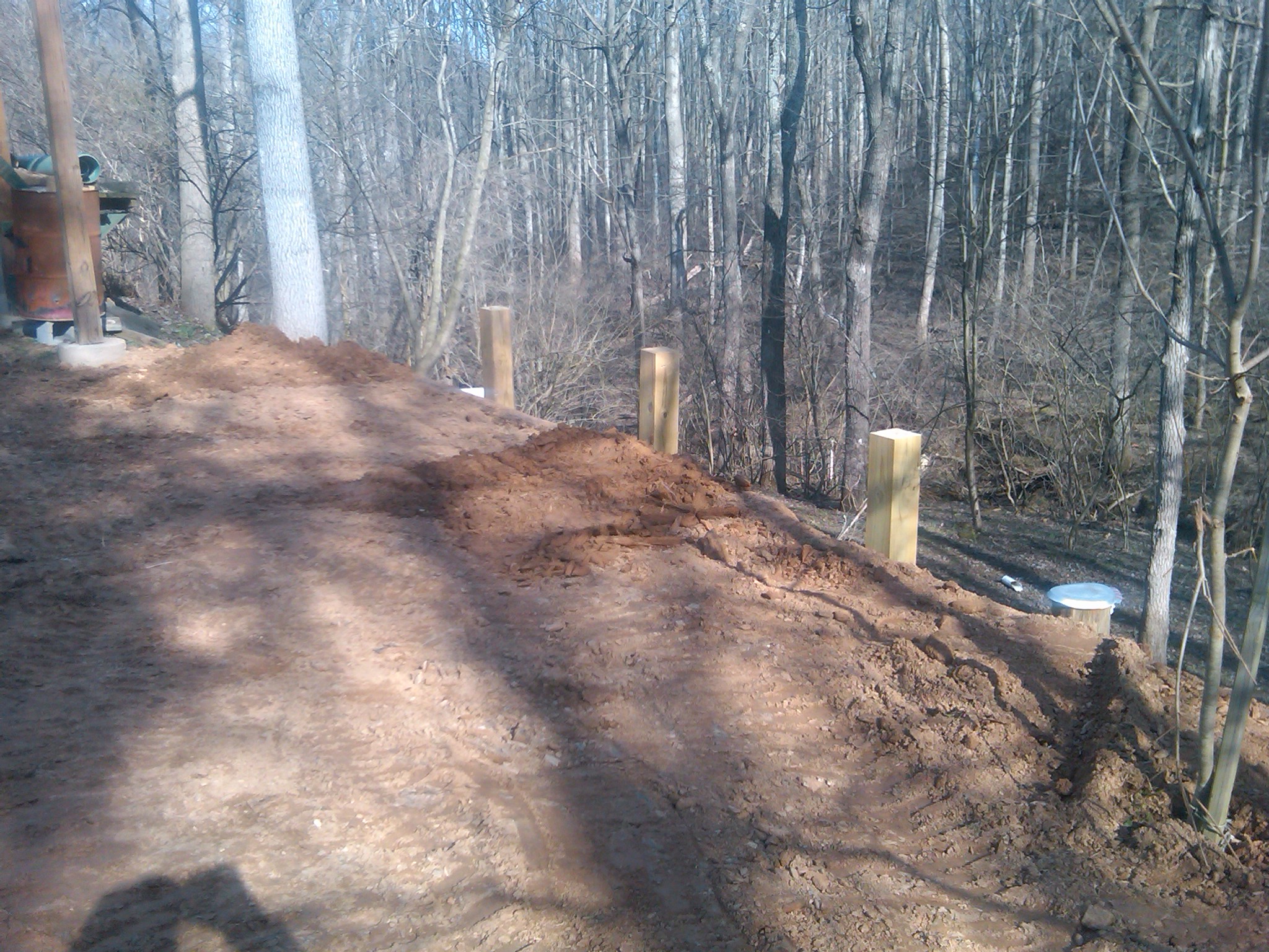

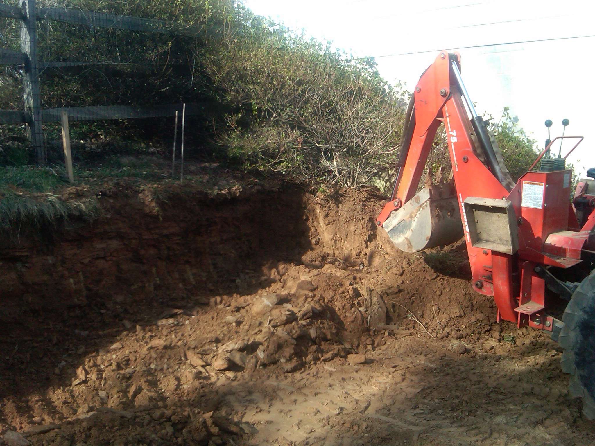

Put my CK to work today. What a digger!
Building 2 retaining walls at the same time. Removed dirt from one wall and used it to fill another. The fill-in wall is made from 3 rows of utility poles laided horizontally accross 6x6 posts. Cheap wall, but I think it will serve well for its intended purpose. It's 32 feet long. Can't see the poles in the photos. They are buried. Upper wall, where I have it cut out will be stone (cornerstone brand) with a set of steps built in. Hard to tell it from the photos, but it's over 4' tall.
The CK made the work easy. Dragging the poles into place. Digging out the bank. Backfilling. Then backdragging. When finished, the whole thing will get 6" of crusher run over geotex. Will post more photos as I progress.

My bucket is 18" wide. Yes, I got plenty of seat time this weekend.
I have no set dimensions. The space will be defined by the wall, not visa versa. The only critical part is the steps, which will go in on the right side. I'll start at the barn and work from right to left, through the steps, which will be beside the azalea bushes. When I get to the left "end" the perpendicular wall location will be dictated by where the long wall ends. I don't have a good way to cut and have laid it out to minimize cutting. The perpendicular actually is not perp., but rather tapers out to maximize the parking area that will in front of the wall.
The blocks I'm using are 8 x 18 x 12 deep. There will be 6 courses across the long wall, which means the steps will start 6 feet in front of the wall (1foot rise (including 4" caps) to one foot run. I've never built with this type stone before, much less putting steps into one. I think I have it right. The nice thing about these stone is if you screw up, you just take them down and start over. I will be very meticulous as I work through the steps to make sure they are right and will try-stack several courses to make sure.
I have the pads laid now in wide trenches. The pads are 8" deep crusher run, tamped in and leveled in both dimensions. The 18" bucket came in handy digging the 3' x 1' deep trench with a 5' x 1' trench for the steps. All together there is 46 running feet of trench.
The fence at the top of the wall will get a gate added, and a railing will be built on the top of the wall down the steps. The blocks are hollow, which works well for placing railing posts into and concreting into place.
It's now ready to start laying the stones. I will post some more photos soon.
Any advice or suggestions that could help?
