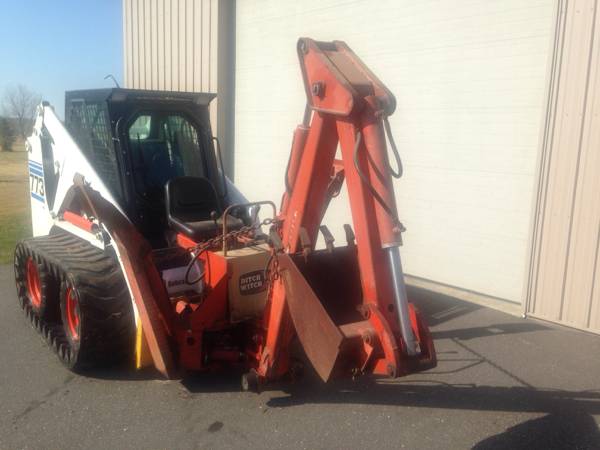

Has anyone used a quick attach backhoe made for a skidsteer on the front of their tractor's FEL? Any thoughts on if this would be easier on the tractor rather than using a 3 point mount?

Good lord, no.
The 3-point is way stronger than the loader. A skid loader has a MUCH stronger loader than a tractor, and yet skid loader backhoes have a mount on the skid loader and hoe that couples the two together so the force isn't on the loader.
It's also real short so the backhoe can exert much less leverage.

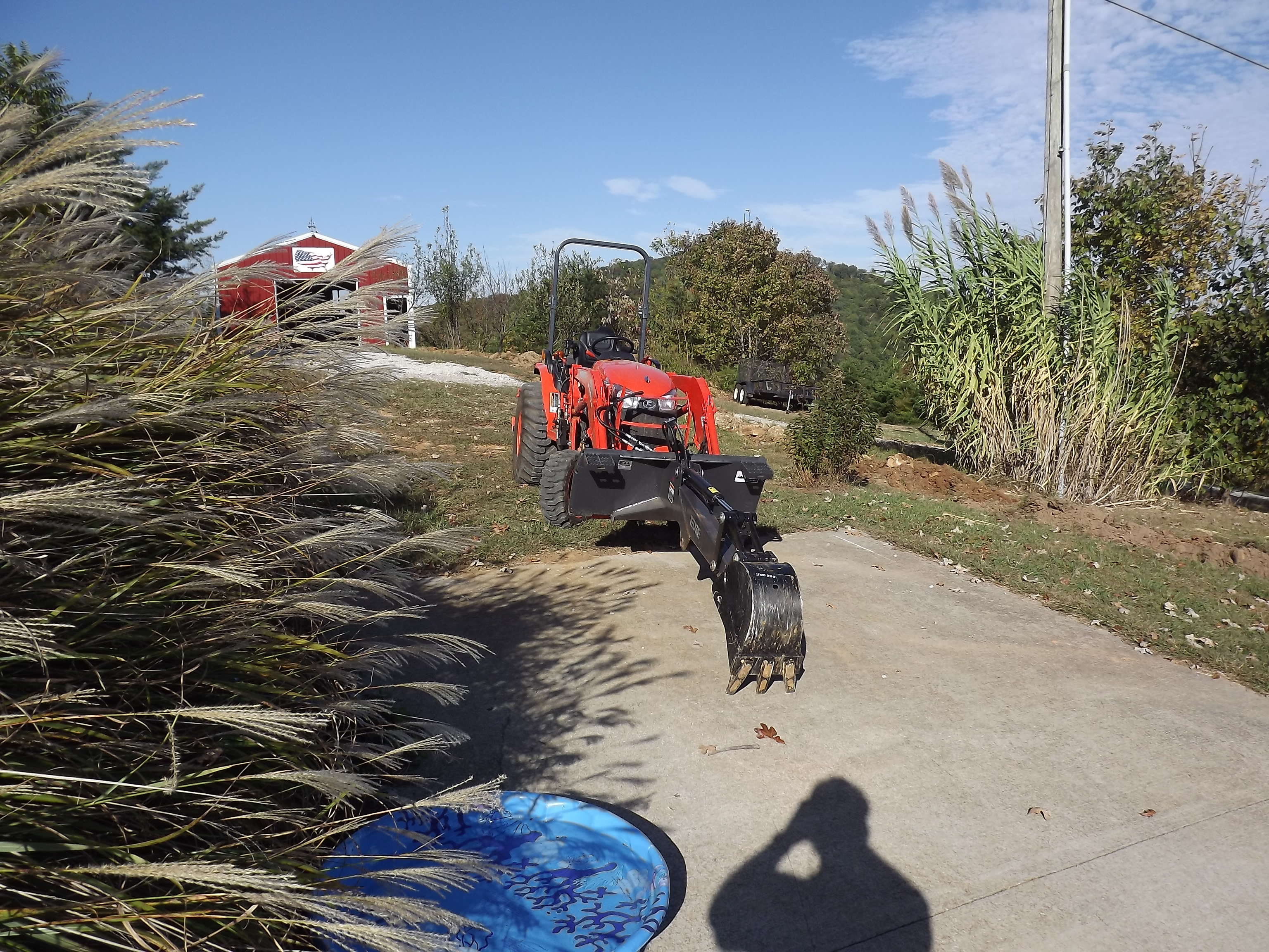

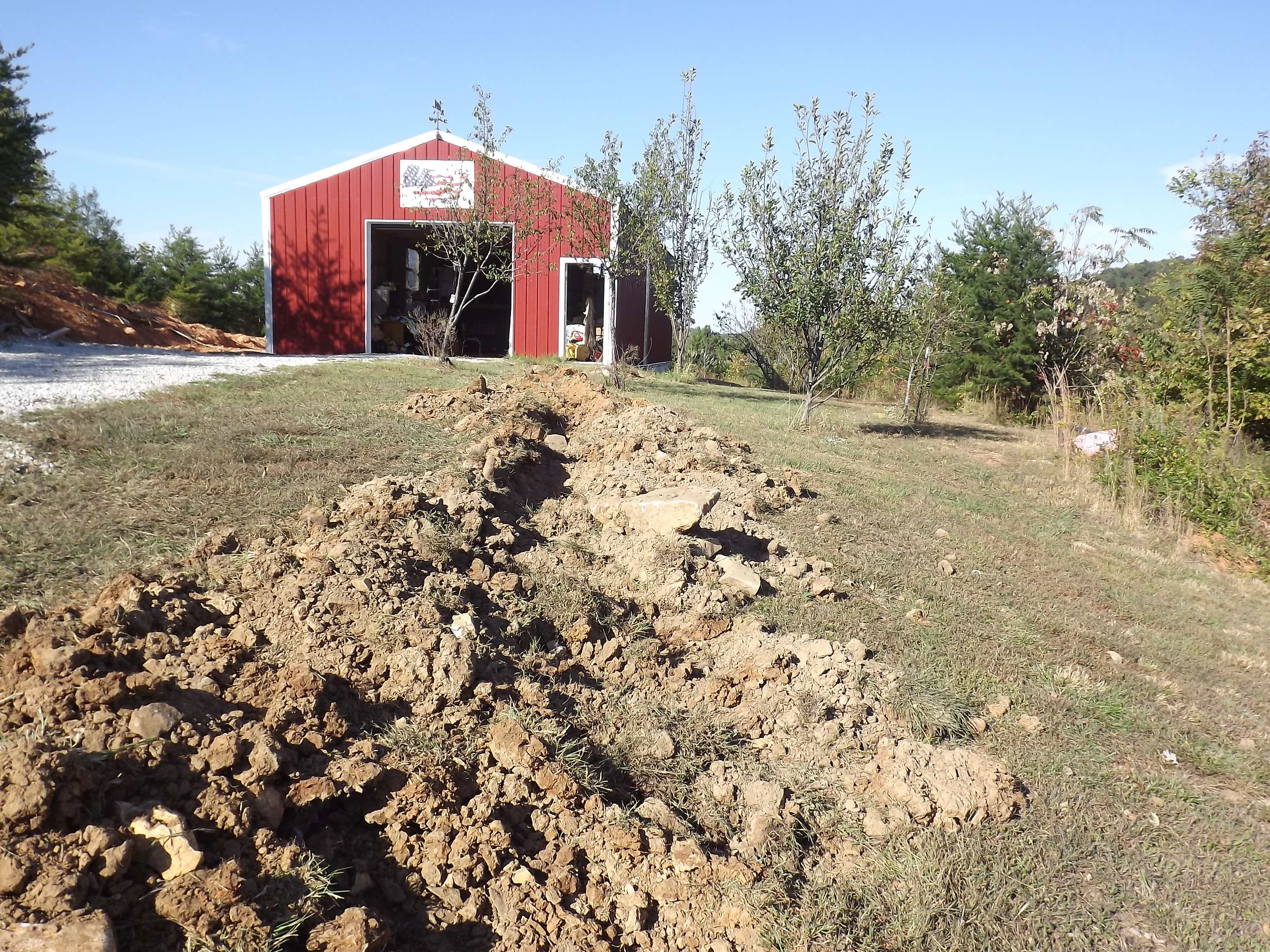

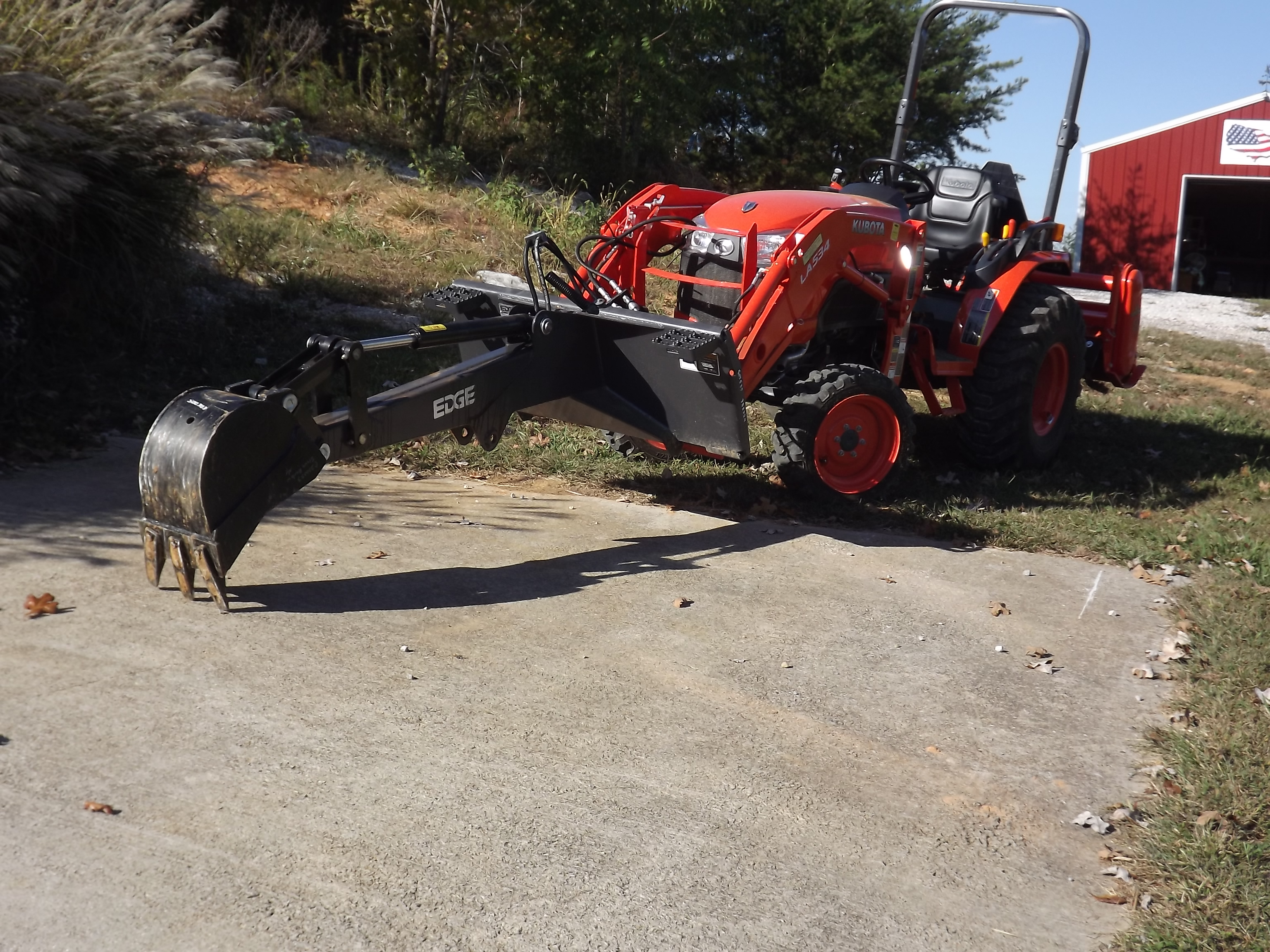

I've got a case dx100 on a subframe that goes on my kubota L3410 works pretty good, just a bit slow due the the hydraulic pump flow is a bit low for the hoe.
   / What about a skidsteer backhoe on a tractor? #9
countrybumpkin.....could you post some pictures showing the mounting connections/method for your backhoe? I have an older D100 that I would like to mount on my ford 335 and any suggestions or advice would be greatly appreciated.
   / What about a skidsteer backhoe on a tractor? #10
Yes I'll see what I can get for you.
