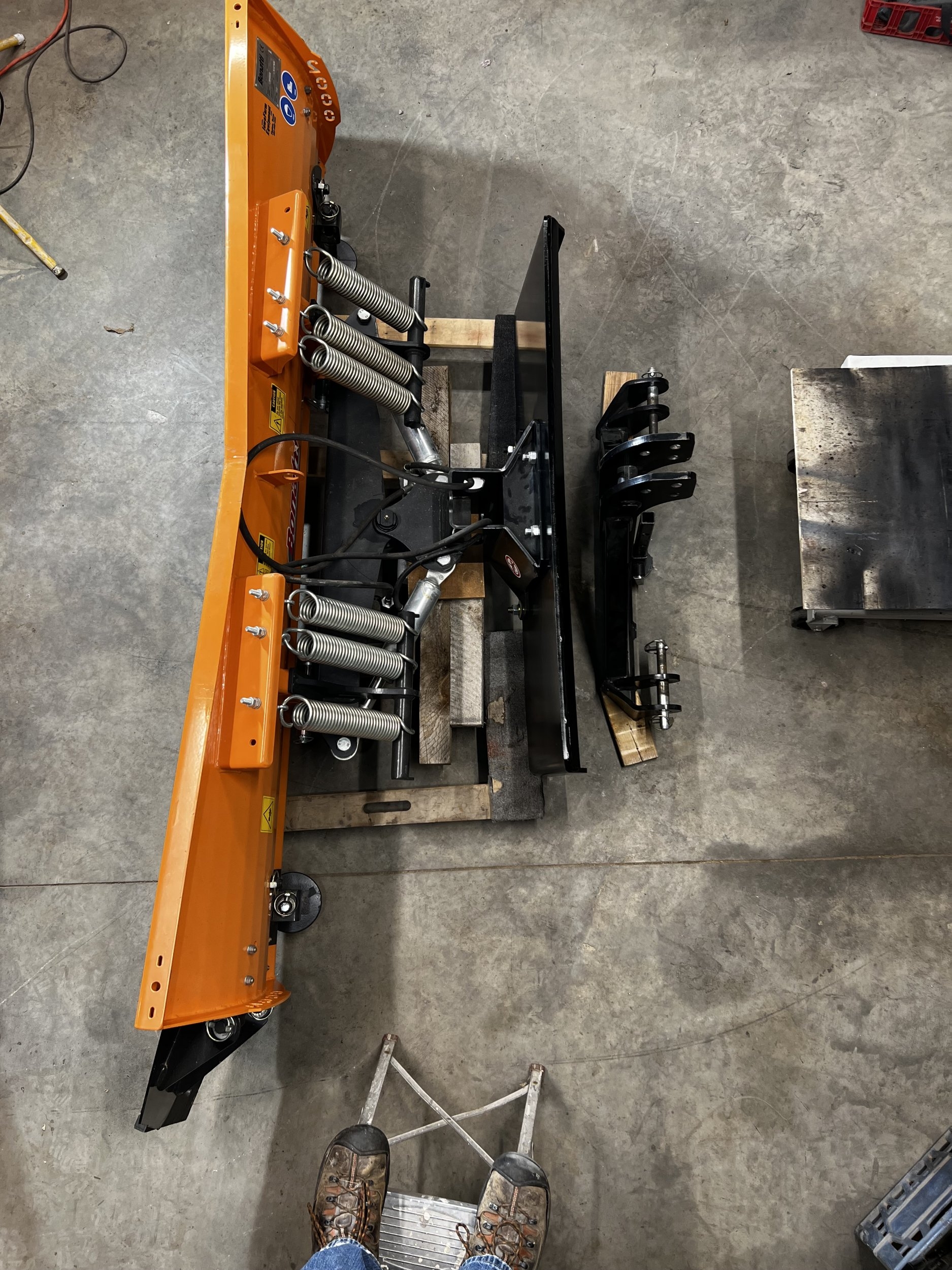

8' hydraulic angle snow blade on a reversible Antonio Carraro TTR4400HSTII works great with floating 3 pt arms. Selling the tractor and now looking to use this setup on front of UW53 Toolcat. Toolcat has floating arms similar to a FEL but concern is the weight on the plow when gravel roads are NOT frozen. Snow blade on the tractor 3pt arms is very light on the shoes and works great in these conditions. While these arms are not huge, the weight and the high pivot point are less desirable than floating at the bucket pivot.
I know that I could switch to a floating plow design, like a truck mount, but I have this plow and it isn't a floating design. Seems like someone would have done this?
Wondering if anyone knows (has experience with) float function possibly added to the bucket hydraulic circuit? I envision a solenoid valve that would simply "open the circuit?" and allow the bucket only (or snow plow) to float. I have an advanced hydraulic company in my hometown that can help with parts but I wonder if anyone has tried this?

Good point Rustyiron, but the ssqa plate was far cheaper to bolt on. I don’t have an adapter to 3 pt. I set the 3pt bracket that I took “off” next to the plow with skid steer quick attach plate that I bolted on.

Think about how that plow works. It rides on the shoes and floats up and down be it on a truck mount or the 3pt arms, as the 3pt arms don't have power down. They float just like a truck mount.
It'll work the same way on the FEL arms.
You have trip springs, so if you hit something solid it should trip over it and reset.
About the only thing you'll have to watch is the angle of your dump/curl setting. Curled too far back and you'll drag the hitch. Curled too far forward and it may ride up over wet snow.
I've had a power angle plow with dump/curl and gauge wheels on my FEL arms for about 20 years. Works great.
If the plow tries to dig in and lift your FEL arms, your machine will try and ride up over the FEL arms. So back off and take it out of float and it'll push instead of climb.
Takes a bit to get used to, but the ability to stack snow up way higher than on a 3pt or with a pickup is well worth it.
