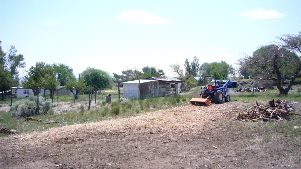

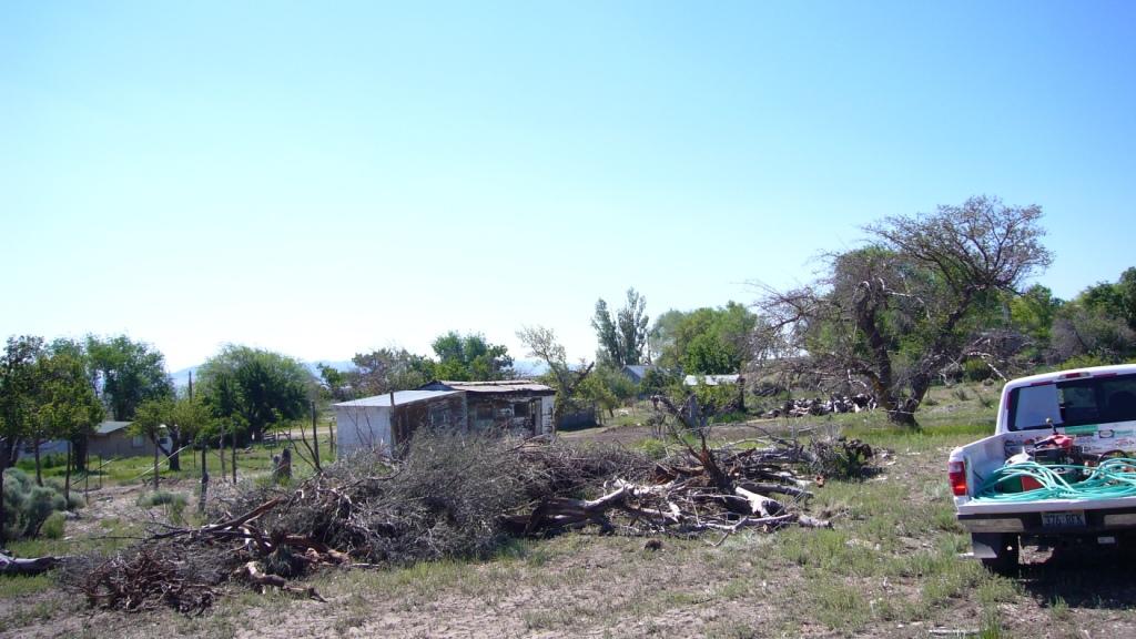

03 Compost Pile.JPG01 Brush.JPG02 Gone.JPG I do about the same.. grind it up, pile it, rototill it into the garden in the spring... works perfect

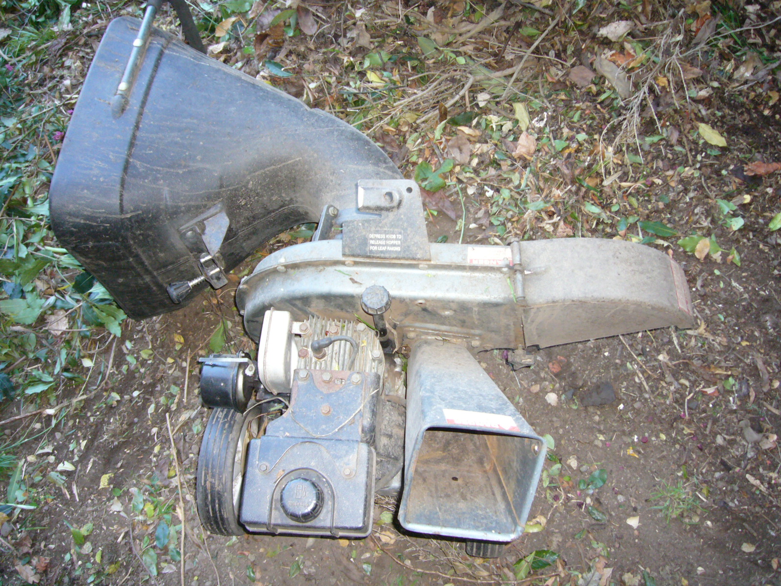

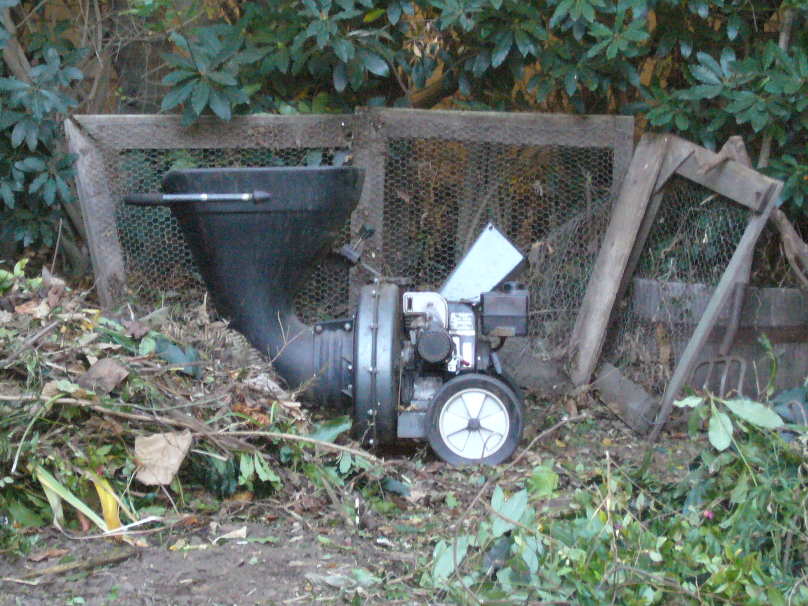

I think the Mac is a later version of the old Sears models. The best small grinders! I think the whining public forced them to add the no-throwback chute... incidentally making it much harder to feed. I too took out the counter-combs to get thru-put, only adding them when I use it to pulp apples and pears when we make cider.
The older ones had a metal chute that dropped straight down to let stuff be raked in. The one in the pictures has a plastic one that somewhat restricts the pieces that tend to fly back out... The older ones also had a ring with 4 stubs sticking out about 3/4" where the chute bolts to the body.... that held back the in-feed so that the wheel got a couple more whacks before it got into the chamber... it shredded better.
Hardfacing the ends of the little hammers and balancing them did wonders too.
Great tool.
