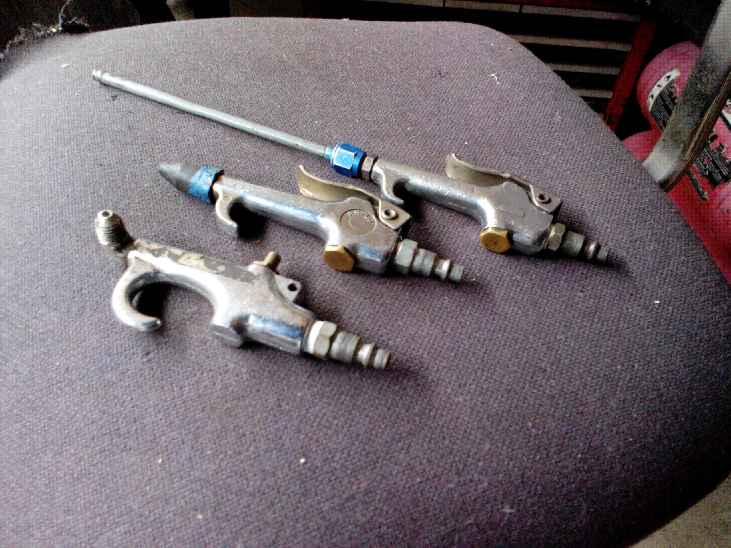

   / What air tool/nozzle do you recommend for blowing out radiators/coolers? #14
Sometimes you just have to make up tools for different applications. My default is the one in back with the 10" fuel line; also have one with a 3 foot line with a bend for sweeping the floor.

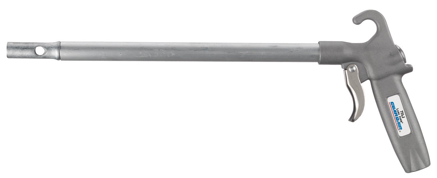

   / What air tool/nozzle do you recommend for blowing out radiators/coolers? #16
I use this for cleaning the floor and other areas in need.
The venturi effect is great but the air flow is all directed forward.
A strip of duct tape across the end fixes that.
Then remove it afterwards for general use, again.
I'm not much for single use tools around the shop.
Whenever possible
Guardair 75LJ012AA Long John with 12-Inch Aluminum Extension and Alloy Nozzle
