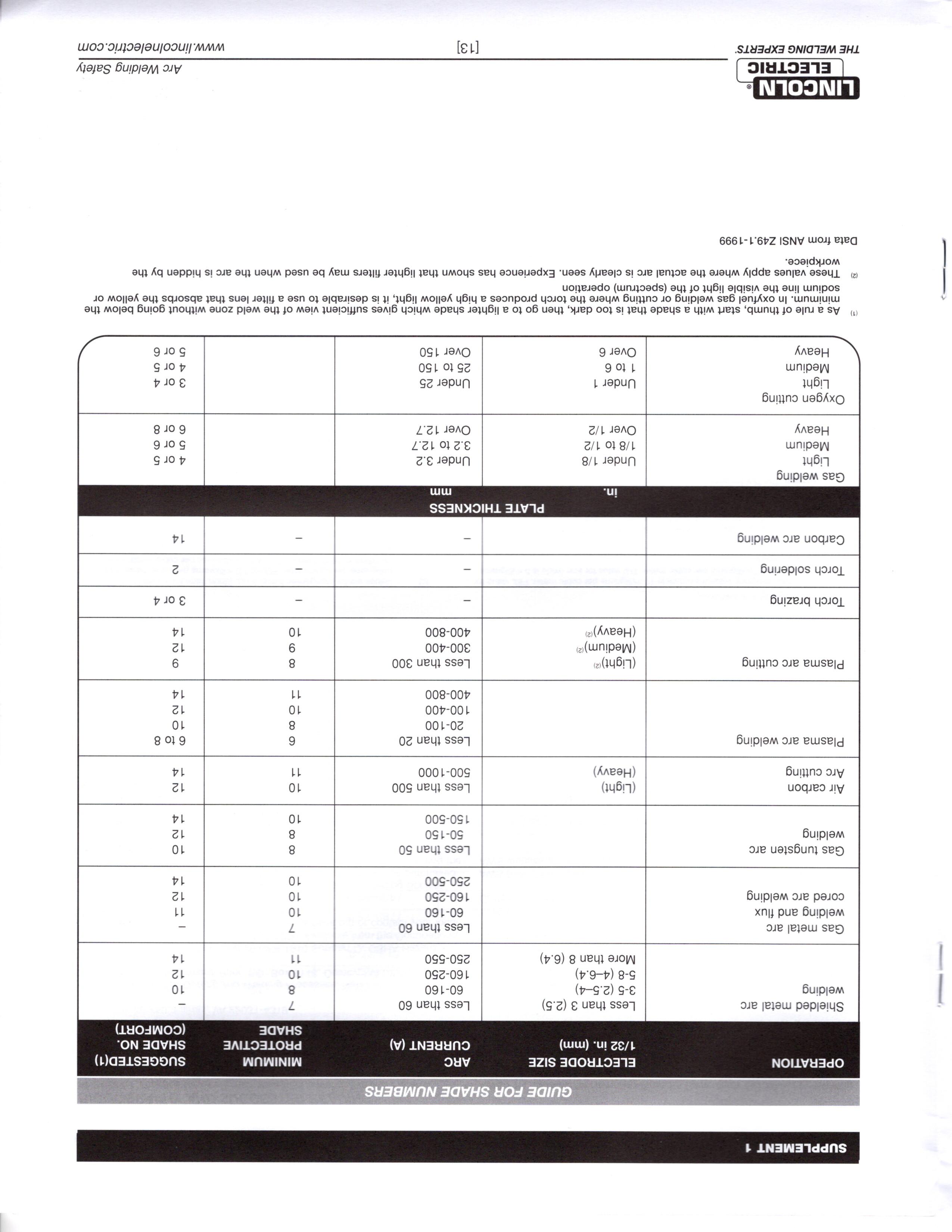

Most variables are individual in nature. There are minimums established by safety concerns with your eyes. If you have never had arc burn, you don't want to have arc burn. Attached is a excerpt from Lincoln's welding safety criteria which may be of assistance. If I go to 12 I cannot see the puddle well enough to control it.
Any one serious about arc welding needs the Lincoln "Procedure Handbook of Welding".
Ron
