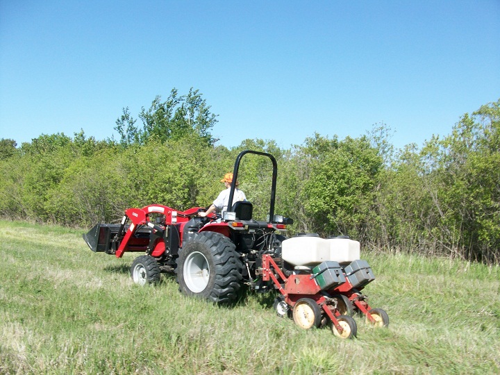

If you are looking to plant more crop type plants such as soybeans, peas, corn, etc. look at building a no-till planter. I picked up a couple White 5100 row units and made a mini no-till planter by adding 200# of additional down-pressure to each unit, and using Danish s-tines with narrow ripper sanks mounted in front of the units as sod-rippers when needed. I spray glyphosate after to kill off the existing grasses on a first planting, or any weeds on a re-planted plots. Works really slick, very fast, no tilling, and in our soil type the "crops" do very good.
I can only dedicate 1 weekend to bring the tractor to where I hunt (150 miles one way). The no-till works great, I can seed 5+ acres of plots spread over 240 acres in half a day plus do a host of other chores over the time I am there. All the seed I use except for peas is glyphosate tolerant, so any time someone goes to the hunting land over the summer they spray the plots with the 4-wheeler to keep the weeds down. Works great.
Here is the Mrs. planting soybeans on the largest plot on the property.
