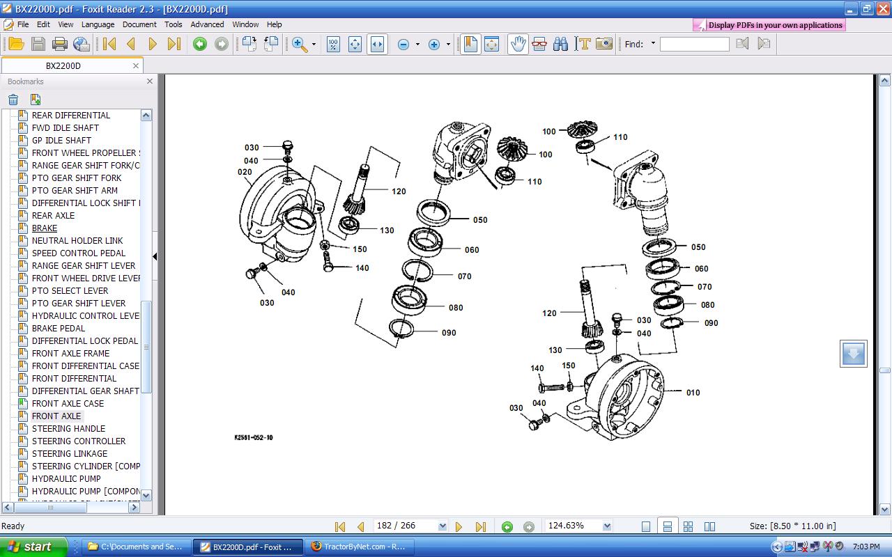

My BX2200 has 735 hours.
So far, I need a new air filter bracket, but I will likely do my own thing here.
Also, both front axles sides drip oil. The drip is coming from the vertical part right beside the tire. This part articulates to actually allow the steering to happen.
(Item 50 in the pic).
Also, I replaced a loader hose and all the quick connects on the loader because they started leaking.
That's about it!
