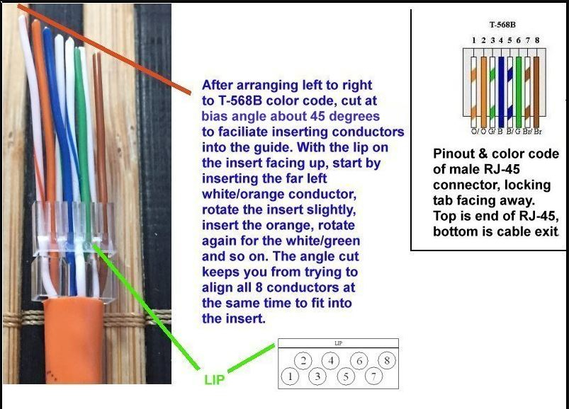

Two suggestions on crimping-
- make sure the untwisted wires are cut at exactly a 90 degree flush angle. Don't allow even a minor variation in length of the wires.
- before crimping, make double sure the wires are pushed hard enough into the connector so every wire is completely seated. Use glasses or magnification if needed to make sure of this.
I was having about 25% of my crimped cables inexplicably fail. Close examination of the connectors revealed nothing unusual. Then I bought some extra-strong reading glasses and ... presto ... I could see strand(s) in the failed cables that had not pushed all the way to the end of the connector. It was very, very frustrating before I figured that out.
<snip>
That has changed some. Some advocate cutting at an angle:
Even though that in that pic the poster messed up with blue & striped green.
