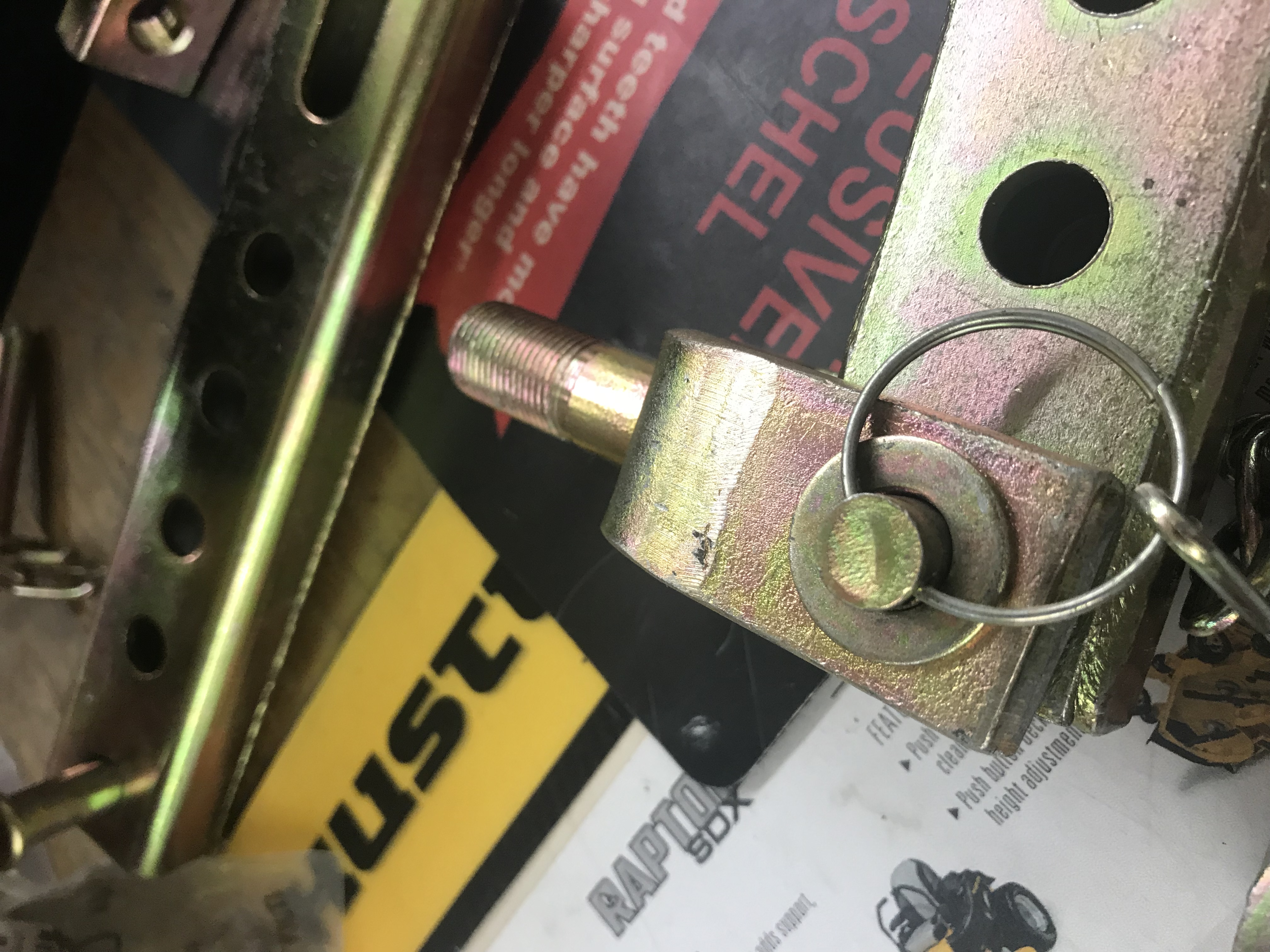

Yes. .. I mentioned several times I had tightened the Jam nuts. Which is why I am at a loss as to how one of them could turn lose at all. And it also then came off as well.
Clearly it did come loose and did then turn its way off.
In fact I had to loosen those to even adjust the turnbuckles. There was then a discussion from someone about even locktighing those but the need for being able to loosen them in the future came up. Then I asked if anyone thought there might be an advantage to doubling them up. One on each side. But no ones ventured a opinion on that.
They are M14 with 2.0 pitch by the way.
Here is my venture- if both eye bolts are secured and you tighten the jamb nut on one end of the tube it is locked in place. Need one end to come loose or turn buckle will not turn if tight on the jamb nut.

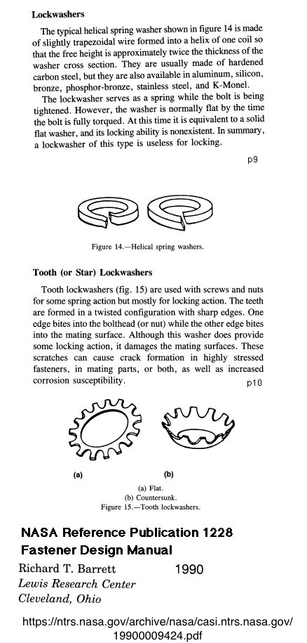

I was thinking about a spring washer (lock washer)... between the jam nut and the turnbuckle. Can watch those compress. Have to replace them from time to time but at least you can see it compress.
   / What are these and where are they supposed to be? #55

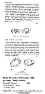

The common lock washer doesn't lock very well.
From:
https://ntrs.nasa.gov/archive/nasa/casi.ntrs.nasa.gov/19900009424.pdf
Bruce

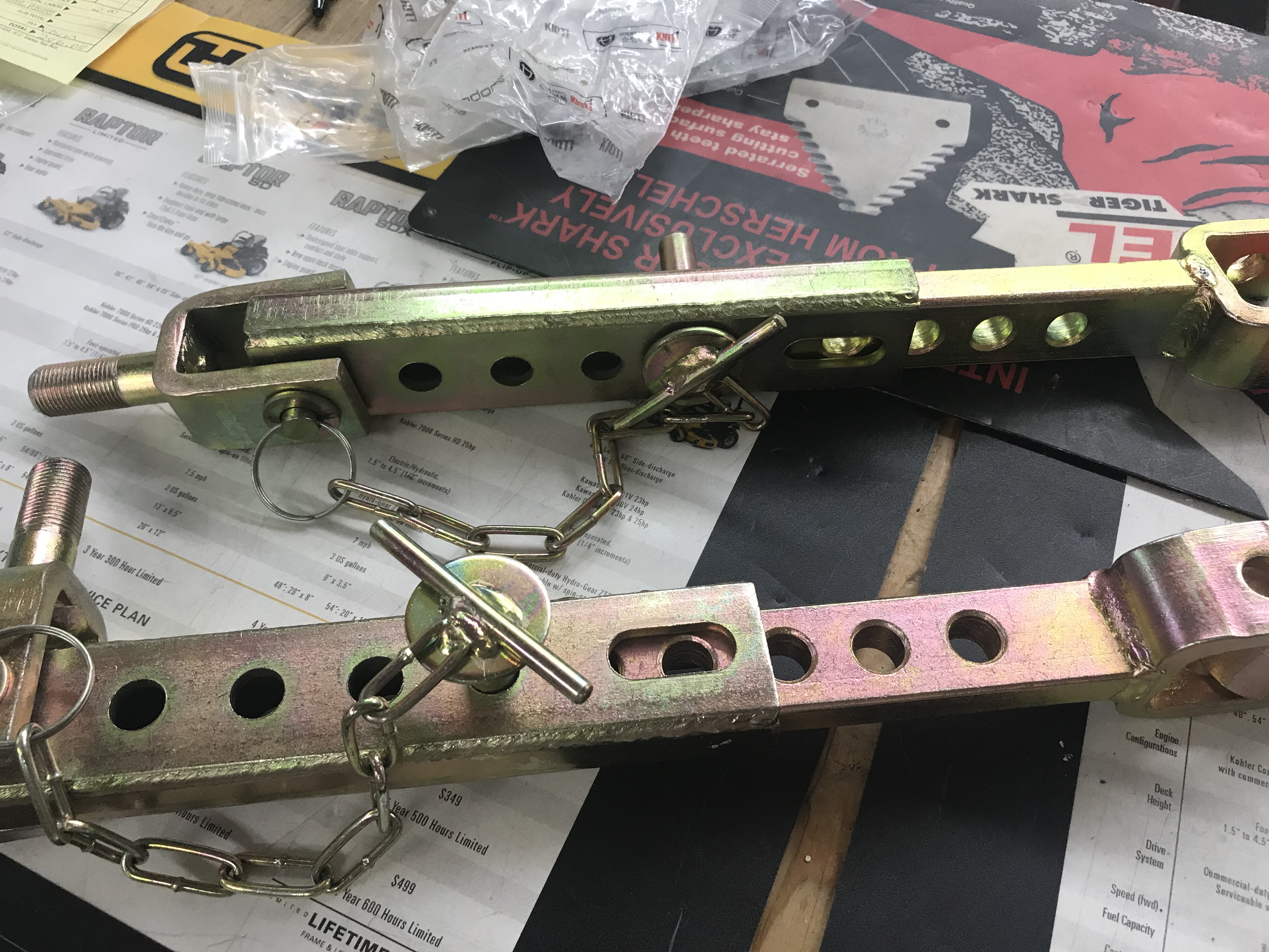

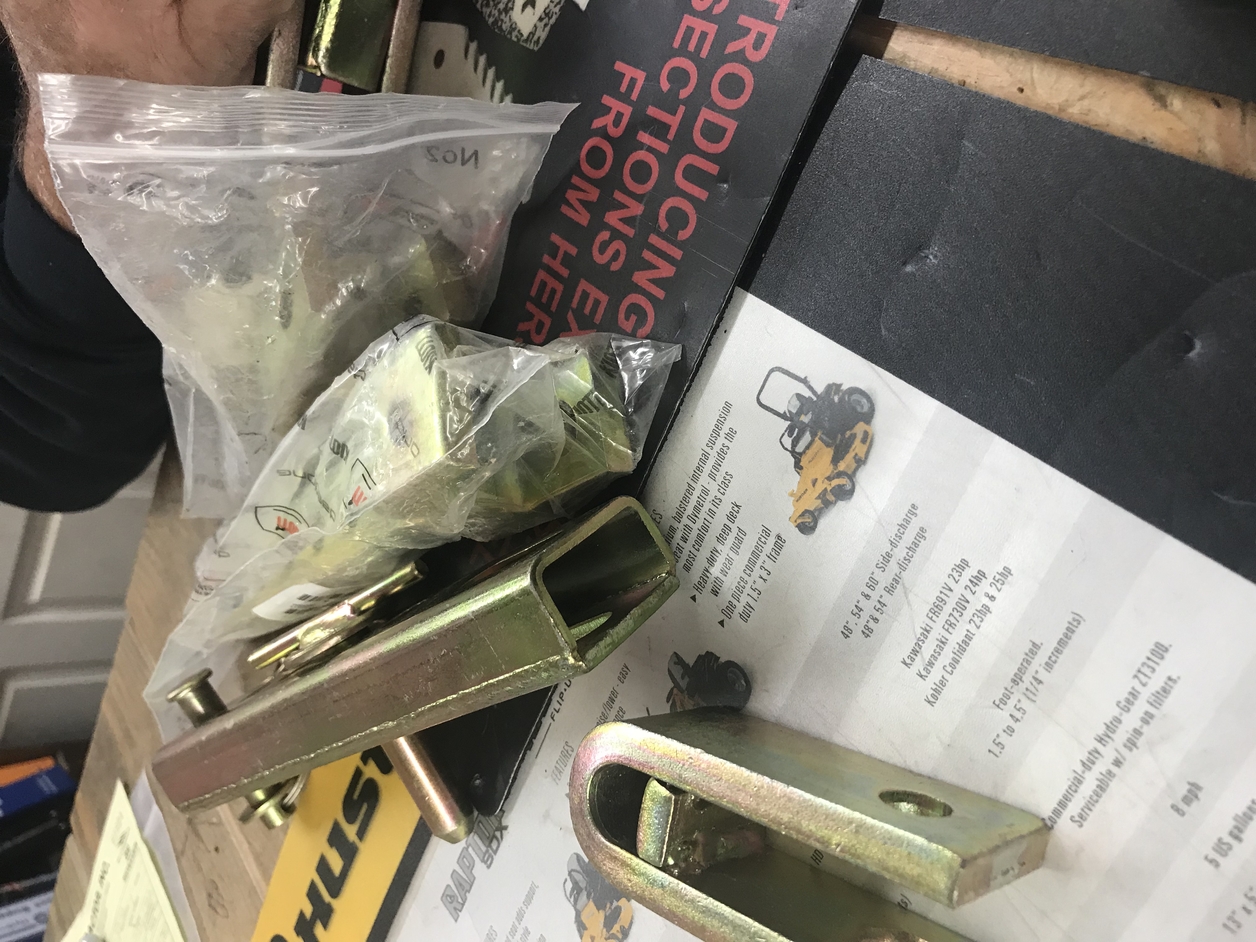

Now... Ladies and Gentlemen I think I am close to solving this equation.
The Dealer spent and hour or so this morning with me and we came up with these. I think they are CK35 parts. But they appear to be long enough to work. the only thing I have found is that the hole in the lift arm of my 2610 is about 2mm too small for the posts on these. And I lack those two nuts. I estimate those to be about 22mm and a fine thread. Ill have to source those before I go drilling so I can mock everything up. But it appears a bolt on solution. The Brackets themselves are an old source that was used before they decided to weld brackets on the arm. He happened to have them. Not free but he sources all the pins and washers and stuff except for the nuts. Didn't have those. Gave it all to me for $150 and if I cannot source the nuts and if I don't get to it by then, he is going to fit it all when we do the 50 hour.
Sounds like a solution!!!! Those are built the same way I built the ones for my JD2210.
