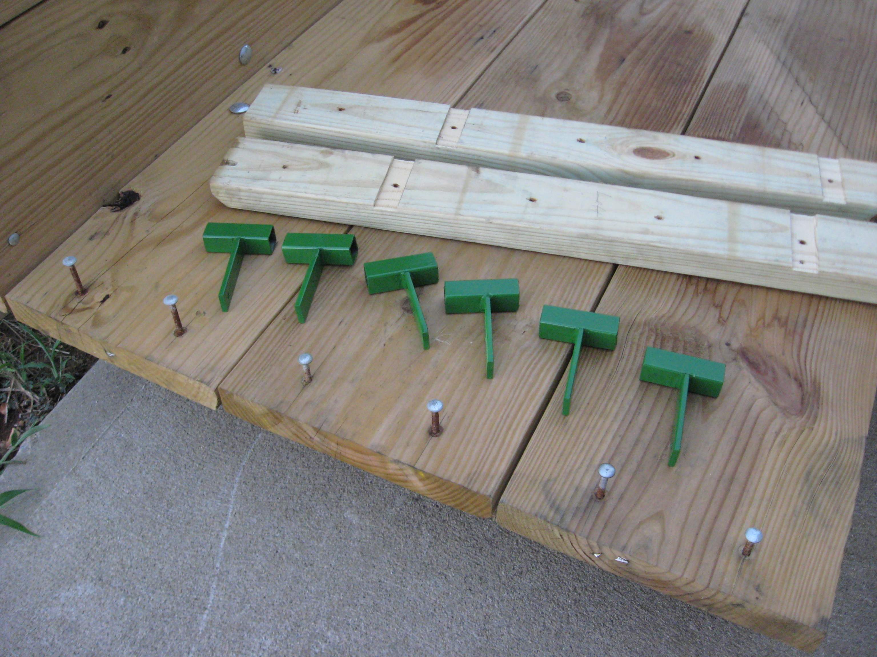

Oh, and here's what the "stake pockets" looked like before they were mounted.

RUNNER >>> Thankyou much for the info. I've got the wood mounted onto the frame ....after paint. Looks like I'll use the traditional stake pockets and corner braces. I've got some 2 to 3 ft wide 5/4 rough cut boards that Dad had collected & perhaps I'll use some of that for the sides and back.
Thanks again.

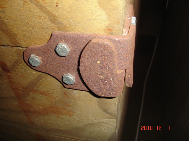

............I picked up some interlocking corners for my little trailer's sides from them. Couln't find them anywhere else.
McMaster Carr has the interlocking corners, as well.
   / What are these brackets called ? #16
Thanks, beenthere! My daughter, who works for a fluid dynamics R&D company, is always telling me the same.... "McMaster-Carr!"
I'm thinking I should move them to the top of the list for all my "bits & pieces" searches! Most of he people I described those corner pieces to had no idea what I was talking about.
   / What are these brackets called ? #18
Yeah, SARG, those look just like the ones I got. I thought they were pricey, too, but also thick- they won't wear out anytime soon!
Seems like I paid over $5 apiece for them, back in May of 2008. The surface rust doesn't seem to bother them at all.
That rear "gate" on my trailer lifts right out yet fits very snugly- thanks to those brackets. (Other panels- sides & front- are bolted in at the base of the posts.)
