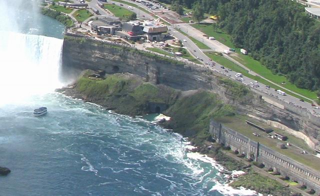

By golly, I think I have a picture of the tailrace portal. I would not have known where to look if you had not posted. It's in the center of this photo at water level.

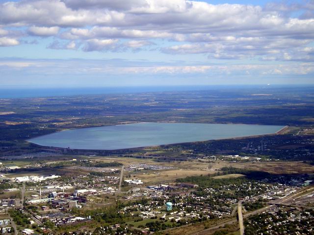

BTW: I can't tell you how I ended up with so many pictures, but I just hung my camera out the window of the helicopter and snapped everything in siight. I got a lot of stuff that just looked interesting. The reservoir in the second picture is an example. I just saw it and snapped a shutter on it.
