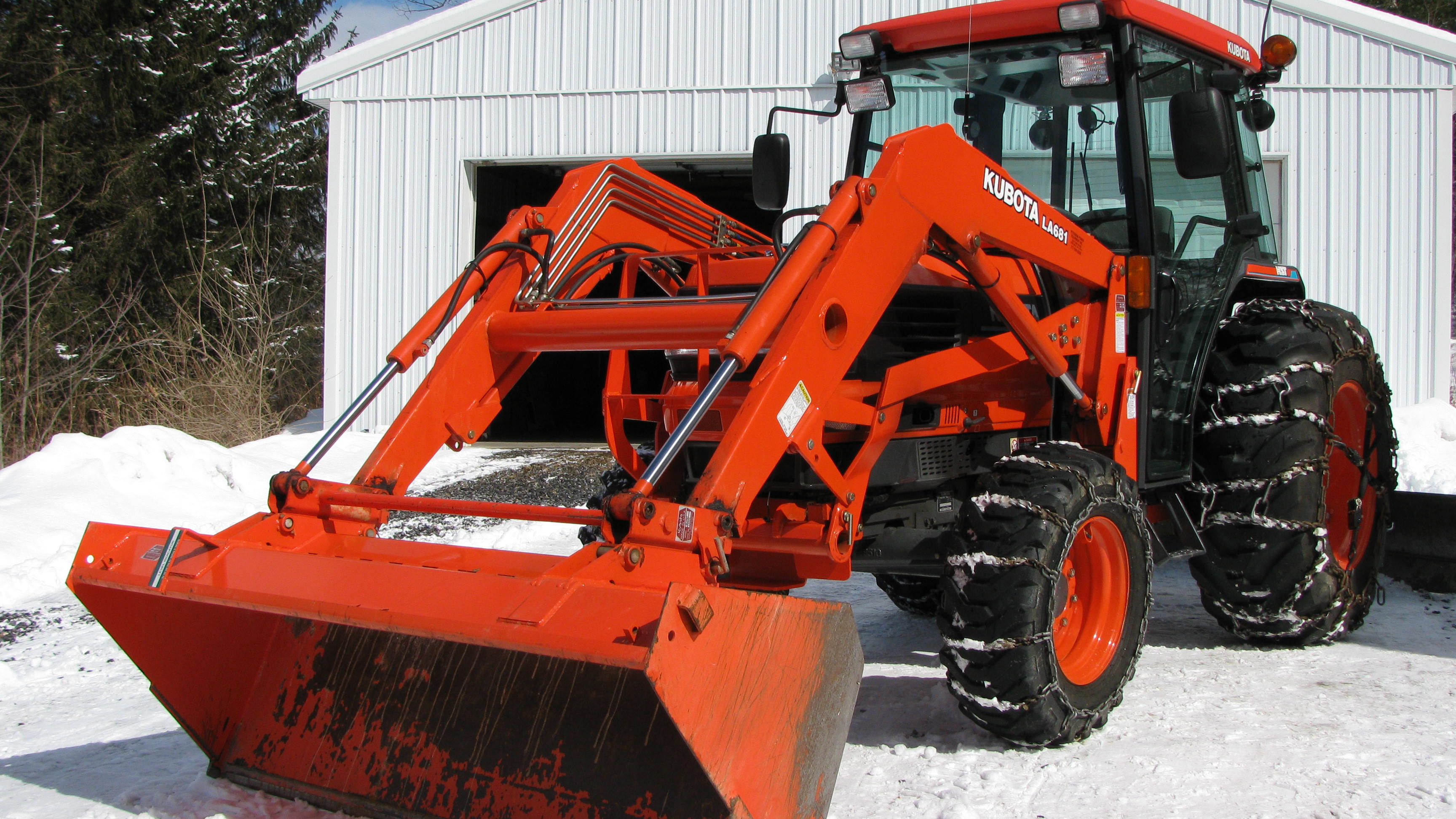

Loader What are these on my FEL bucket?
   / What are these on my FEL bucket? #11
They are for factory parking stands, the stands store on the loader under the tractor and are held in place by a spring clip.

Forgive my ignorance I still don’t understand how they are used on the bucket. I get the part where the stands dock on the loader arms when not in use but I can’t visually see in my head how the stands attach to the bucket that is not making sense.
   / What are these on my FEL bucket? #13
Like others I think the bucket modifications are not OEM. Have seen bucket mods for grade work, grave diggers attach cutting wheel to cut and remove sod prior to digging the grave. I attach all kinds of stuff with receiver hitches on my buckets.
   / What are these on my FEL bucket? #15
IMG_0071.JPGI had the same pockets on my LA 681 loader bucket on my Grand L 4310 that I used to own OEM from the factory.

In the event you want to purchase the stands:

Yes that link helped I could see tha picture posted showing the bar in the pocket and that going to the ground. Thanks everyone mystery solved.
I was wrong and the bucket brackets are OEM for parking the FEL as shown. Had Kubota FELs that came off that had a center stand or arm stands. Learn something new everyday. Thanks for sharing.
