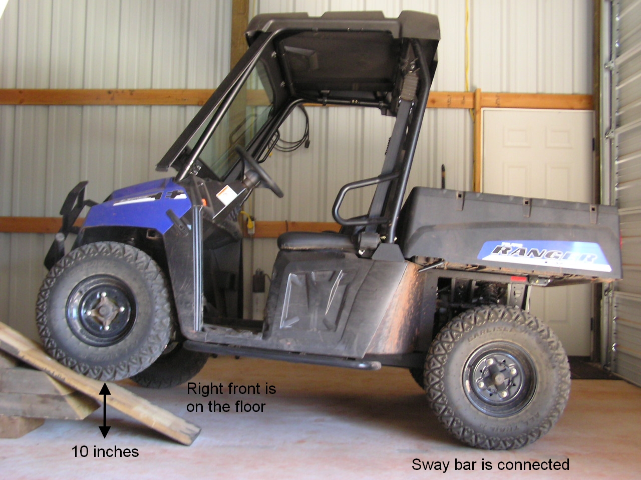

It depends on your definition of "better". It will be different. :)
The sway bar is designed to limit body lean when going fast and turning. The disadvantage is it limits suspension travel.
<img src="http://www.tractorbynet.com/forums/attachment.php?attachmentid=338398"/>
Since my main UTV use is off road, I disconnected the sway bar on my Ranger Electric.
<img src="http://www.tractorbynet.com/forums/attachment.php?attachmentid=338397"/>
Just rotated it all the way out of the way and put the rubber bushings back in place.
Don't know if it would be that easy on yours.
It doesn't limit suspension travel. It limits suspension articulation.

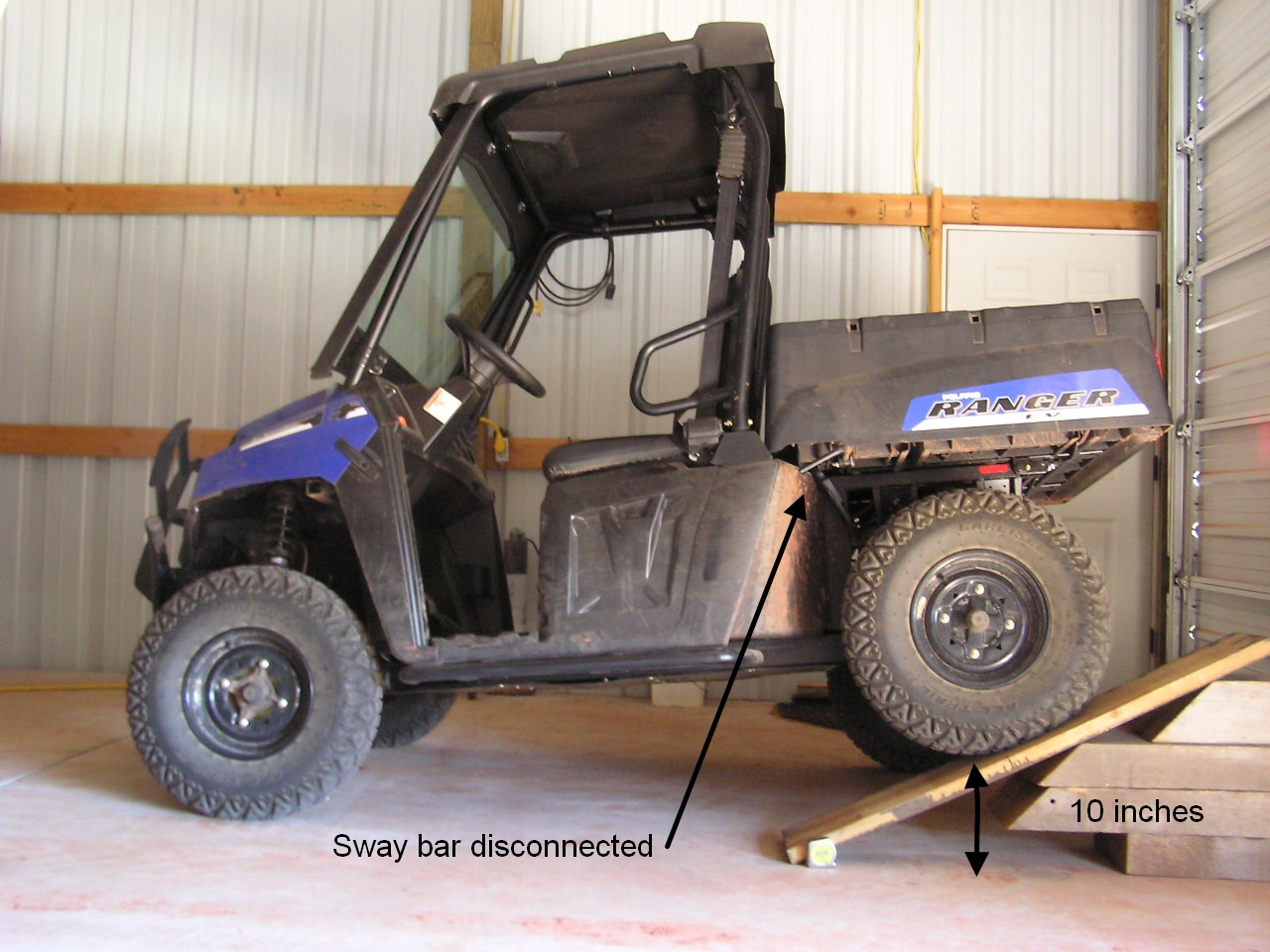

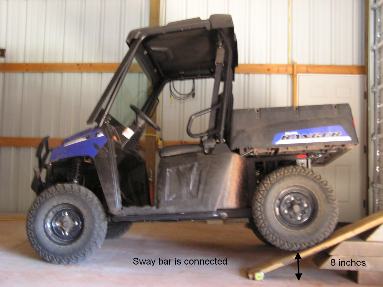

Thought I would check the "suspension articulation". :D
I had to shift out of 4WD, because it tried to go up over the end of the board!
I am going to leave the sway bar disconnected. :thumbsup:

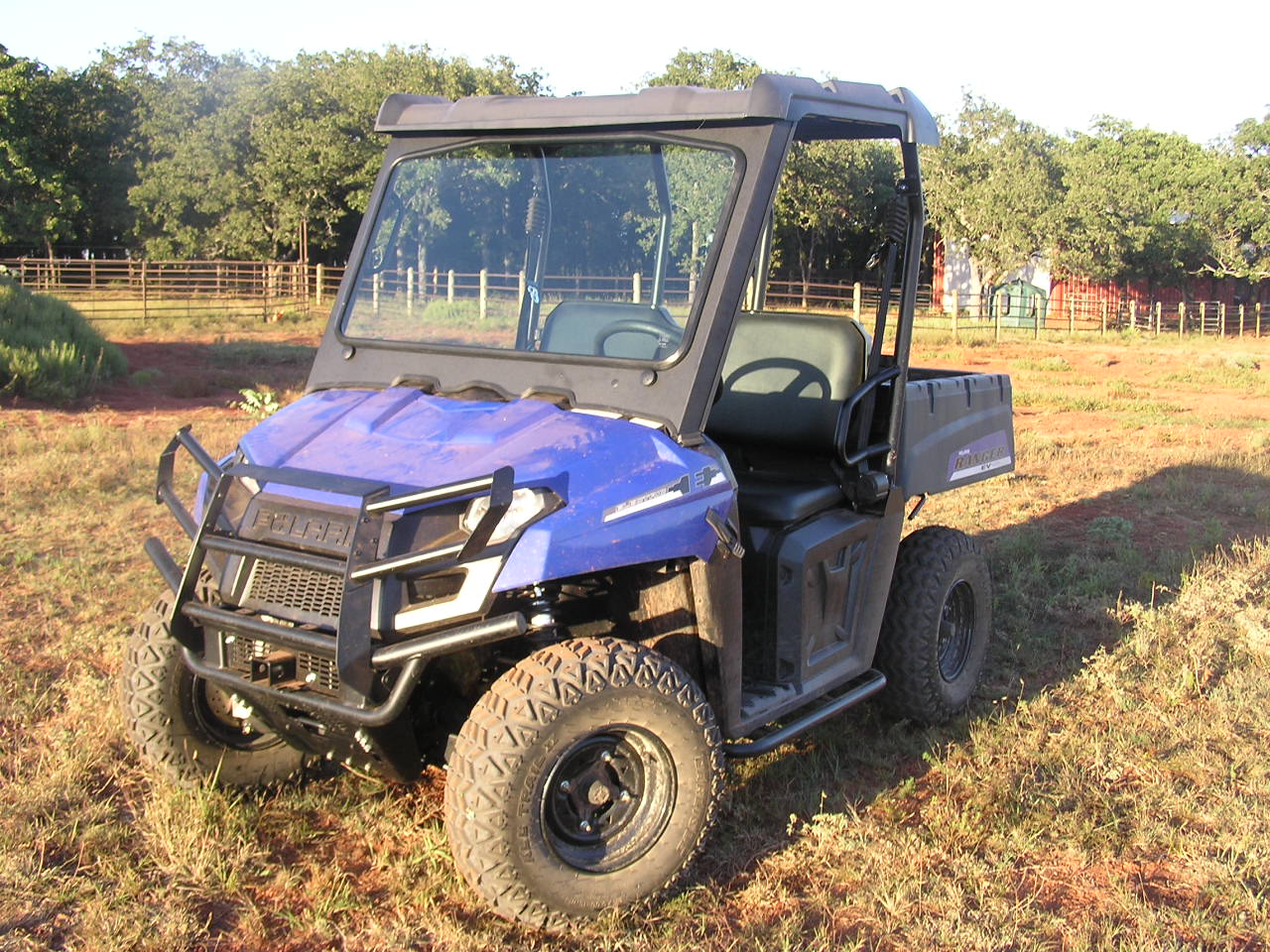

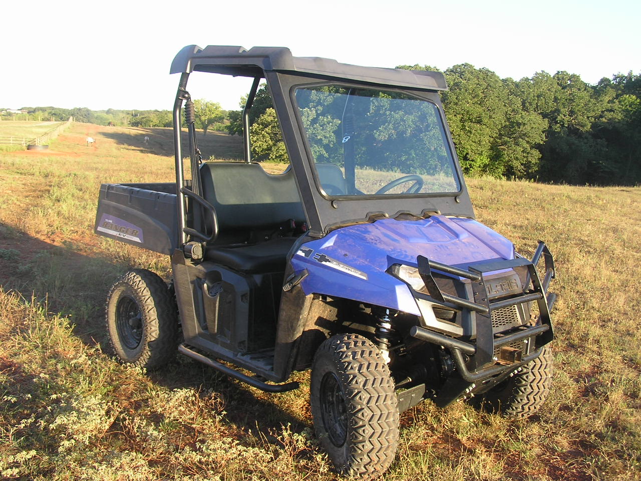

It is fantastic! :D Is was hard to get used to no engine noise, after having a diesel. During the test drive at the dealer's, I had to stop and back up to turn around, I put it in reverse and reached for the key to start it, because there was no engine noise! :laughing:
This one has a very quiet 30 hp AC motor, with amazing torque.

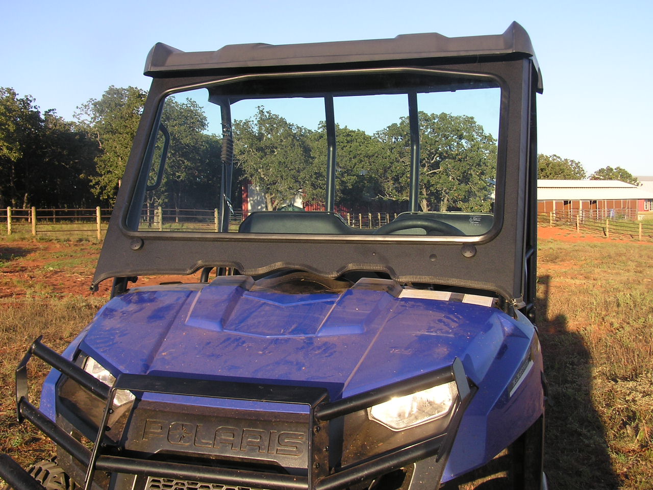

Got the glass windshield installed, but had to remove the center mounting clamp for the roof. It is designed for the metal roof, not the hard plastic roof that they sold us.
The bottom opens out for air flow.

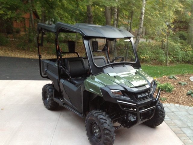

Just a quick pic of my new Honda Pioneer 700-4.....in order to get a new HONDA posted here. This is a new model....and it seats 2,3 or 4 riders in a short wheelbase. Look it up on Honda's site. Pretty slick machine IMO. I added a full roof and a glass windshield....so far. Just drove it a little tonight. Maybe more in the next few days.

Are those the stock tires? They look a lot nicer than what my 09 BR came with. I ended up replacing the tires.

Yep, the tires are stock. The only things shown that are options are my roof and windshield......so far.

Wow I really like that! Very nice!
Can u confirm if it has a locking rear diff?

That's a slick windshield!
