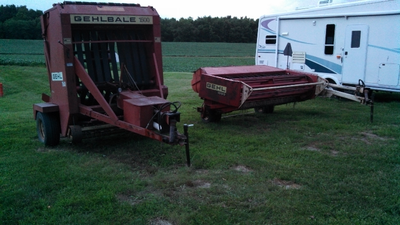

My uncle bought a Vermeer like the one in the picture. The guy told him he had been baling with it for the last 10 years & never had a problem. He took it home & had to work on it every bale. It kept clogging up & the belts/chains coming off or chains breaking. He spent about $500 on parts & it took about 30 minutes of working on it in the field for every bale it made. He finally sold it for scrap iron & bought a newer one. Lok it over good if you're serious & maybe even have him roll a few to see how it works if at all possible. Someone said that it was top of the line in its day but that day may have already come & gone.
Plus1
   / what baler would you take??
#22
Well I made the trade wish me luck! I had a hard time deciding what baler to take till I had them run them both! The Vermeer wouldn't work and ended up breaking the drive line the gehl on the other hand worked great! So I now have a gehl baler and mower. Just need to get a hay rake.
