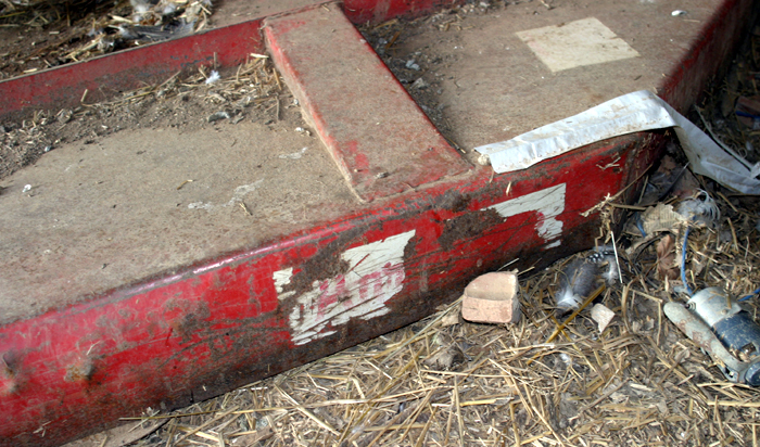

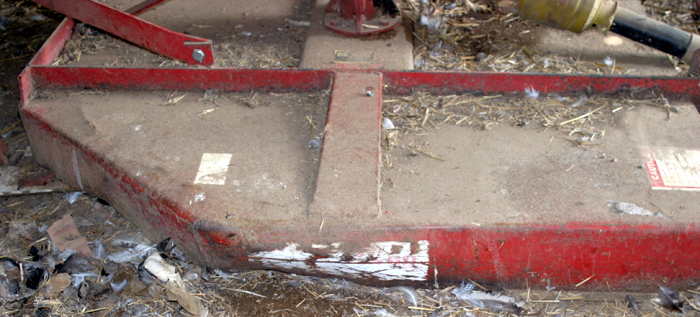

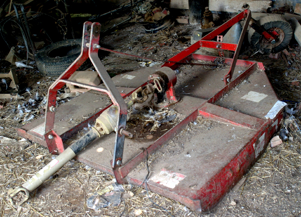

Can anyone tell what brand of Bush Hog this is and is it worth $400?
It is a 5ft hog and the owner says it works perfectly.

What are the letters you can make out on the white side decal. That may help? What do you need for it? Ken Sweet

Mr.Sweet trying to help poster like you.To me first three letters in center pic look like "har",like in Hardee.Hardee sells/makes red bush hogs,built in Loris,SC.I don't know mdl#,years,etc.Just trying to help.:)

I can make out just what you can which is why I thought maybe someone would recognize the logo.
What do I need for it? Don't understand what you mean, but I need for it to work to be able to hog 7-8 acres.

I thought you needed to know the Mfgr. so you could get some part you needed to get it going. We have a lot of parts that will work on that cutter, no matter the brand. Ken Sweet

It looks sturdy enough from the pics. Is the gearbox leaking oil? Why is there a strip of white tape on the corner of the deck? Is the wheel assembly/forks straight or bent (I mean bent, not "built to sit at an angle") Also, this looks like a shear pin unit. If you are doing mostly grass and light brush, this is probably OK; if you are hoggin down heavier brush, small trees and/or working on land with lots of hidden obstacles (rocks, pieces of iron, etc.) you might want to hold out for a unit with a slip clutch (or be prepared to retrofit), otherwise you'll be off and on the tractor to replace pins.
