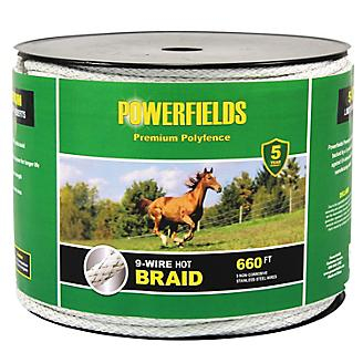

Tried the fence tape and it didn't last. Interested in the poly wire. Any brand suggestions would be appreciated.
   / What Brand Electric Fence Wire For Horses #2
I have had very good success with POWERFIELDS 9 wire 7MM hot braid 660 ft spools like from Stateline tack or Amazon. Have to watch for best prices maybe @ $90 a spool each delivery included.
