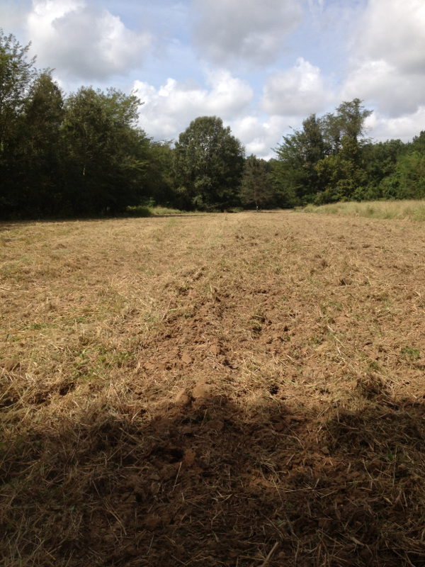

For food plots I really don't see the need for a tiller. I have been planting food plots for 20+ years. I have planted hundreds of acres over the years and a good heavy disc harrow is all I have ever needed. I just mow ahead of time, wait for a decent rain to soften up the ground, and disc away. I use a Monroe-Tufline 6.5' disc that weights 830 pounds. The deer really don't care how smooth the field is.
Here is a picture of a recent field I did this month.
I have heard others say the same thing. I have done only a few small food plots, and I did them with the disc harrow. I have a 20 disc version that I think weighs something like 700 pounds. I have other uses for a tiller, although the food plots were on my mind because we are having the areas cleared this week.
What would you recommend for deer? Our gun season where I am starts November 12th and runs through January 2d. I am thinking of some milo and sunflowers for doves.
