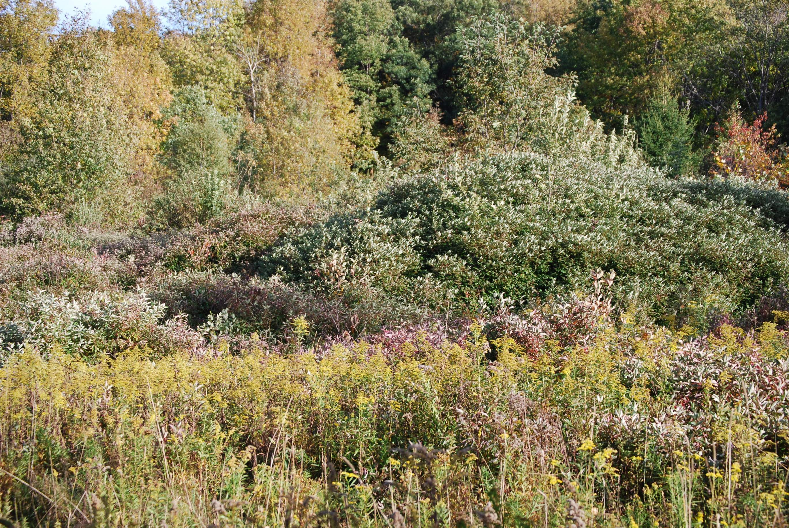

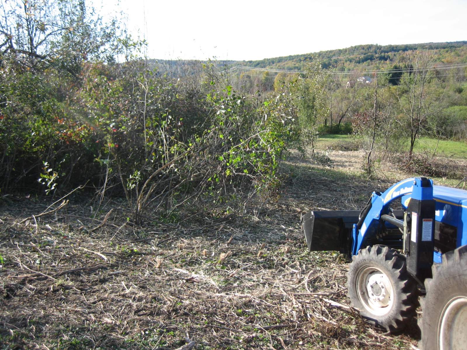

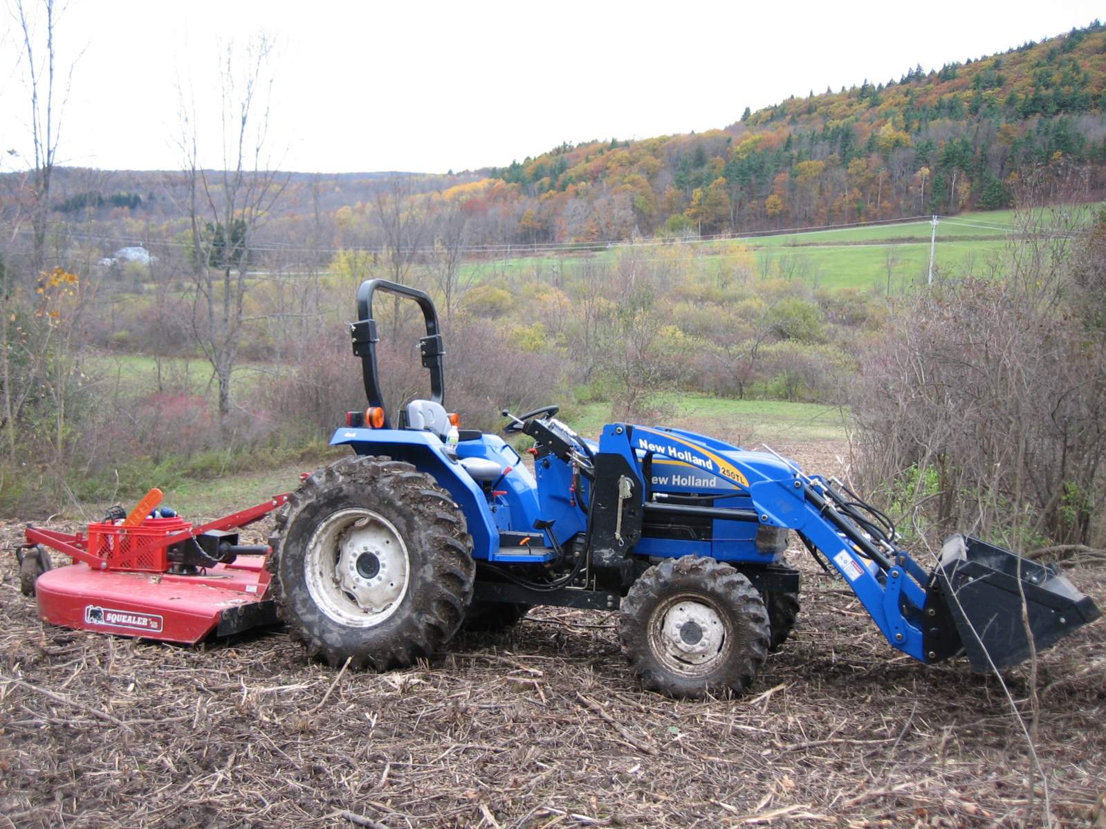

I think it really depends on your brush hog and the condition it's in. From your comments it does not seem as if your saplings are that big. I purchased my property an knew opening up overgrown fields were going to be my biggest project. I had no experience and no equipment, I decided to buy a new 45hp tractor NH T1530, a FEL and 6'ft bucket and an new bushhog SQ172 (6ft). I decided not to cut over 3 inches although the mower was rated that high as a medium- heavy duty. I am sure I did though from time to time hit 3" and definitely hit multiple clumps of 2 inch plus. I work with an oversized milk crate on the mower which hold the stihl 16 inch saw, 1 gal of fuel, chain oil 5 gallon bucket with tools, etc.
I "had" one field that was at least 20 years overgrown which really pussed the definition of a field. I received multiple quotes for clearing it and mostly were dozer, which was not a choice for me since I wanted to preserve the 200year old soil. This was also a hillside project.
The plan was to mow always moving forward and down hill. I was able to cut a slot in the mix of trees, saplings, briar and scub brush. With a slot cut I could walk with the saw and cut then pull out larger trees and then mow through. I did make the decision to buy a grapple for the FEL so I could move the brush piles I was creating. I learned quickly to cut with the bucket attached not the grapple. I did not want the saplings to pull out they would only get caught under the tractor and some push up into the heavily shielded fan. I can not believe what I was able to do and I am 80 percent done.
In closing lower the bucket, move forward and move slow. Also post a google link of your parcel with this google pinpoint - tiny URL site. Here is mine, just click and select satellite view. The right edge is a weekend spring project. Google Maps To Send a Position
But I think a picture or 2 would show it better.
