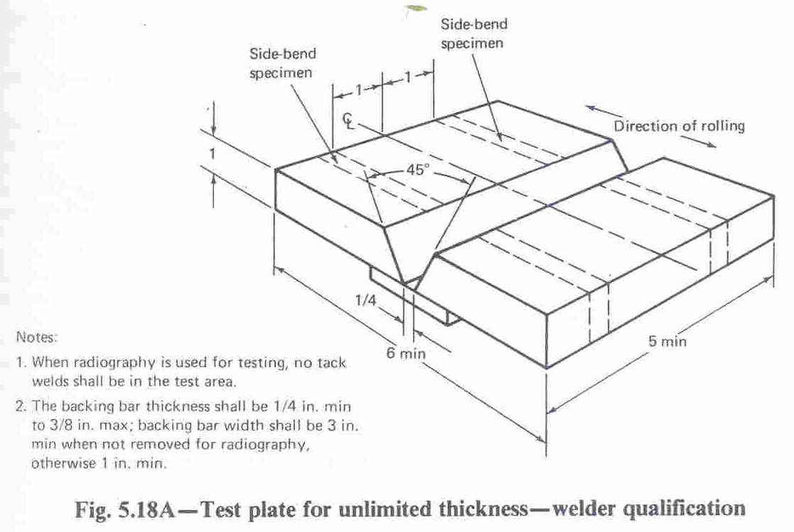

Can you not run multiple passes with a wire feed welder as is done with a stick welder? If not, why?
In the 1970's for 3-years I worked in a NRC controlled shop. Every 3-months we had to stop production and head to the test booth. We had to re-qualify in every process we had certs in. All AWS unlimited V-butt plates and pipe tests for those of us who had pipe certs. The strange part is with each plate and position we had to run .030, .035, .045 and 1/16-inch wire, so we were qualified in each wire size too. Guess how many passes it will take to fill one of these plates up?

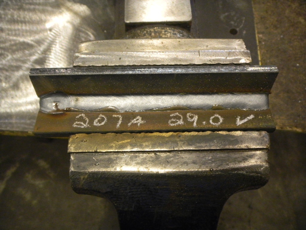

Personally on the whole I think 120-volt Mig machines should be outlawed! Mig machines are just to darn easy to pickup and run a good looking bead. But that means nothing!
If your Mig welds don't look something like this, back to the drawing board.;)

BINGO!:thumbsup:
Uuuummm, weeellll, they don't exactly look like that....:laughing:

BINGO!:thumbsup:
SA;
That was done in spray transfer mode? With a 250+ amp machine...
I know that every weld in a perfect world given unlimited money,resources, skill should be X-Ray quality but I personally don't believe that it needs to be so!
Having said that you have been rubbing off on me with your saying (paraphrased)"most mig welds look good but are too cold"
I have been turning up the heat more as of late.
