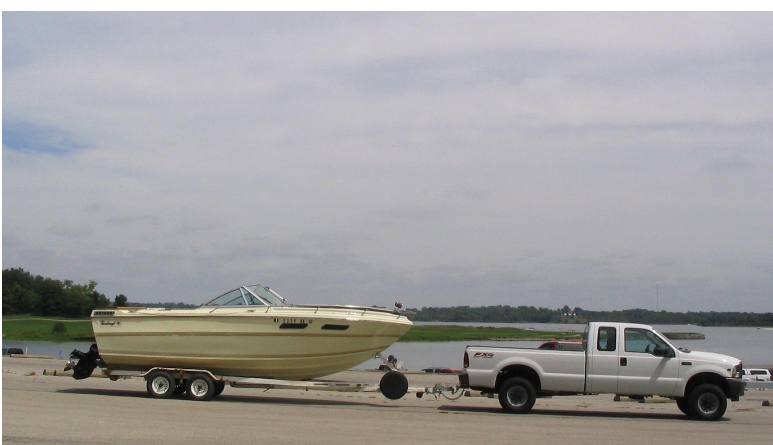

Boat trailers are especially bad about fishtailing because the majority of a boat's weight is in the rear.
On the plus side, at least on my two boat trailers, the suspension can be relatively easily moved fore/aft to help adjust the weight distribution...
I have only had 1 boat trailer of the 10 or more that I have owned that the axles were movable. Moving the boat forward as little as 4" can make all the difference in the world. This is accomplished by moving the bow stop forward or aft to get the desired balance.
As for swaying its as others stated and loaded to tail heavy. Also, short wheel based tow vehicles are much worse than a longer based one.
