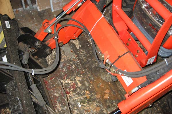

I use a rear remote. From there I have quick couplers and hoses going to the left side underneath the seat and above the rear axle, inside the tool kit area and then come up to the left FEL attachment post (same place as the stock FEL connections on the right side). There are quick couplers there as well and the next hose goes along the left FEL arm to the cross piece where I have (at the moment) a rather inelegant zip tied fitting. The hoses from the grapple also have quick couplers and those come back to the cross piece. I currently have zip tied them when I hook up the grapple to control the extra length so it doesn't get caught on anything but I will eventually come up with a welded mount on the cross piece to keep things tidy and out of harms way. I'll post a couple of photos. It is not yet permanently installed, especially I haven't yet built any brackets similar to the Kioti brackets for the FEL quick connects on the right side but that is my over all plan (anyone know where to buy those?). Right now the hoses on the left FEL attachment post are zip tied to a mending plate that I bent in half and slipped into the post receptacle.

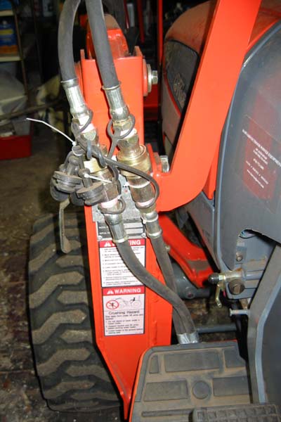

Here is another photo of the temporary front cross piece hydraulic hook up. I'd like to find a fitting like Kioti uses on the right side FEL post to more cleanly and safely mount the quick couplers. Should be able to weld such a fitting on to the front cross piece without too much trouble.

I saw the Tach-All fitting but it also is the male version and what I need is the female version that would put the receiver plate on to the Kioti bucket without welding. From what I see with the Tach-All it is similar to the adapter I already have that goes on to the pins of the the Kioti FEL arms and provides the male QA part. ATI sells the weldable adapter plate which a lot of other companies also sell but I haven't found one that has the pin ears to allow a non welding hook up to the original non QA bucket.
