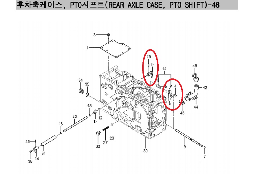

I was doing some light shredding with a 48" shredder behind my 2006 3510i
I was in 1000 RPM selection, and running 1300 rpm in 2nd range, 1st gear.
I hit a tree stump in the weeds, and killed the tractor.
I started it back up, but lost BOTH the raise & lower function of the 3-pt... and lost 1000 RPM (the lever won't go down)
I still have 540 PTO, though - - But the lever will NOT slide down into 1000..... and the 3 pt won't go up or down??
I still have full loader function and power steering.
Hyd fluid level is right on the upper line.
What's the first step of disassembly to find what broke?
I've never been inside the rear end of these.

Reads like you broke something inside. Time to break out the tools.
Drain the oil and see what metal comes out?

Well.... it feels like a bent shift fork inside. I've always been suspect of the design, because pulling the lever up always felt like it went into 540 "solidly" - but pushing down into 1000 felt like it "barely caught".... but I never paid much mind to it. Even now, if I push down really hard if feels like the teeth are trying to barely grind.
How do I access the PTO shift fork? Through the top, or through the back? Or.....?
   / What did I BREAK?!?
Oh, everything after the PTO is fine. "No PTO" and "540" both are easy to find, which makes me think there's a "separation of the shift linkages" inside for 540 and 1000, just like an old transfer case is set up like.
I really would like to see a decent exploded diagram of how this all works together.
