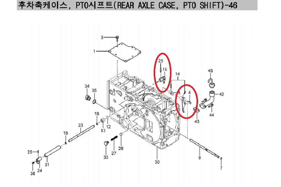

Best I can tell, I possibly need either a new shift fork (#4)
or a new #16,
which rotates on the shaft to slide the fork "fore-and aft"
   / What did I BREAK?!? #12
or a new #16,
Have you tried to adjust the turn buckle above the "L" that attaches to #24,
or even taking the lever loose there and try rotating #24 by hand to see if it engages?
To physically see #4 or #16 it looks to me that the top cover and 3 pt housing willneed to come off.
good luck, you pics look to be very close to the ones for the 3510I

#15
To physically see #4 or #16 it looks to me that the top cover and 3 pt housing will need to come off.
No, because when moving the lever you can FEEL that there is DEFINITELY something bent inside the transmission.
Yes, unfortunately - - It looks like the top will have to come off for sure, and also most likely the PTO rear cover as well.
The shear pin in the shredder never sheared, either (It's grade 2). What a disappointment.
