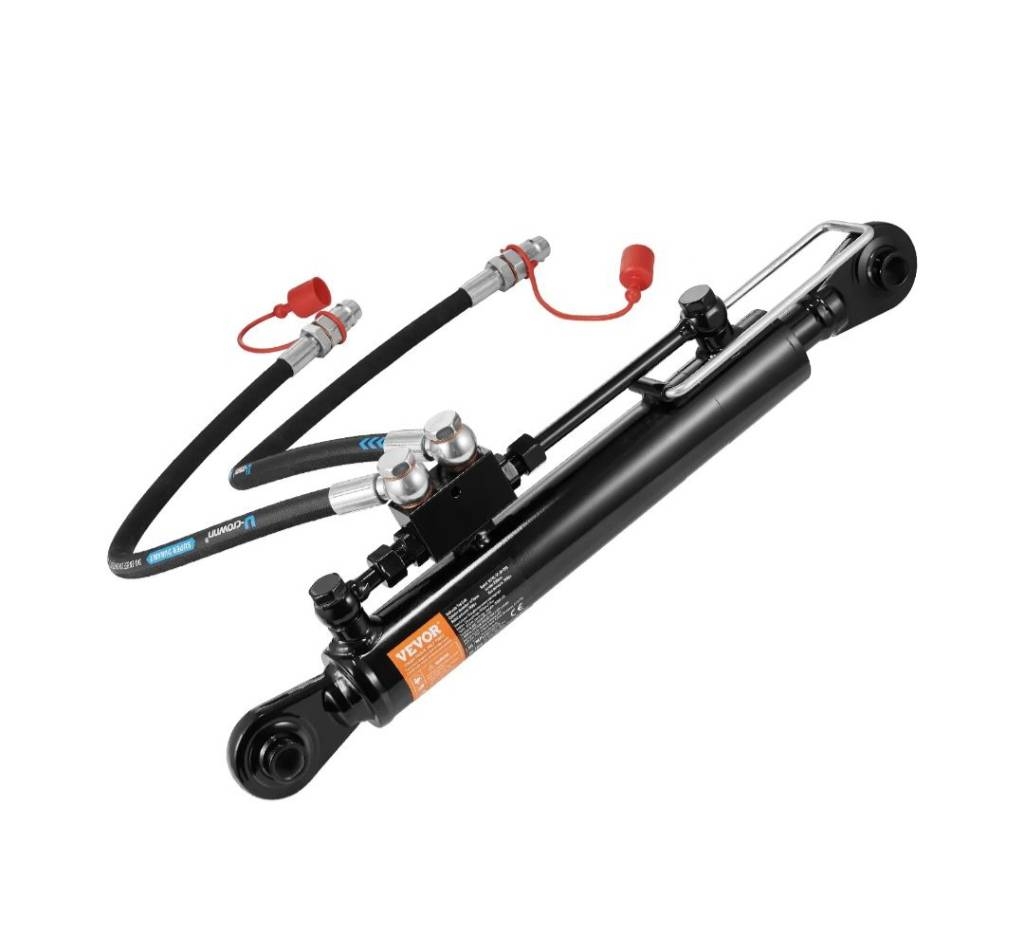

I got this today. Vevor top link. Mine the pipe got damaged and I got tired of fooling with it. I'll keep mine for a spare. I removed that safety catch on it and didn't use hoses or banjo hardware because my hoses connected to it fine. $142 from Walmart online.
