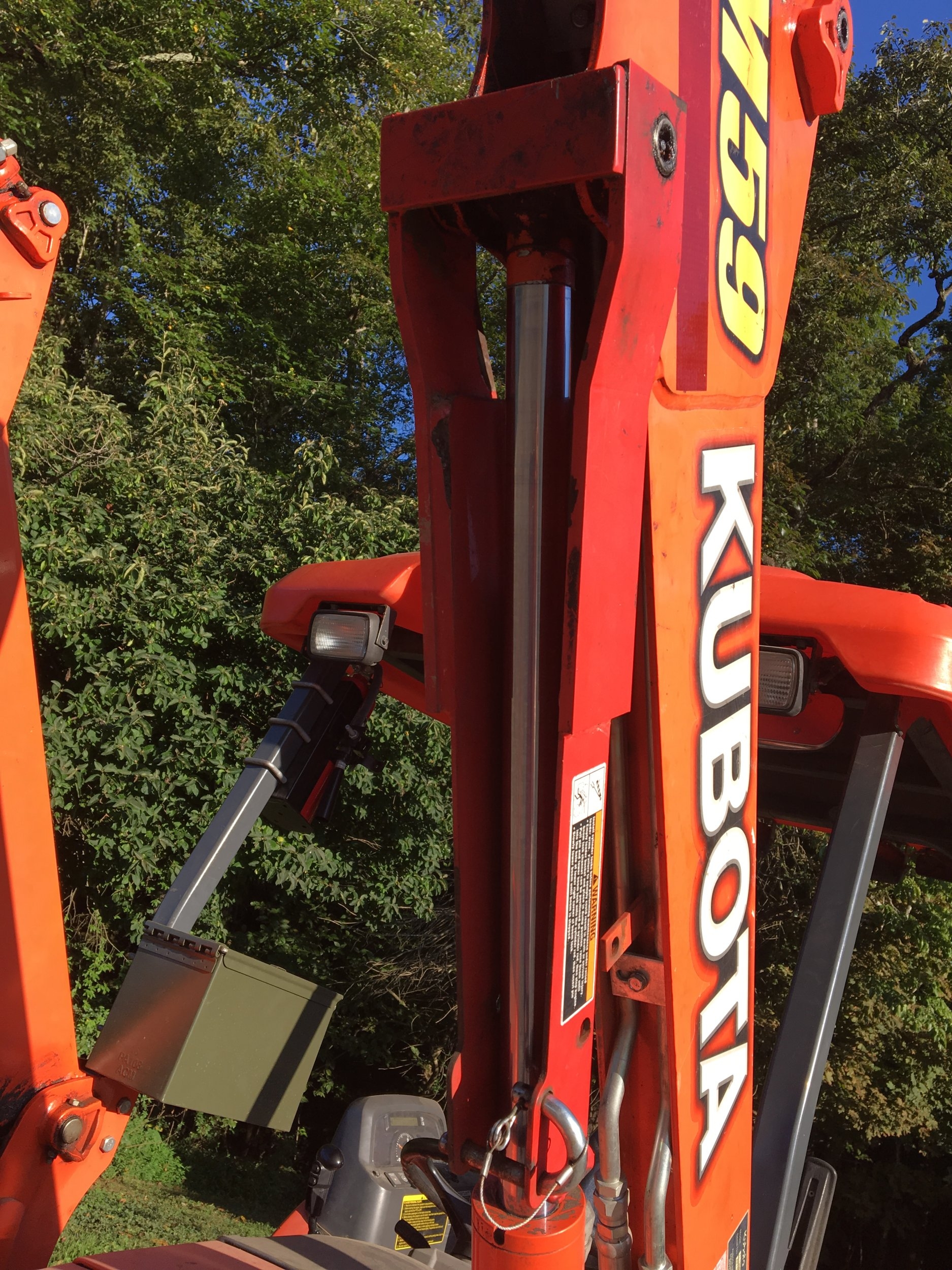

Applaud you gentlemen for making and using your loader cylinder chock blocks. They should come that way.
Having the cylinder rods up makes it easier.
M59 OEM loader lock gets used frequently. Stores onboard. One simple pin to lock.

Wouldn’t that be a good idea? Apparently it takes a few people being killed to think of a good idea. I personally know of two people that were killed by dump truck boxes. I don’t know if a safety was available, but my guess is…not.

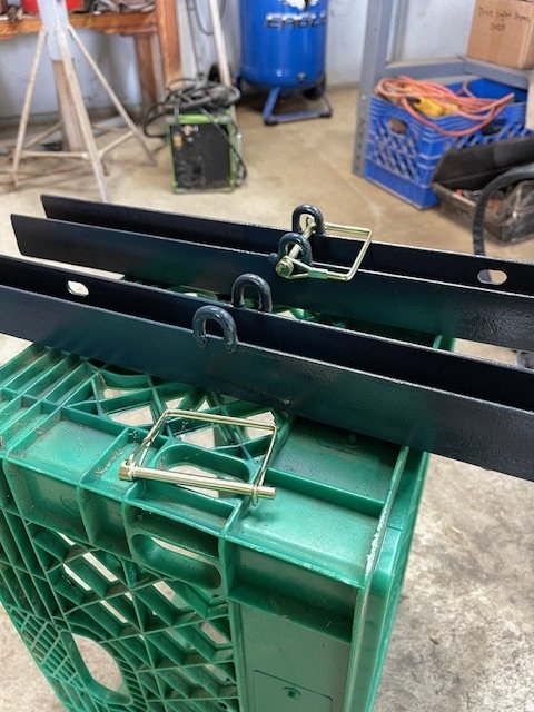

I improved the cylinder safety locks by adding a pin that prevents them from coming off inadvertently.
Not sure they ever would but I saw this on the ones available online and thought it a good idea.
I bought some clevis pins and cut a couple of chain links in half and tacked them on.

Nice improvement. Easy AND effective!

I like that chain link idea. Simple, quick. and neat. Something I will keep in mind.
