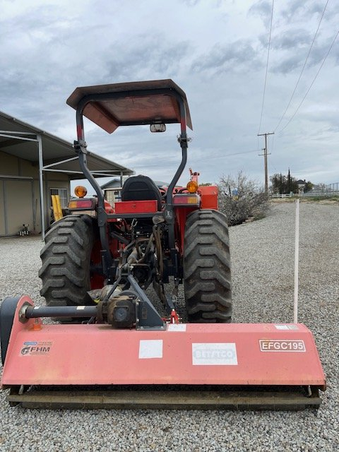

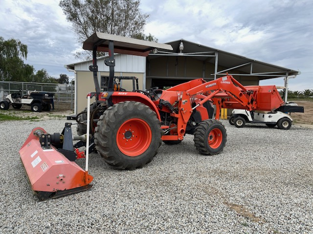

Yesterday I was using the offset flail mower. I noticed it's not easy seeing how close the mower is to the fence without leaning out of the seat and craning to look over the tire. Today I mounted a pvc pipe standing up on the leading edge to show where the end of the mower is. So far so good.
I have a mind to do that to mine along with a couple of sideways gauge wheels just in case the operator is an idiot lol
YES a wheel ! I kept thinking about a bar or a skid but you sir are genius . Thank you

I haven't put the bumper wheel on yet. I've been too busy mowing!
