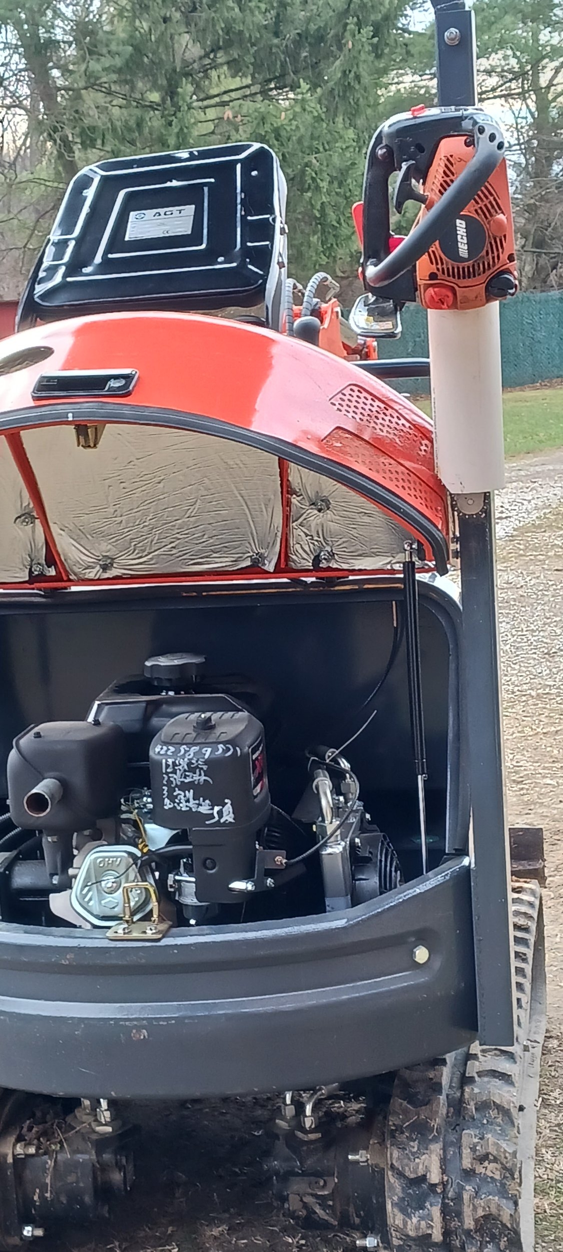

I expect the prices will continue falling. Some of the models have very limited access to the engine area. I looked at lots of pics until I saw the L12 and the rear hood that raises, and gives great access to the engine area. I think at the time I bought mine, it was the best model available under $7000. I gave $6500 delivered tax included. I would buy it again. I cant remember if the QH12 has a door that opens on rear? If it does then that may be a good option. AGT in Chicago has sale prices now that are hard to beat. Buying from some "dealers" will not include warranty.. I bought mine from a private seller with 0.2 hours on it, but AGT will not warranty it.
I have seen some models where people have a heck of a time just checking the oil. The large rear hatch on the L12 makes things easier on me.
