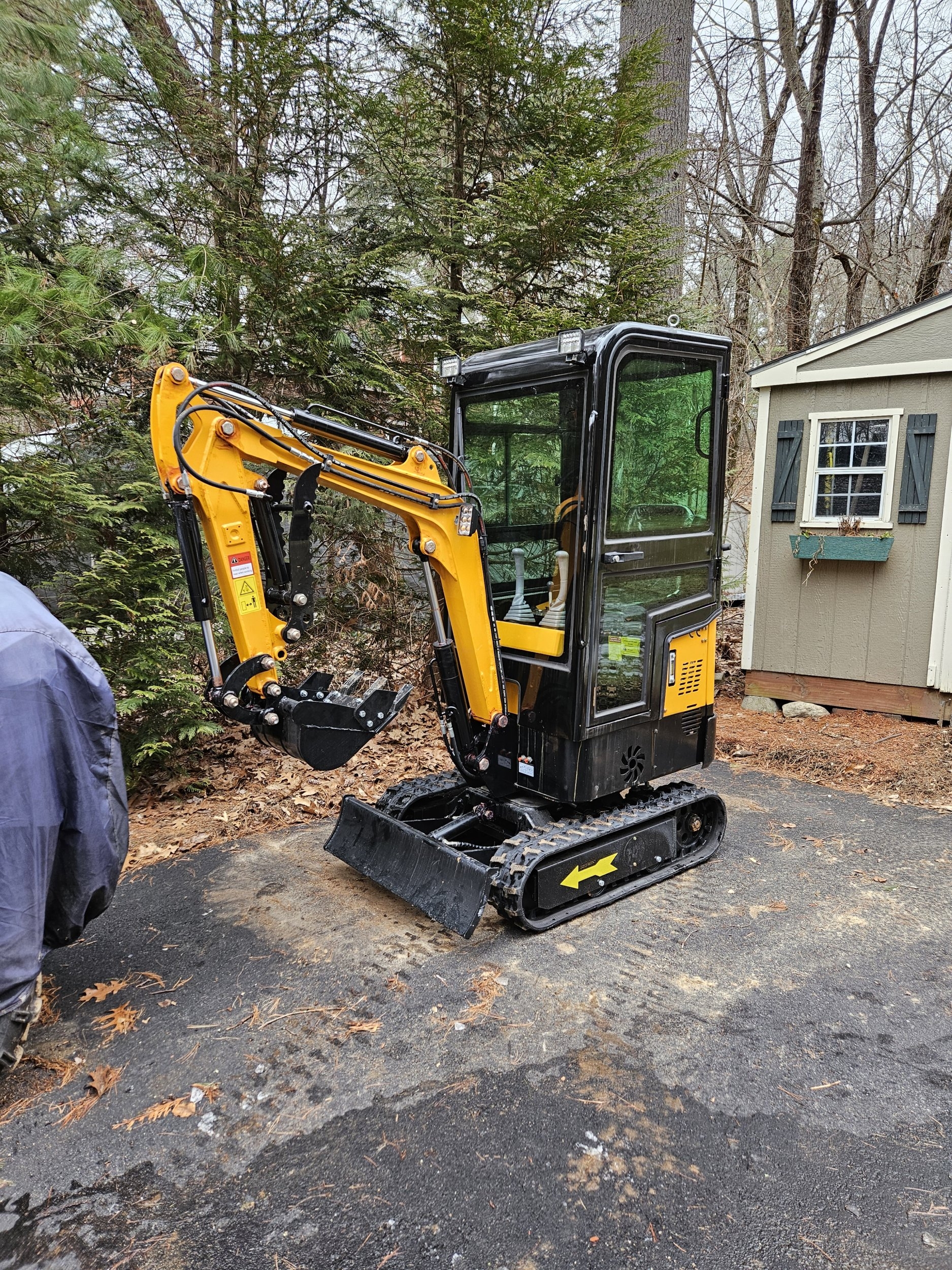

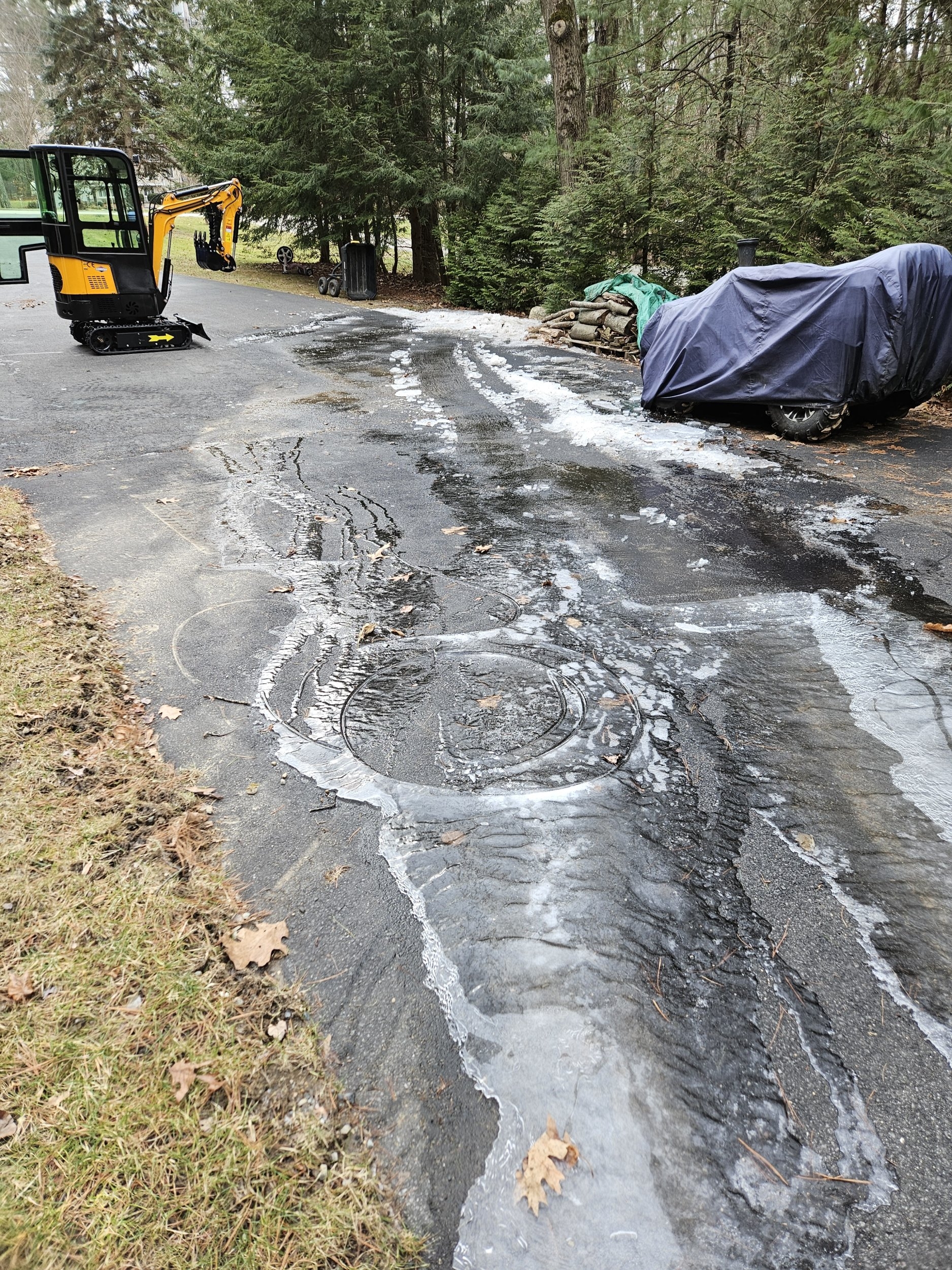

My first real use for my mini X since I got it. I used the front blade to break up ice on the driveway so I could clear it. In past years this has been an all day affair but with the mini it was only a little over an hour.

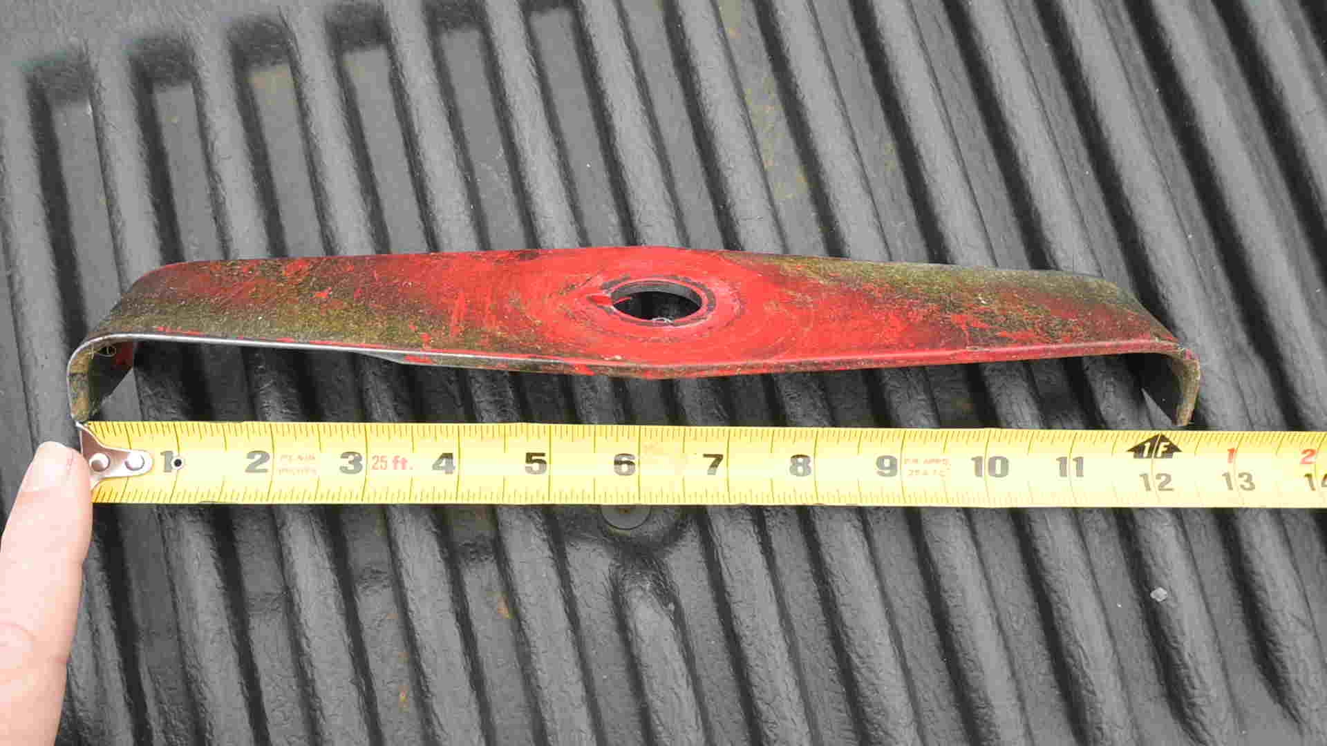

The weed wacker cutting attachment I have been using to not only cut but mulch honeysuckle and briars is this Oregon mulching brushcutter blade. https://www.amazon.com/Oregon-29550...sprefix=oregon+brush+cutt,aps,112&sr=8-3&th=1
The hedge trimmer will cut briars, but this 12 5/16" wide Oregon blade will actually mulch them into much smaller pieces. I have only used it on my gas unit because the blade is heavy and takes a bit to actually spin up. Once spinning, it doesn't tend to slow while mulching. The cutting wings will throw debris. It is very important to wear a face shield and other protective gear. In my experience, the cutting wings will throw hard woody material when it starts to get about the diameter of my finger. There's a point where I don't try to cut saplings--but it excels at briar cutting, IMO.
The Oregon has a 1" arbor, but comes with a 20mm adapter. I've wondered if it would be easier to try to adapt an electric weed wacker, an electric mower or if the mini X hydraulics would be enough to power a smaller cutter like the Oregon?

My first real use for my mini X since I got it. I used the front blade to break up ice on the driveway so I could clear it. In past years this has been an all day affair but with the mini it was only a little over an hour.View attachment 842772View attachment 842774
Very nice machine. I bet you are loving the cab. I wish I had gotten one, I was concerned that it may prevent me from accessing a few things easily. But now I really could use a warm dry cab. Its cold and snowy here today.

Does anyone recall the 120v push mowers that were around 30 years ago? Never used one but I bet they had enough power to do what I want. I can make a quick attach basket for my blade and sit a generator on it.. not a perfect setup but would really help me with trail maintenance.

Tried to look up the mounting hole size for the Ryobi mower blade. They don't make it so easy, but I found a Q & A that it is .882 which is different than the 1 inch hole on the Oregon brush blade and different than the 20mm adapter that comes with it to adapt it to a weed wacker head. I haven't flipped the Ryobi mower over yet to actually check to see if the brush blade could be adapted to it. I'm guessing the mower motor has more power than the electric weed wacker, but don't really know for sure.

I have 3 maybe 4 generators. I think smallest is a 3500, and should have maybe 4500 or so starting watts. was hoping the smaller gen would handle it. I have no idea how many amps one of those would need, 15? Years ago people gave them away. If I make one, I want enough power to cut the multi- flora- rose that grows along the trails. That stuff is awful, It grows so fast. It would be great if battery power would do the job, but I am skeptical about that.
The 120v mowers I remember had a large motor, that would produce signifant power. maybe 4x that of a weedwacker.
I am also thinking about an edger as a possible bushwacker.
