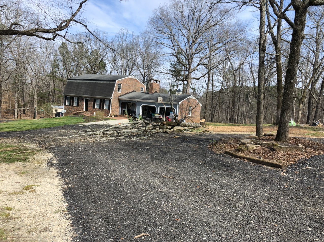

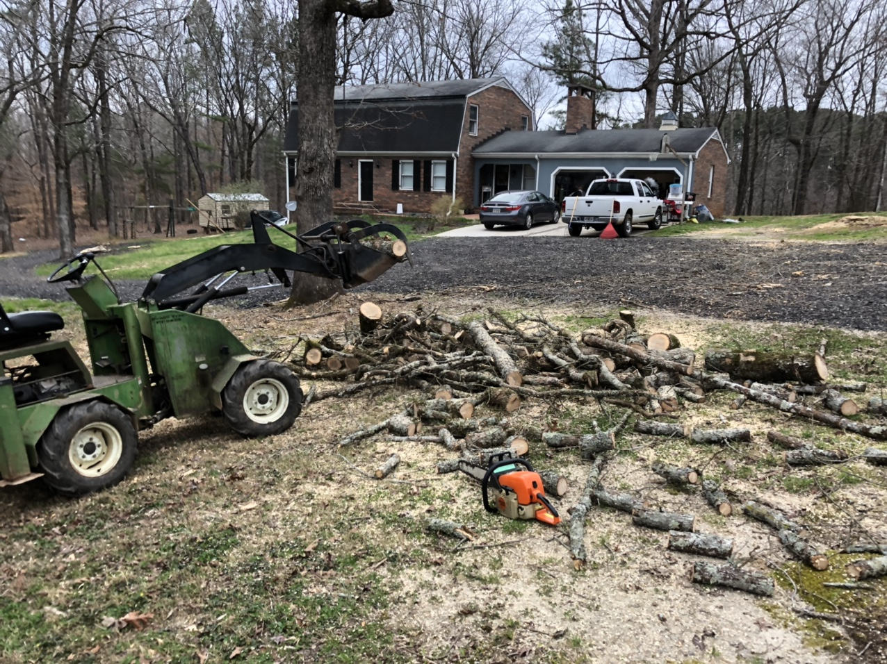

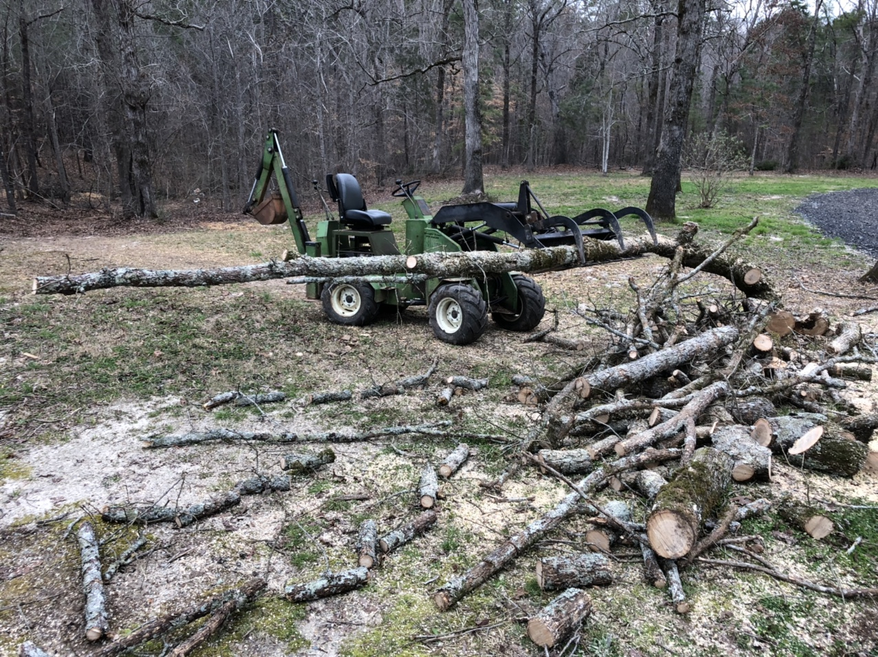

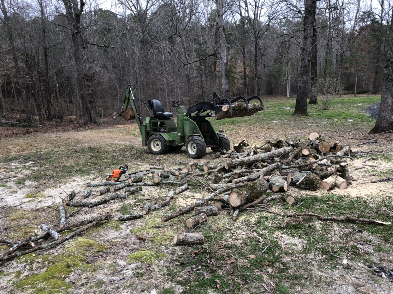

Cut down a tree in my yard and used mt 2425 to hold tree sections as i cut them into small enough pieces to put into my smoker. Then used the stump grinder to get rid of the stump in my yard. A good days work .View attachment 735234View attachment 735235View attachment 735236View attachment 735237

Perfect application for the PT. Nice work!
Any tips on the stump grinder useage?
I plan on using mine or the first time in the next couple days.

I start on the side closest to the machine and slowly work my way through the stump i switch sides and work from opposite when i have gotten to where i have alot of surface being cut at one time. It seems to cut faster when it is a smaller area cutting on the face. I tilt the stump grinder all the way back and lower it down to the stump and when i make contact with the stump then tilt to lower the head a little at a time. Be paitent with it and dont get in a hurry. It takes a little time to get the hang of it, when you do then it will go pretty well. There is a art to using it, you cant power through it at all.It takes finesse
