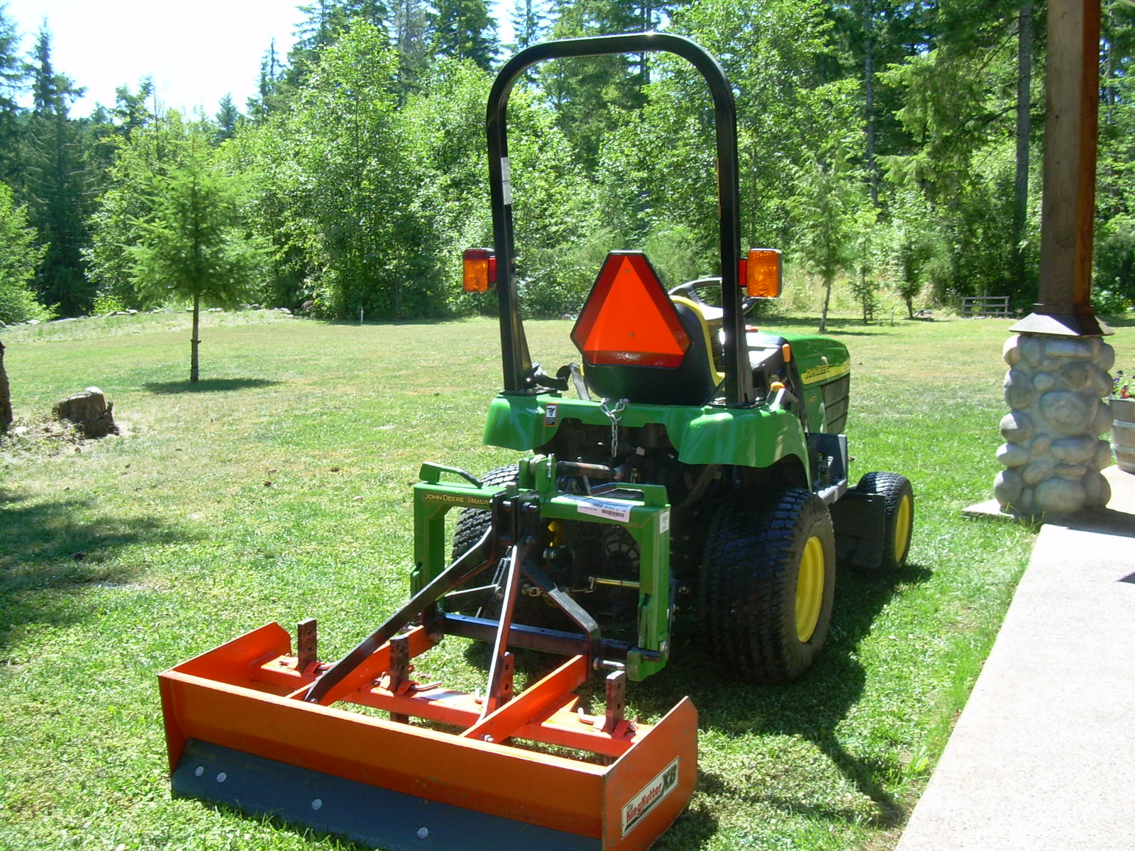

Yesterday, I borrowed my Grandpa's little 2210 johndeere with my grader blade and boxblade. I got seat time!:D I pulled a lot of gravel to the slick spots and packed them down. I think the driveway might be a little easier since it is 5 feet wider now and is packed down. The lawn tractor does have 10 inch tires on the back but I was wondering if bar tires woild help for traction. I wont have to go down the driveway for a while because I used the 2210 to grade the main road that I maintain. Will the gravel loosen making the driveway hard to navigate. I cant really go around because there is only thick brush and trees everywhere! (we live in the woods) The lawn stops wher the hill begins so I never have that problem but I might cosider bar tires. would they help any?:confused:
The picture ballow is my grandpa's johndeere 2210 with my boxblade:)
