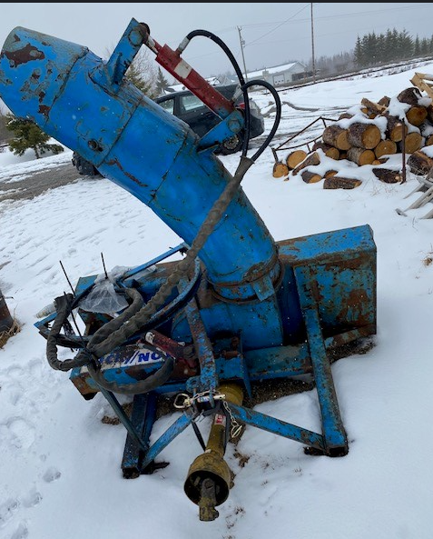

Hi everyone
I am looking for what this thing would be called, where to find it and things to consider ... I bought a snow blower and it has two function on the chute (up down), one for the tilt (two hoses) and one for the chute rotation(left or right) (a other two hoses so 4 in total) ... I can't add more function to my tractor so that's not a option. What I am picturing is a directional valve from my third function spool, so two hoses that goes to a ''box'' manual directional valve that would go to one set of hoses or the other for one or the other function. Worse come the worse I don't need to chute function but it would be nice if I can make this work.

Its a Massey Ferguson 2706e and I have a two functions spool with PB that feed a second single spool with PB that feed my 3point.. I only use the single function spool for my grappler and I want to uses that for the snow blower. so I have these two hoses (one function) available.

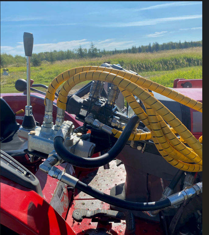

I know its been about 7 years now.....so pre-covid-flation. But I put 3 remotes on the back of my tractor for under $500

I’d just mount a two spool loader type valve to the fender or on rops whichever side you turn around in the seat to run blower. Run power beyond from third function valve to it then from it to 3 point. It would be very intuitive to control blower with a single lever.

You wouldn't use the pump directly, rather the power beyond port from your loader or RR. Basically, you run them in series, and when the pressure/flow is needed on one port it is available. Would also need to replumb the tank return line.
/ what do I need ? (hydraulics) #14
Yea, you use a power beyond port.
Since you already have a loader....the ports on the tractor become simplified. the only line you need to "ADD" is a tank line.
You simply take the PB port coming out of the loader.....follow where ever it is going to. This hose marks both the P and PB of the new valve.
In otherwords....you currently have your loader valve pb probably going to the tractor somewhere. Take that PB and make it go to the new valve.....and the PB out of the new valve goes to wherever that old hose went on the tractor. Then simply add the tank line which can be tee'd into an existing tank line.
Then its just the work ports of the valve going to the remotes.
Figuring out the hydraulics is the easy part.....finding a place to mount the valve and handles as well as couplers is where it can get challenging and may need some good fabrication skills.
I am sure parts have gone up in the 7 years since I did mine, but there is a link in my signature to what/how I did mine
