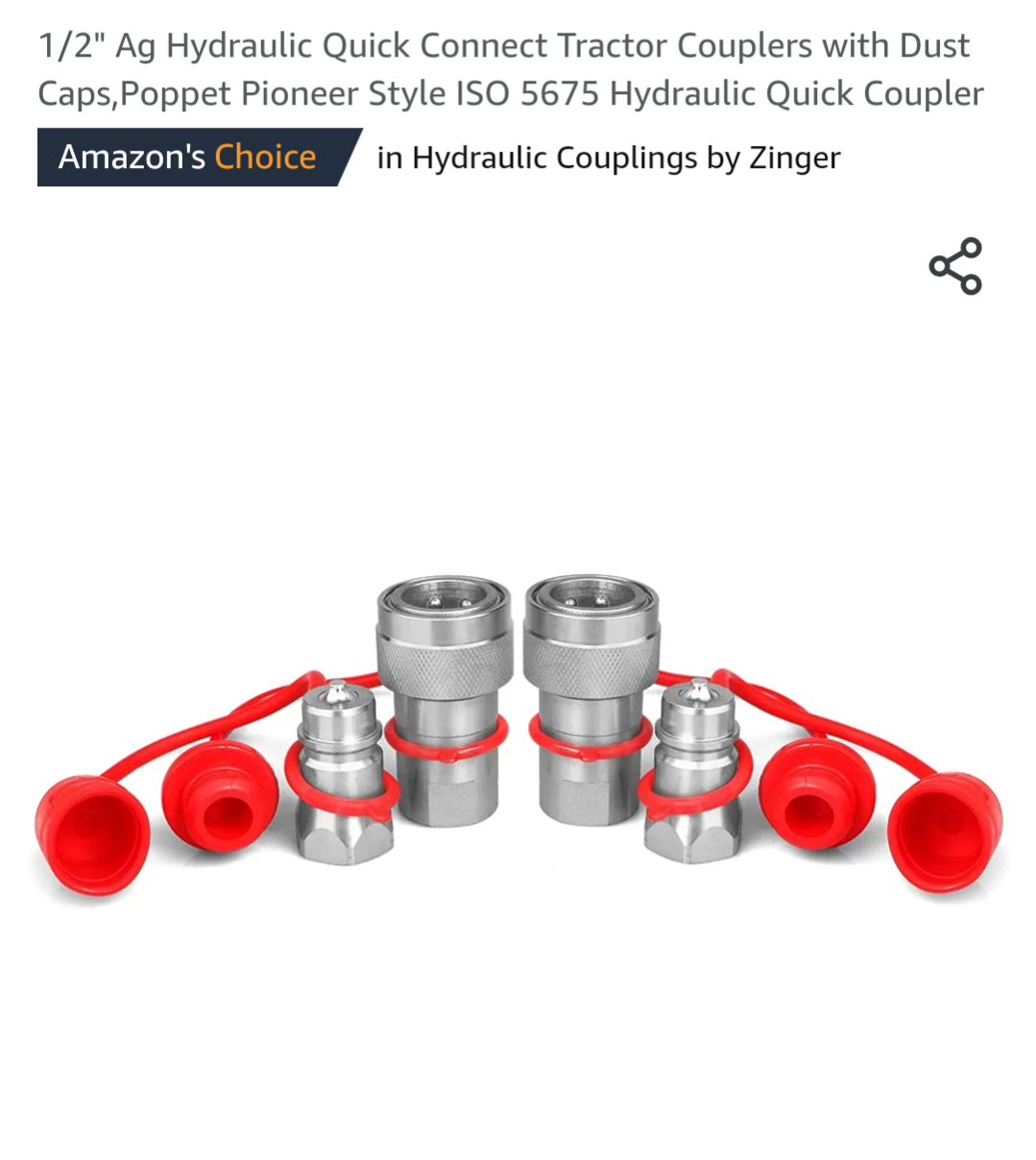

I thought it'd be simple to replace this hydraulic line. I asked the dealer to identify the couplers but instead they sent me a picture of them. which doesn't help a lick since I know exactly what they look like. I figured it'd be easier to "ask the audience" which has gotten me much closer to a solution. looks like female JIC to larger either male or female JIC to new hose to male or female JIC to male NPT to Quick Connect.
based on dealers pictures I really think this is 5675? does that make sense? do you agree? 1st picture is know 1/2 AG Hydraulic quick connect iso 5675. 2nd picture is dealer.
If this still isn't right I guess I can drive out to dealer and pick up some QDs and work my way backwards. I appreciate all the help!

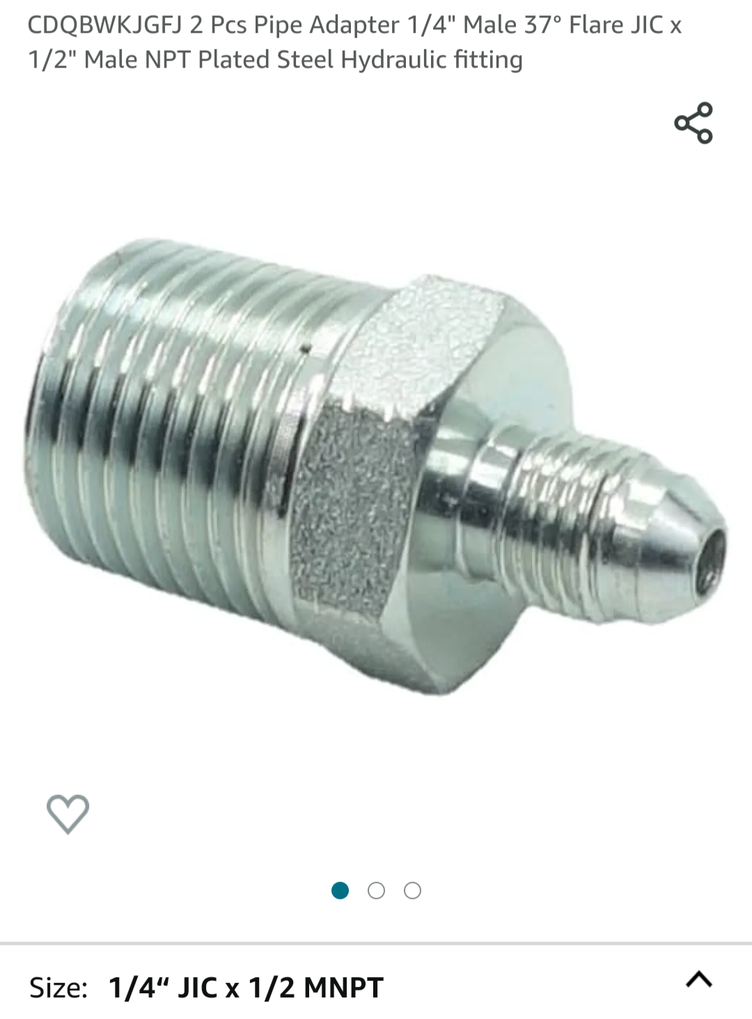

So, I'm curious if I'm not doing SOMETHING wrong. but I can't get these new parts to tighten completely on each other. especially the 1/2 inch male NPT to QD(1/2 female NPT). The threads line up great and mate up perfectly for the first 4 threads or so and then it just won't turn/go on any further. There's about another 6 to go. If NPT doesn't go with NPT then I'm at a loss. Attaching pictures of what I bought. they should most certainly work together from what I see. maybe it's just not supposed to go on further but it definitely doesn't seem right to me.

Are you sure your couplers have npt thread?
Could as well be bpt. The image doesn't say either. That's straight and npt won't thread in very far.
