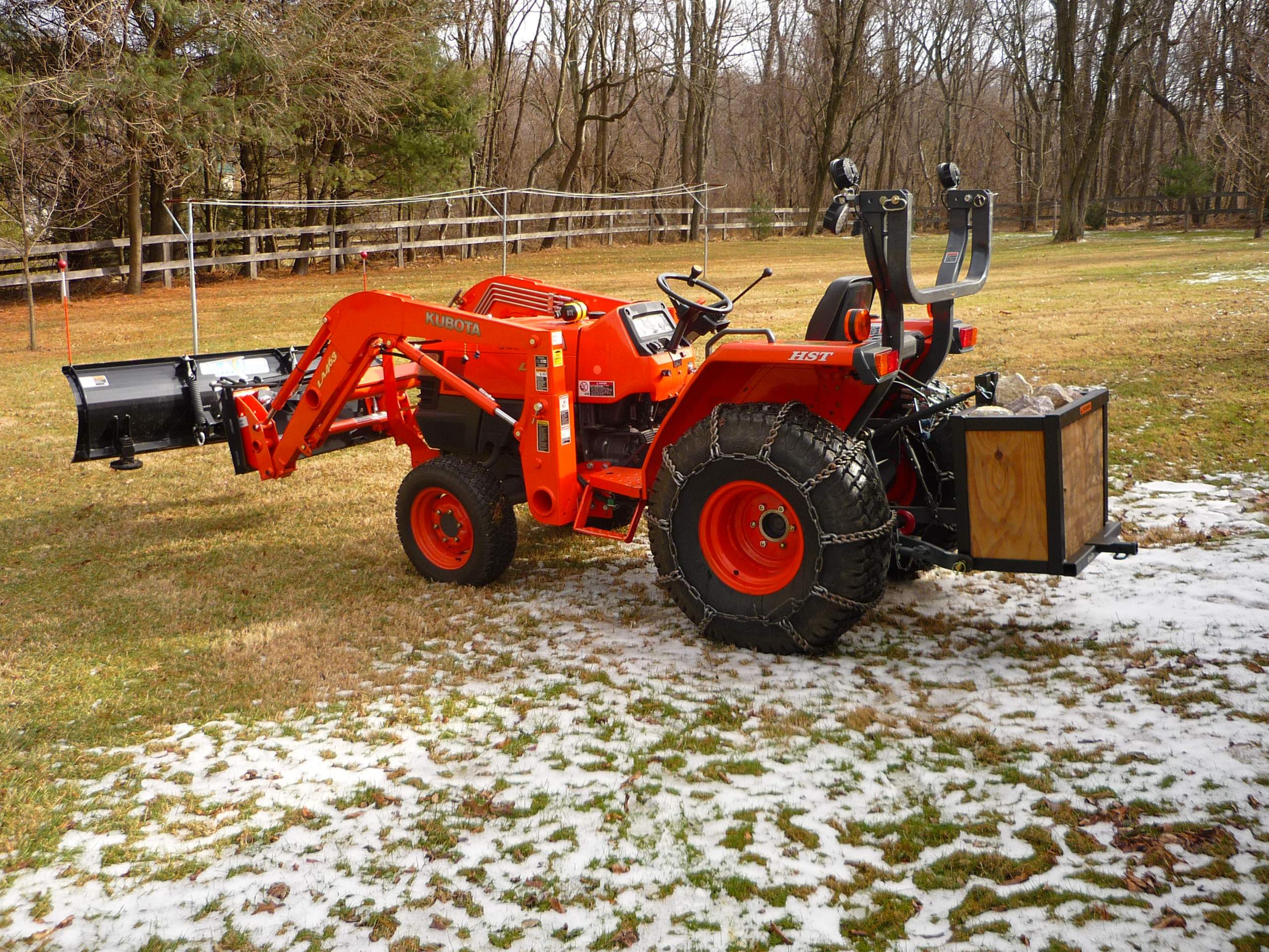

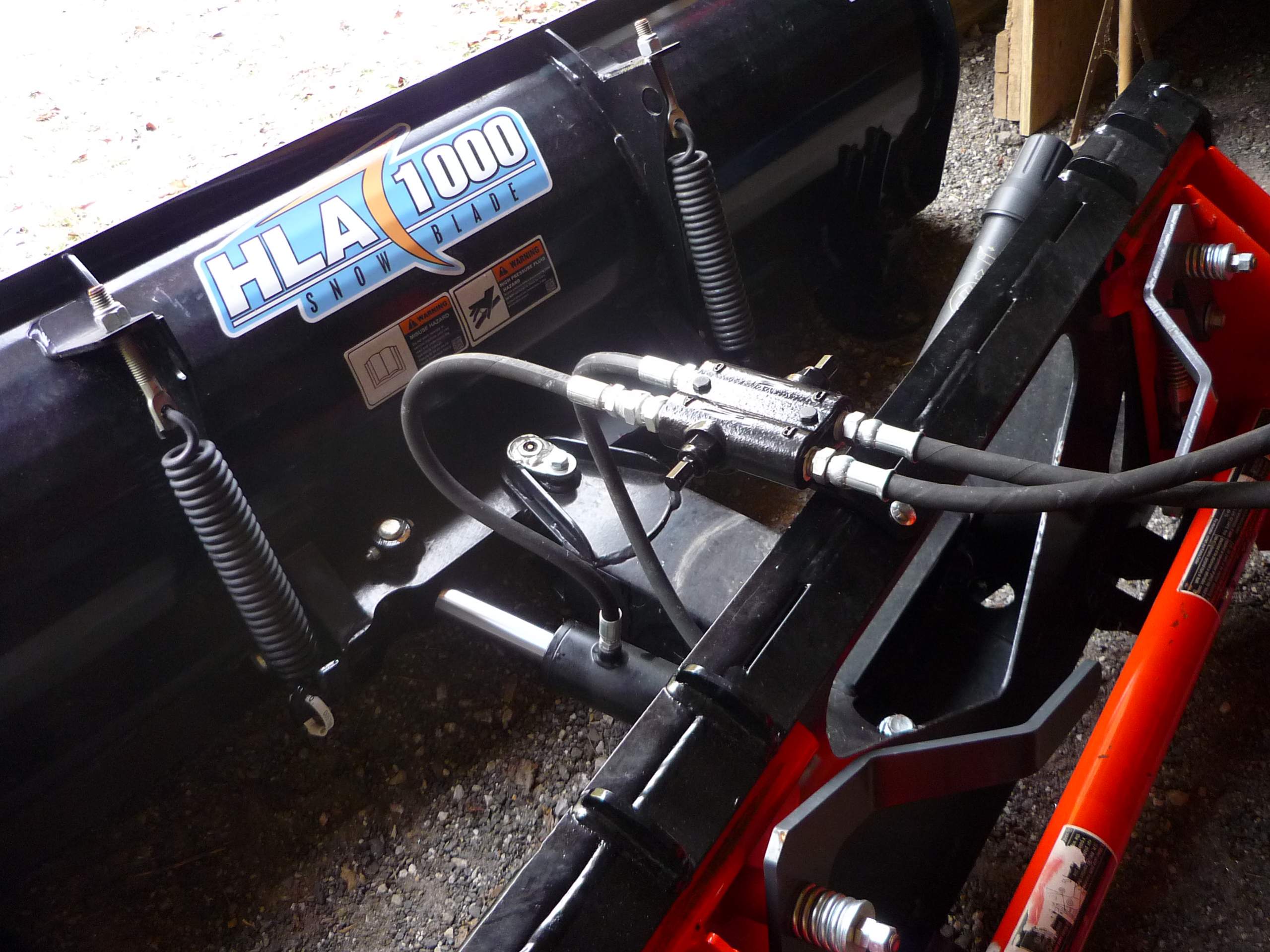

Musdalen, I use the rear remote to angle the front snowplow... simply some hydraulic hoses with fittings run forward... If you are fetching a lot of wood, then a grapple (using hydraulics) would be a fine addition. As for post hole augers, pretty much any tractor will handle them. My first Kubota, a B8200, had a whooping 15 hp at the PTO, and drove a 9" HD auger with no trouble. And, as another poster noted, a clean used tractor shouldn't need any dealer service, typically, and will allow buying more equipment with your budget. I would love a cab for snow work, but when in the woods, or using the PHD, it would be a hassle and subject to getting damaged. Maybe I need two tractors?
Nah- I don't really even need one, but I figure it's a good way to "invest" my money and save a lot of hard work to boot. Bought right, and taken care of, you should be able to recover most, if not all, of your "investment". At least, that's been my experience with the first two Kubotas I owned. I cleaned them up, added some useful extras, and took good care of them, but they more than paid me back. Take your time, watch Tractorhouse and dealers within a reasonable distance, and good luck! Craig's list can work, but of course, it's hit or miss.
Oh, having begun with gear drive and then two HST's, I would never go back. I would like to go "forward" to the newer HST's on the Grand L's, but ain't gonna happen. Too old.
