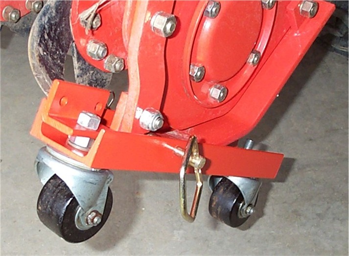

I have used a FC tiller for the past two years. I am very satisfied with the performance and I have had no problems.
If you buy a FC you may want to make a set of dollies for it. They are simple to make and they make it real easy to hookup and remove. I am sure that the same system will work on other tiller brands also.

Nice Dolly, JWE: At first I thought that the pin was to hold the tiller end on the dolly until you have it attached to your 3ph and are ready to raise it; but now I'm not sure; How does the pin lock?

MadDog.. The pin just slides over the skid. The dollies are very easy to install and remove. I can push my tiller around my garage floor with one hand.
Attached is a better picture of the retaining pin.

Good idea JWE. I think I will have to do something like that too for the new tiller I just got.
   / What do think of First Choice tillers. #10
Thanks, I think I understand it now. The pin is long enough so that it goes through both sides of the angle iron and over the tiller skid that is resting on the dolly. That's a neat idea.
Looks like it would be pretty easy to make with just a bit of cutting and drilling on the channel bar, which I think I can handle with a band saw and drill press.
