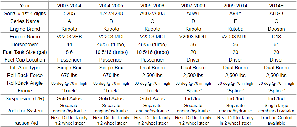

What Series is it?

Someone please correct me if i’m wrong but i believe it was the early machines (through 2006) with the live axles that had the drive motor issue and was corrected on 2007 models with the new independent suspension??? I know at the very least the part numbers on the drove motors changed at that point.
I am curious though if that’s correct if the replacement drive motors that the factory replaced under warranty were different part numbers? From what i can tell it appears that most machines have not had the issue reoccur after having them initially replaced.
I was looking for a very specific machine. I wanted the early machines with the live axles as I know I’d need the locking rear diff to consistently and reliably get up and down our mountain after a previous bed experience with a power trac tractor which only had lsd like the 2007-2013 toolcats. Wanted the additional roll back force of the updated boom, and preferred the extra power of the turbo to get up the mountain quicker. So that’s literally only a 2006 machine and then crossing my fingers for a turbo. I was pretty lucky to find one with 800 hours without searching for years.
