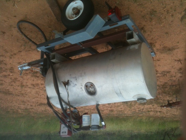

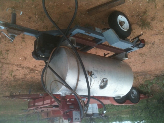

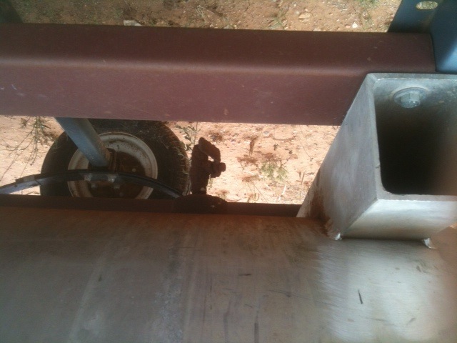

About 12 years ago I needed a fuel tender for my small single engine airplane as I was burning auto gas in it which they didn't keep at the airport. A friend gave me a 100 gallon aluminum diesel tank off of a semi tractor. I went to Payless Cashways (local lumber yard at the time) and bought a small single axle trailer kit for $99.00. Another friend tig welded a small sump in the bottom the tank with a drain valve and some 4X4 aluminum square tubing runners so I could mount the tank to the trailer. He also welded in a 2" bung hole in the top of the tank for the electric pump. I bought a 12V fil-rite pump and gallon meter for the rig. I mounted a battery box on the trailer tongue. I put a water filter and a particulate filter in line at the discharge side of the meter.
I used this rig for my plane for about 5 or 6 years until I overhauled the engine on the plane, upped the compression and had to switch back to 100LL AV gas. So the fuel tender has been relegated to hauling diesel for my tractor and skid loader. It works very well as long as you don't hook up the battery leads backwards. Don't ask how I know this.

A project like yours deserves a couple of pictures... ;-)

Sorry guys, I finally got the field today and got some pictures. This is the first time I have tried to upload pictures and I am not having much luck. It seems that the pictures display upside down, How come?
Tim

Must be aerobatic fuel tank. There is one possibility. Some picture browsers don't alter pictures. They just attach a "recipe" to them. The recipe contains all editing that was done to the picture while leaving the original unchanged. So if the original was taken up side down you see it rotated in picture browser but when posted it comes as original.
