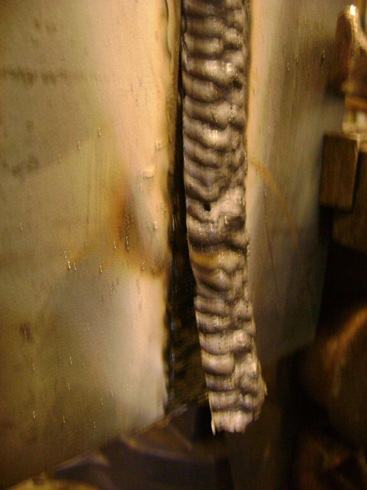

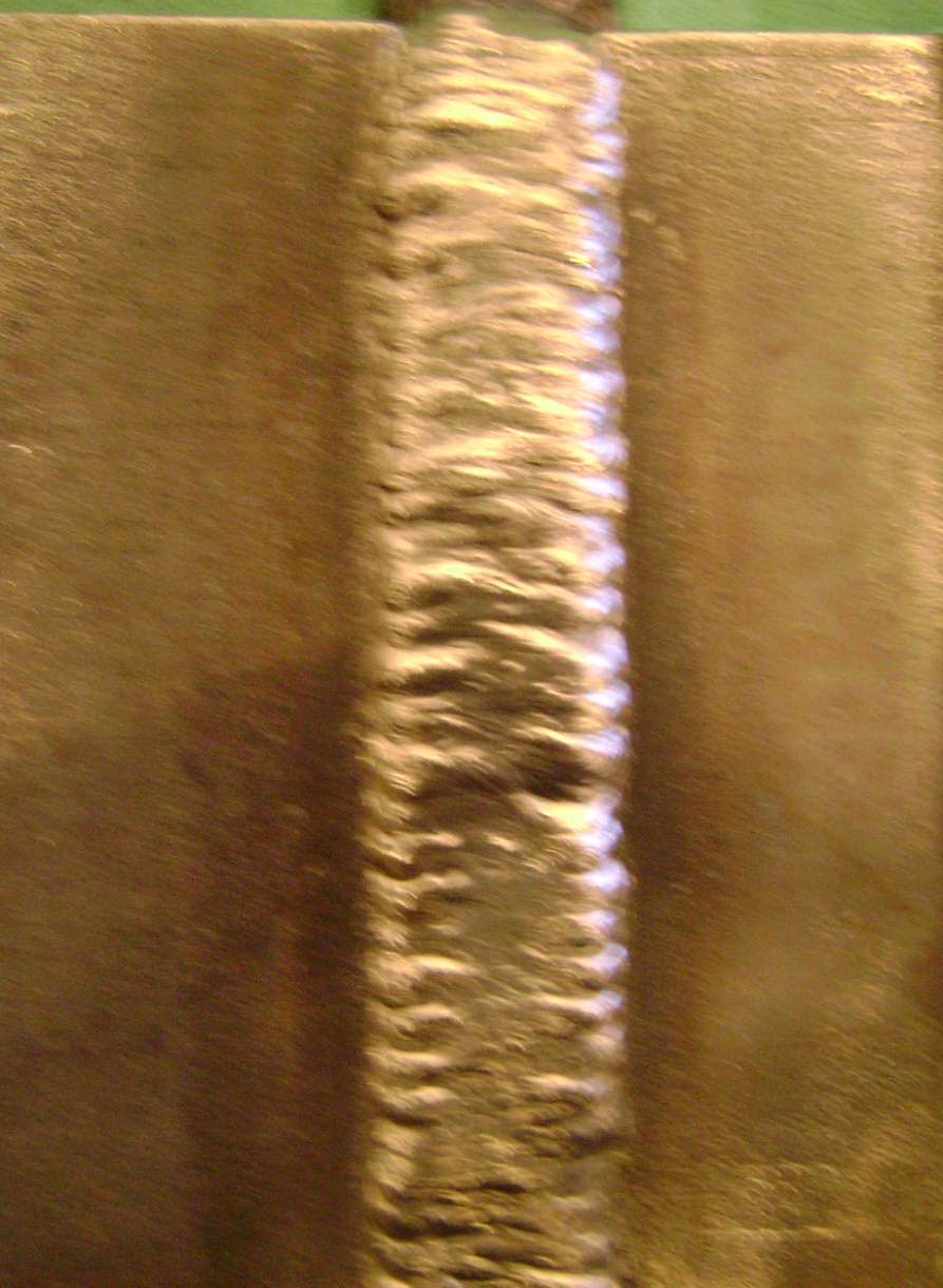

I never was a fan of 6013, if it was removed from the planet today I wouldn't mis it a bit.:laughing:
Vertical up with Lincoln's 6013.

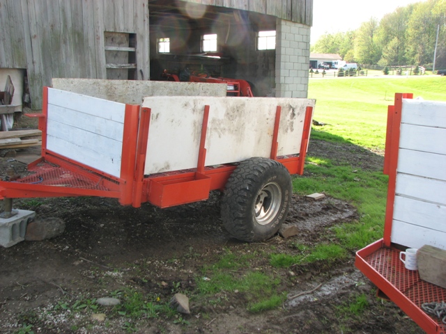

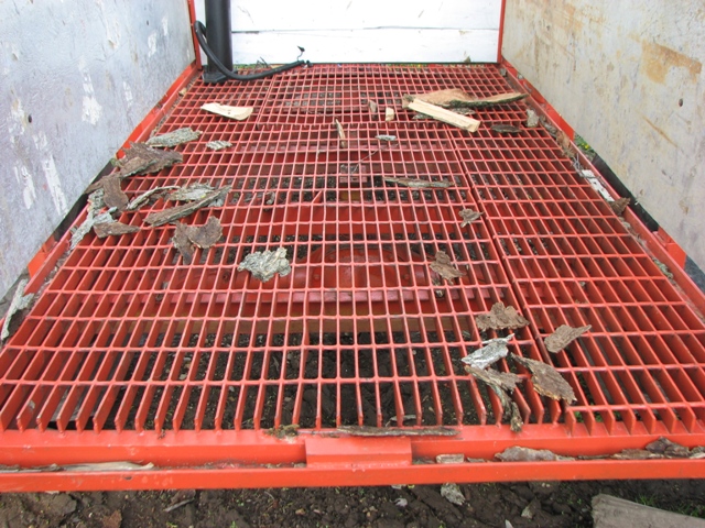

I also thought I share a few pics. This trailer was built with nothing but 6013 rod on an AC machine and with all cuts being with the torch.
It was built ~ 15 years ago before we had a mig. And has hauled countless loads of firewood.
