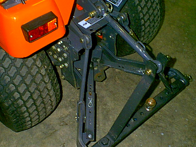

I have on for my BX22. I planned on putting a ball on it so I could pull my 6'x10' utility trailer but the drawbar turns when I try to pull a load. What else can I use it for :)

You need to get yourself a pair of <A target="_blank" HREF=http://www.speeco.com/asp/display.asp?view=top&category=Drawbar+Lock>Drawbar Locks</A> to prevent your drawbar's pins from rotating in the arms.

You could do what I did to mine, took a few minutes of time and a little bit of steel. I've attached a picture.

As a safe practice, it's not advisable to use a drawbar to pull anything. As long as the drawbar is kept below the axle center line, the acting forces work to keep the front of the tractor down. Above that point there's a possibility (if the towed load is heavy enough or stuck) of the tractor rotating in place around the rear axle and flipping backwards.
The drawbars mounted below the axle are designed to prevent that.

Most larger tractors have a "real" drawbar which is in an fixed position below the rear axle and can be safely used to hook up to anything you can get a chain around (the tractor may not pull everything you hook a chain to but at least the tractor won't come back over on you).
The type of drawbar you seem to be talking about can cause the tractor to flip over backwards if you attempt to pull too much weight with the three point raised too far or if the tongue weight is too great.
We have a Kubota 4310 with a device similar to the item in the photo attached above that has a tow pintle that is used to tow a large chipper (among other things) and if one of the children on the course try to pick the front of the chipper too high and take off too suddenly the front wheels will come up quite a ways even with the front weights on the tractor.
