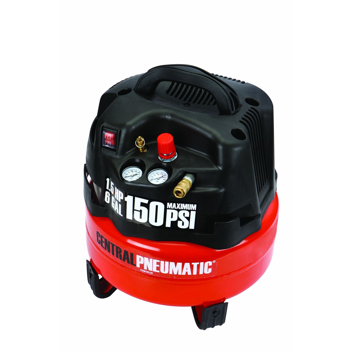

For an RV, I would've rather have went with something like this: Professional 150 PSI, 1.5 Horsepower 6 Gallon Compressor and used your inverter to run it.. Its cheaper, faster, and you never know when you might need the air for tools...
