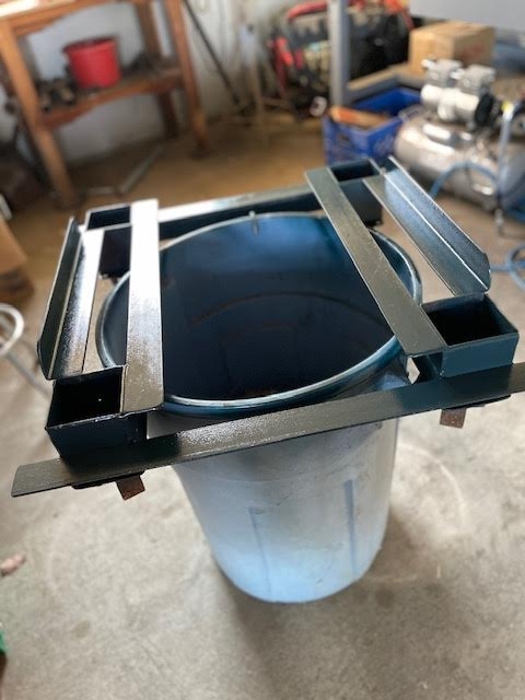

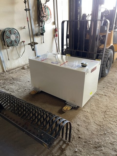

I bought a steel 100 gal tank and welded a couple of square tubes to the bottom for my forklift. The tank fits cross ways in the back of the truck. I use 1 " ratchet straps and drive slow. At home I built a coaster dolly for it so I can roll it around in the barn on the concrete floor a bit when needed. The tank is fitted with a 12v pump and nozzle. An old 12v battery sits on the floor next to its resting spot. It works well for me.

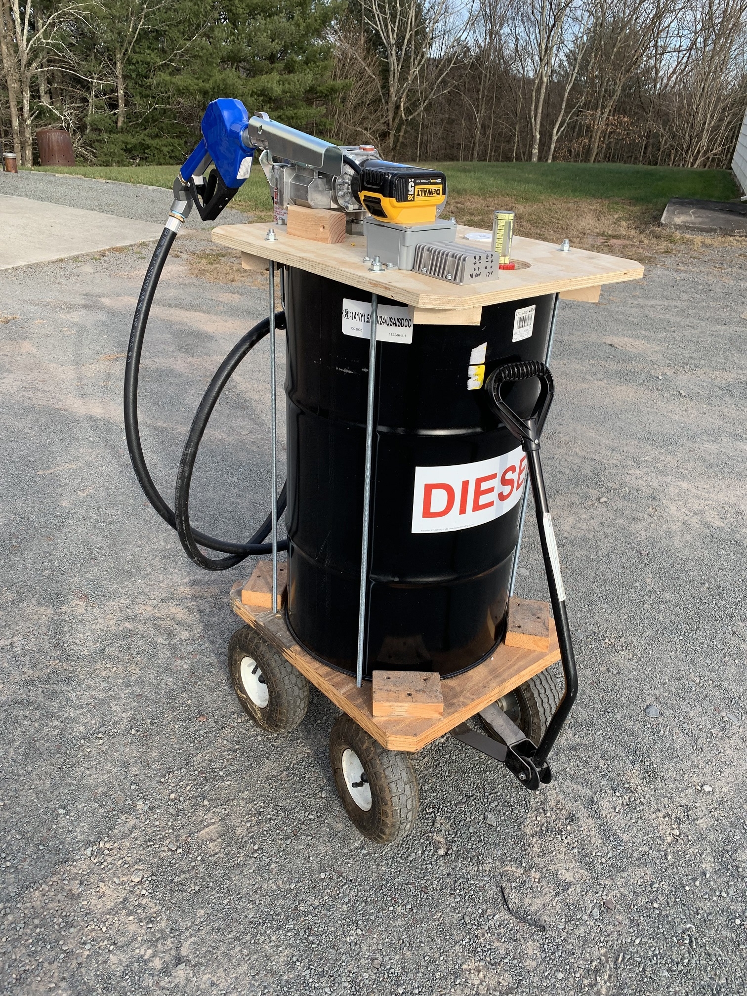

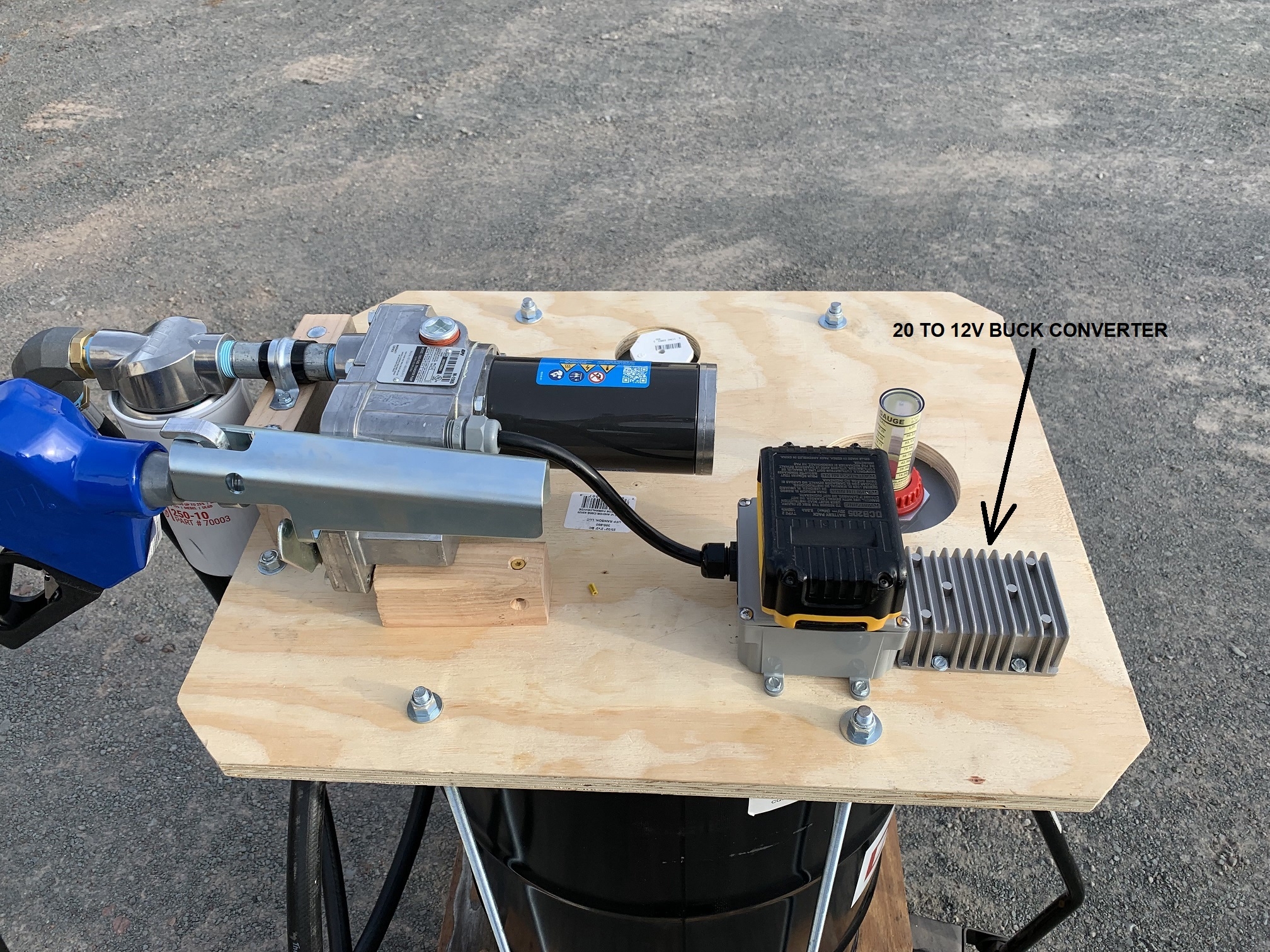

I did something similar. Before I began using #2 ULS home heating oil in my tractors, I transported diesel in my pickup. I mounted a 100 gal steel tank to a sturdy pallet made from treated lumber. The pallet had caster wheels on the bottom so I could roll it around in the pickup bed and also in the barn. I would place it up against the cab and securely hold it in place with ratchet straps during transport. To unload, I would roll it out to the tailgate and lift it off with the forks.
I only did this to transport fuel a short distance to and from the gas station. Since it's illegal in many locations, I would NOT consider leaving the tank in the truck full time.
Since the tank was portable, I needed a pump that was also portable with it's own power supply. This made it easy to move around to locations where neither AC or DC power was available. I used a standard 12V transfer pump and powered it with 20V cordless tool batteries. I always have several charged and ready to go for my cordless tools.
I used a 20V to 12V buck converter which I still use on a small drum to fuel my other diesel equipment.
