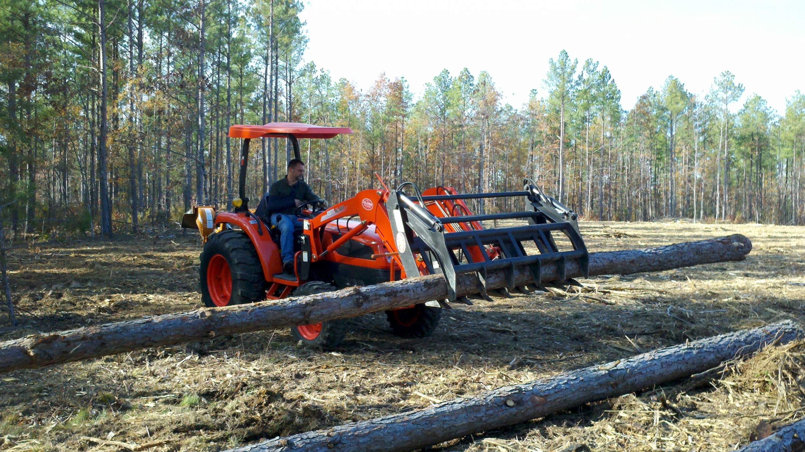

I like my DK50 for similar tasks. I was mud bogging it tonight in some seriously slimy wet sloppy gooey mud and my R4's did totally fine.
They also roll over the incredible slash piles without punctures.
I will say, the stump grinder is not enough ballast though...
I also plan that my kids will take over the tractor some day...
Be well. Happy Logging/tractoring:thumbsup:
