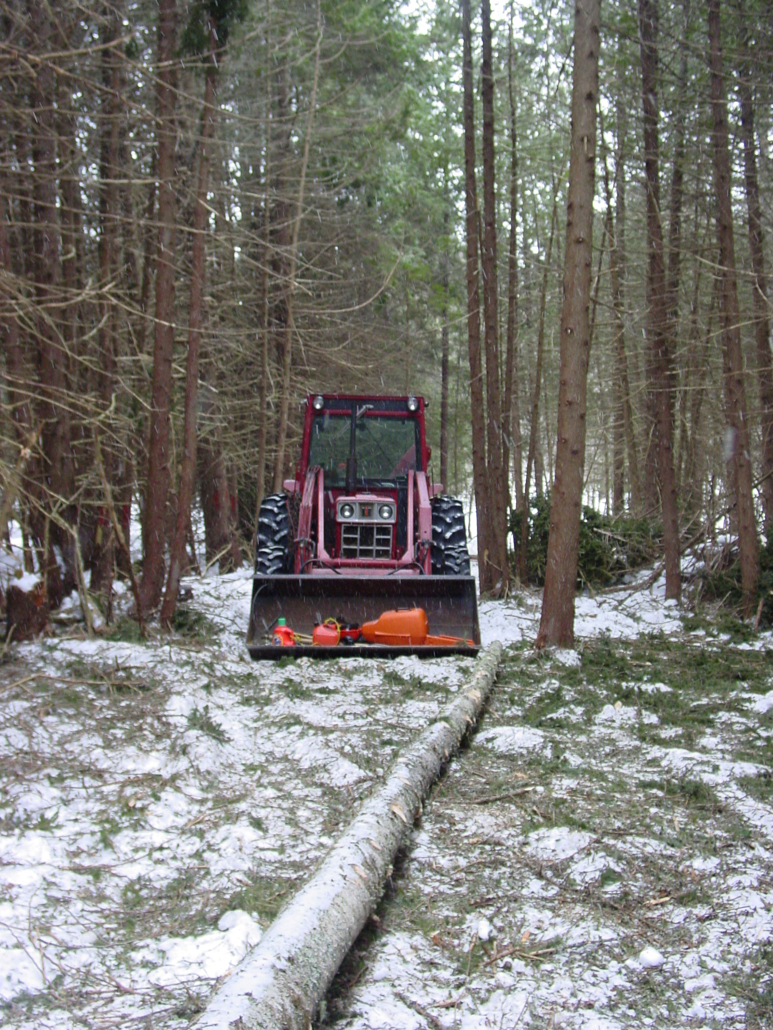

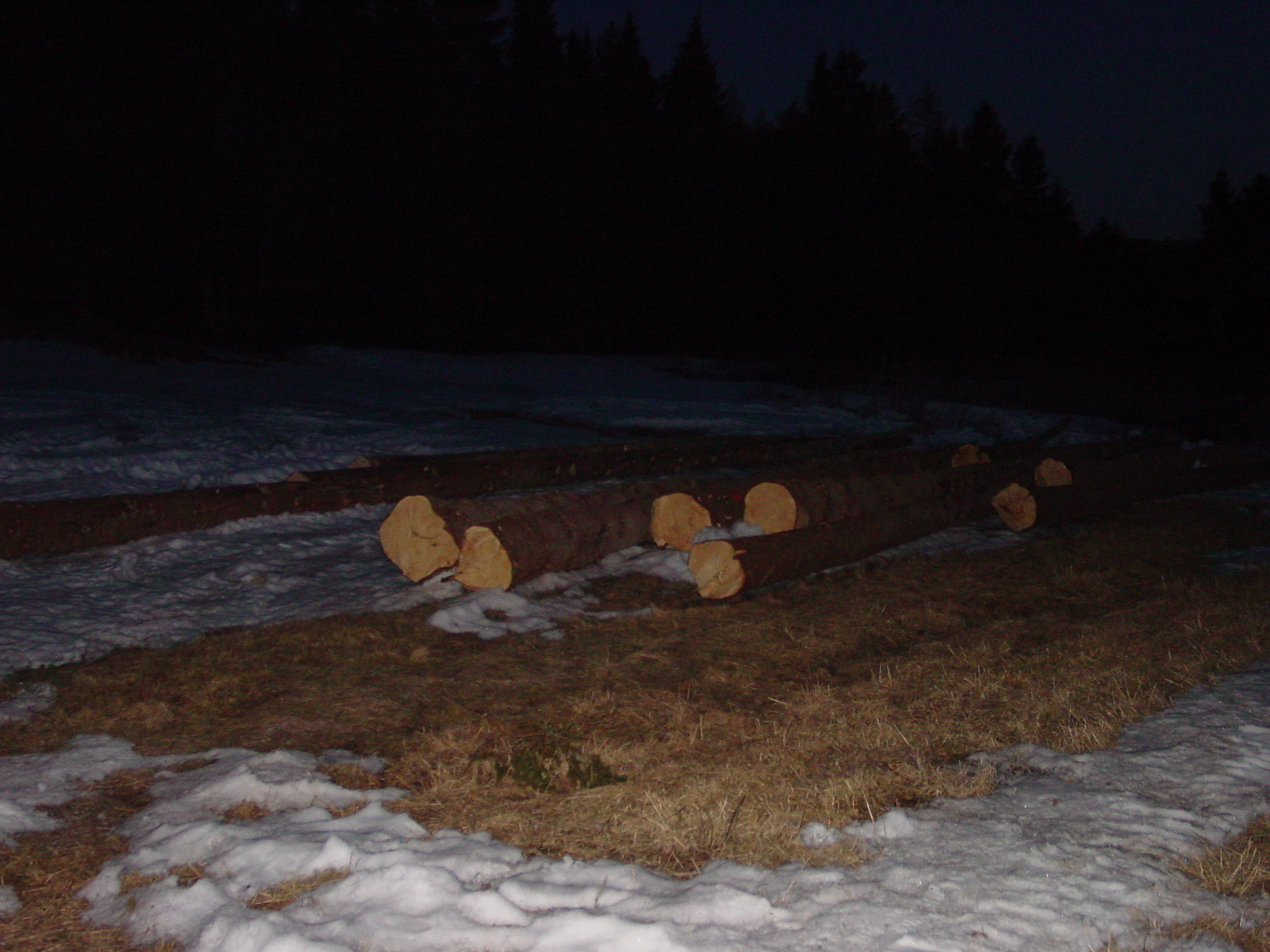

   / What do you use for logging? Prevent my divorce. #25
Just some pics in the spirit of the thread. Not the greatest, never time to shoot while working, and never took the camera during our normal work in the snow.

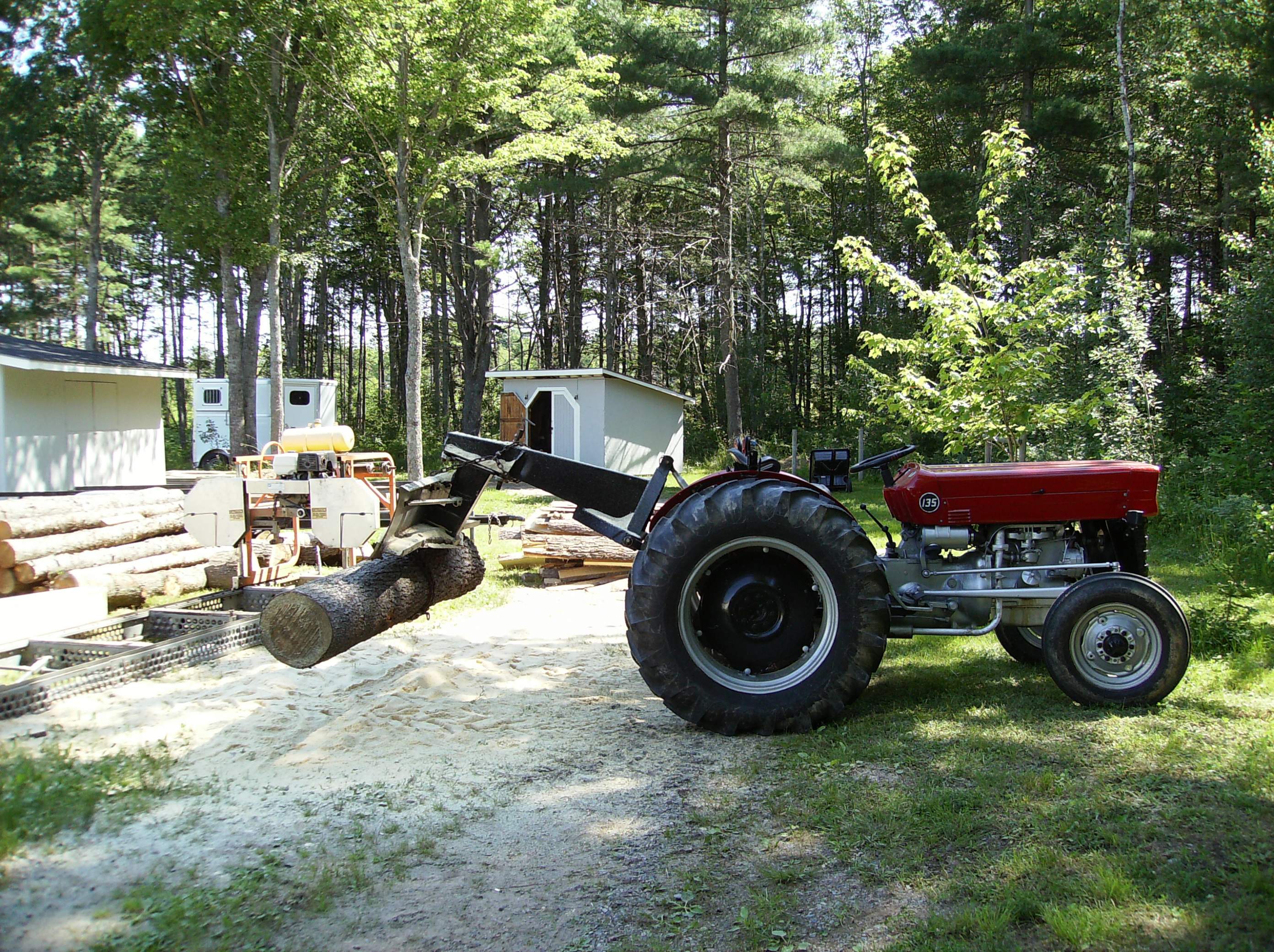

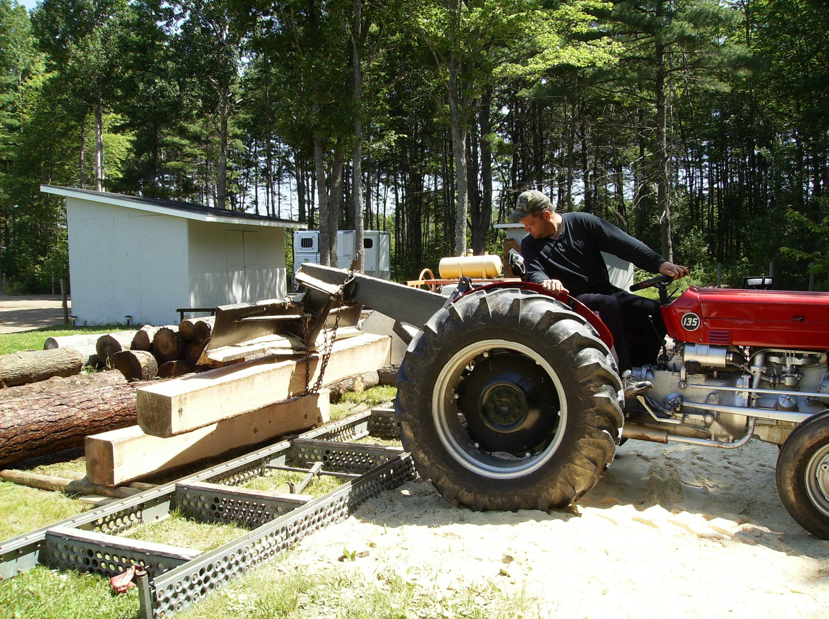

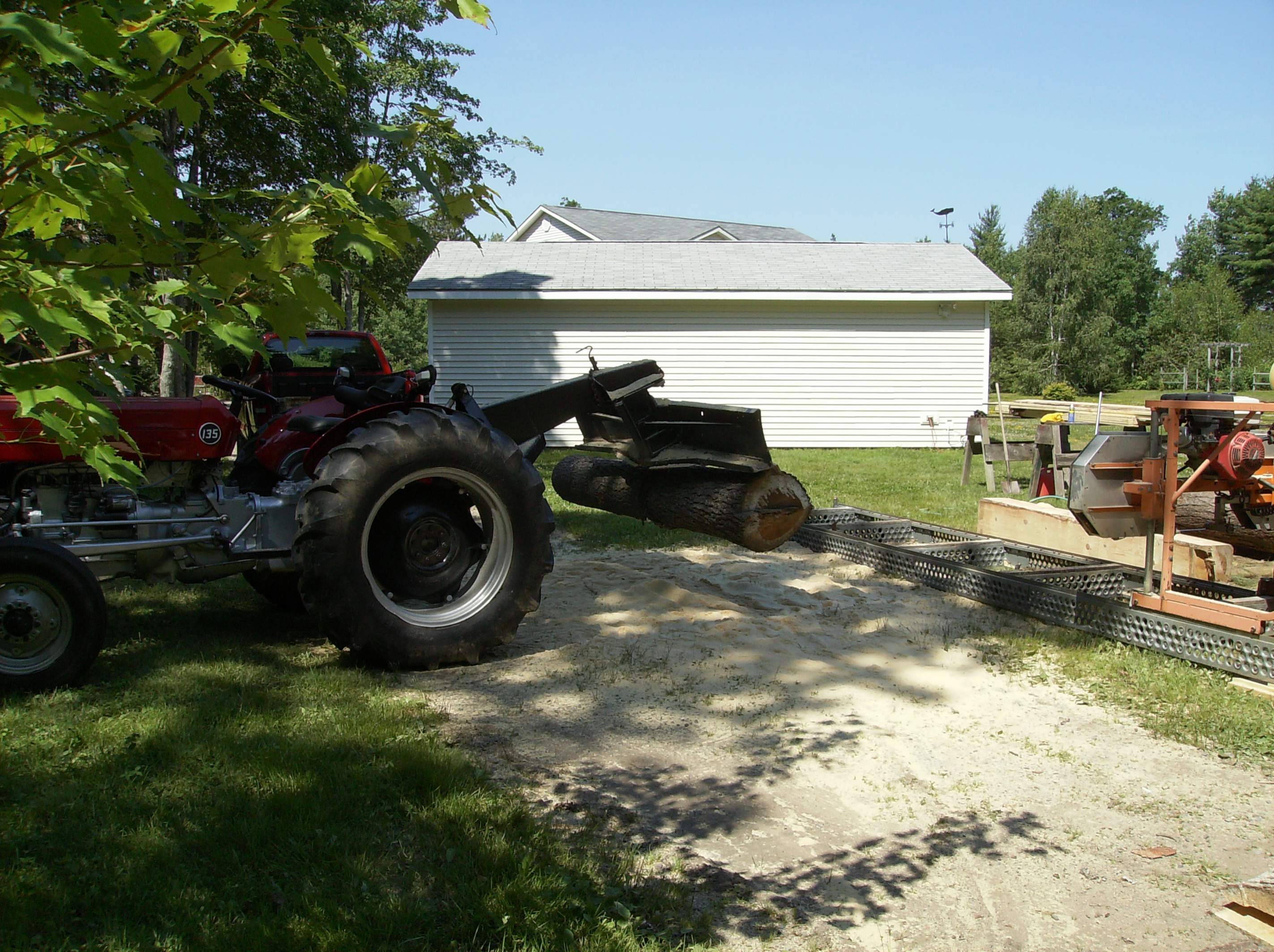

   / What do you use for logging? Prevent my divorce. #26
68' MF 135 gas, loaded rears, 7' MF rear blade and 2 10K chains. 3+ acres, enough lumber milled that I built my 20X30 workshop in background of photo number 3 and will be building a 32X40 garage. Some large white pines, black spruce and some poplar. Wife and I milled it all.

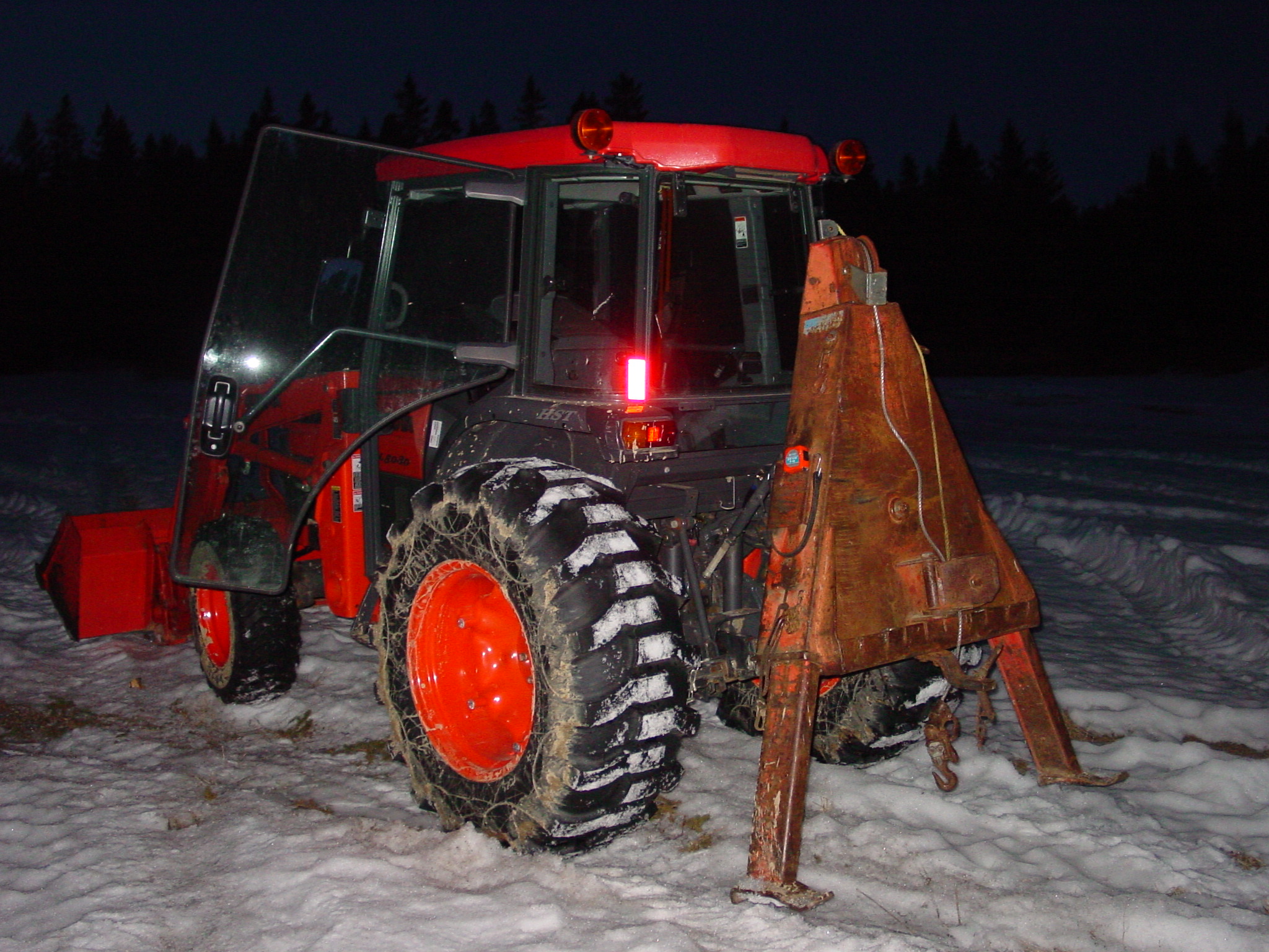

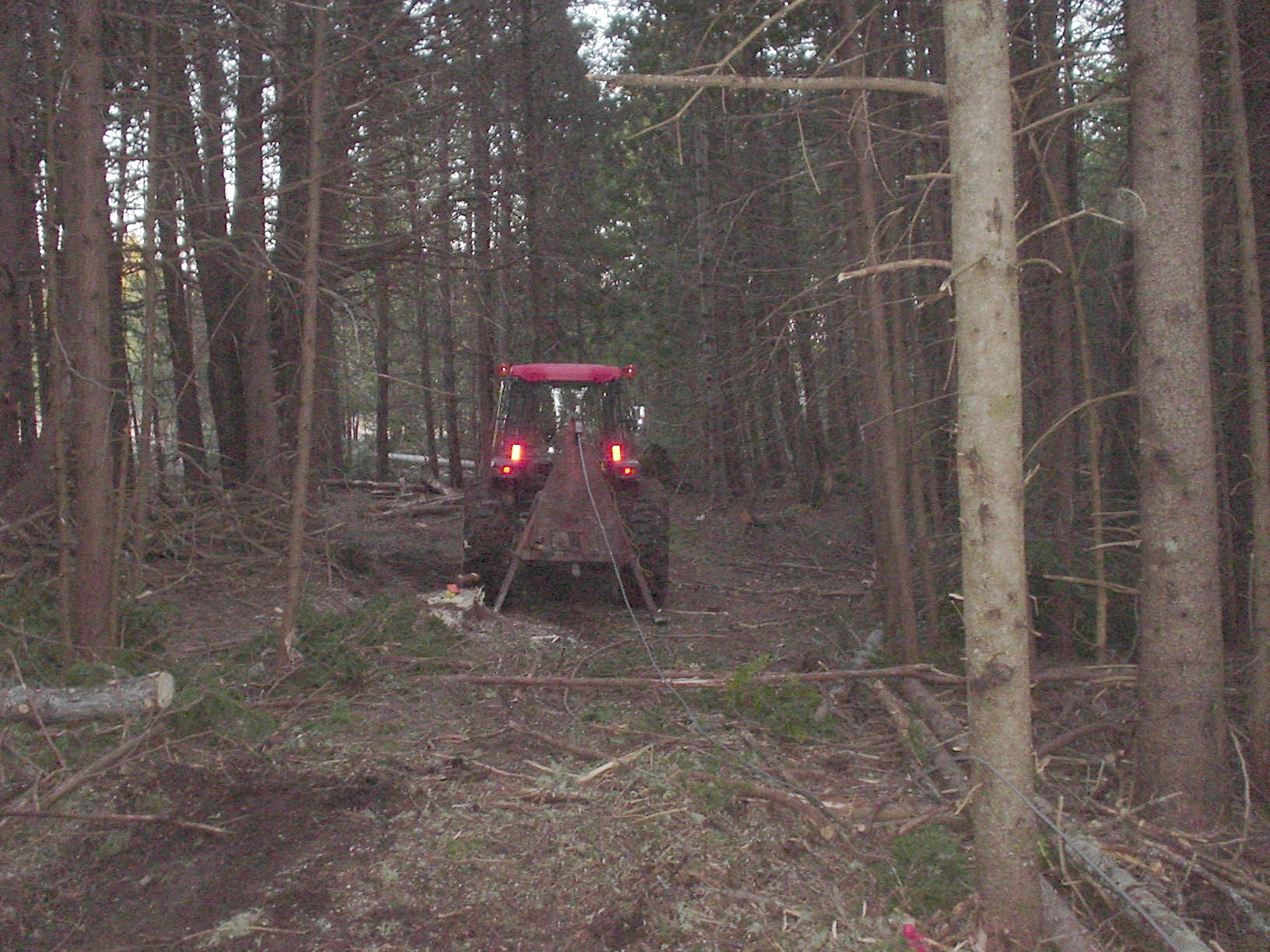

   / What do you use for logging? Prevent my divorce. #27
I use my Kubota GL4240 to log about 6 cord worth of wood a year. I only do it in the fall when the temps are reasonable. This year I started mid September and was done by early October. The tractor has the power to skid anything I've thrown at it including a pair of 50' long 18" diameter red maples. I don't think I would go with a larger tractor. Maybe a MX5100.
I find that the weight of the tractor on the wetter sections of the trails turns it quickly into a deep hole, a bigger tractor just means a bigger hole. I'm more of a be gentle on the land and not the get a large machine and just plow your way through type of person. I also find that because of the heavy snow falls we often get the ground may never freeze in the winter.
On some of the dirt hills I go up the ground just barely holds up to the weight of my tractor. I find that I need to use the diff lock or it will start digging the dirt even when not pulling anything. A heavier tractor just means it will require that much more traction. But I'm also lucky as I skid downhill.
I wouldn't think twice about a 3pt winch, get the correct size for what ever tractor you go with. For 6 cord a year I do it's not worth the money but any more than that and I can't see how it would not pay for itself. Right now I lug 20' lengths of 5/16" chain to the logs and string them up as often driving right up to the log is just out of the question. Plenty times I have to pull the log then back up and remove a section of chain and pull some more because I just can't get a nice long straight run. It's these little things that wear you out and add up time wise.
