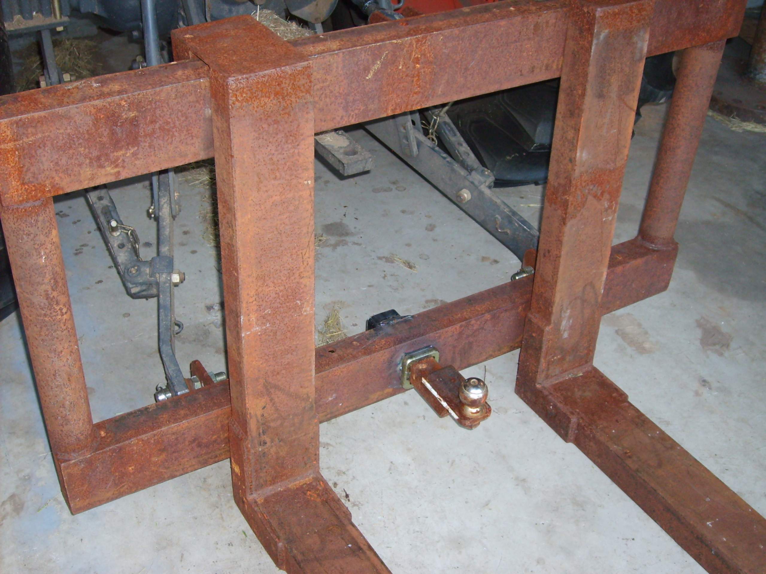

I made a Thing to attach to the the three point. It just stayed on most of the time.:D
Picture shows it all. Lots similar have been made by folks on here.:D

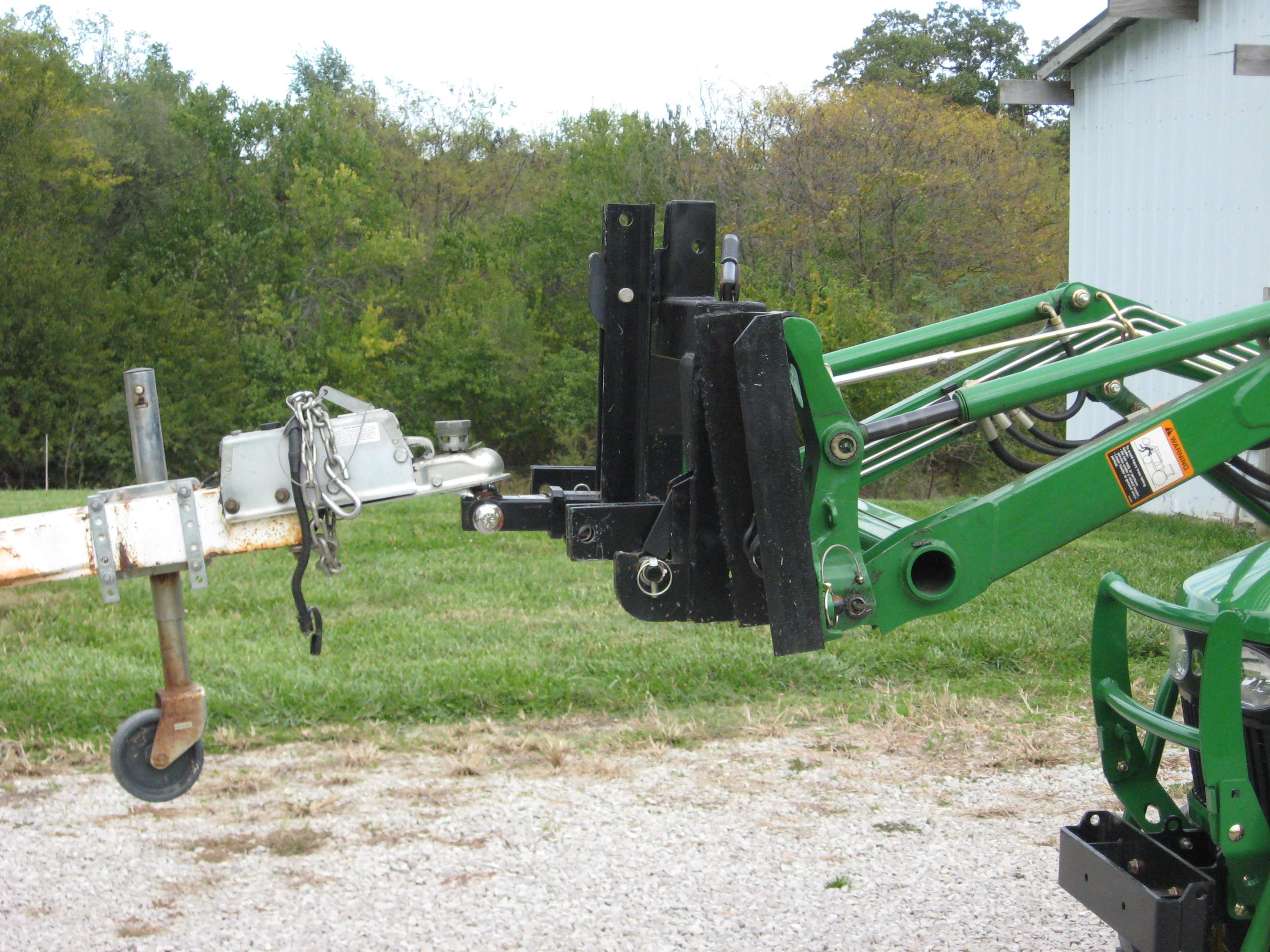

I use this home-made one, along with my front quick hitch.
