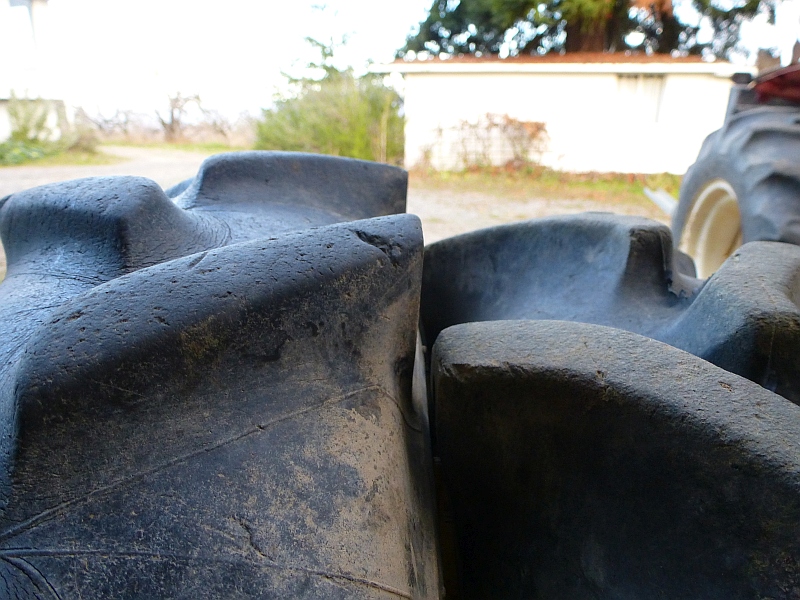

... current tires have 7.16 R1 on them, so I'm guessing that's the same as 7-16.
They are likely different diameter. If your application isn't 4x4 then it probably doesn't make any difference, so long as the weight rating is what you need.
Here's an example of front-axle tires for a little 18hp Yanmar 4x4:
6.00 x 12 (the taller tire) and a 6-12 (the size Yanmar specifies for YM186D).
p1740817rtire600x12vs6-12-jpg.438123
Width is different too. Here's the old thread with a discussion of this.

Thanks for this. I'm going to try and get some measurements off of the tire on the tractor and see if they match what the tire I'm considering buying. They are not original tires, but I don't remember what was on the tractor when I bought it. I tried doing a search for the front tires that came on a Century 2535, but haven't found it yet. Since it's 4 wheel drive, I want to get the correct size.
