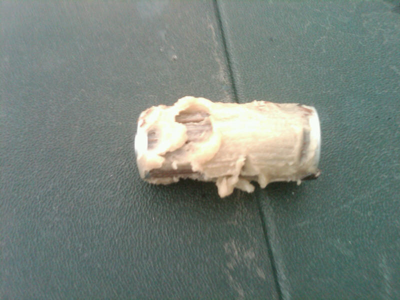

Ragkar
Here is what jelled fuel looks like on a fuel filter. Glad I keep a spare filter around. Removed the fuel bowl, dumped the ice out of the bottom of the bowl, put the new filter in and put a sizeable dose of Diesel 911 in the tank.
After everything was put back together the tractor started right up, then stalled as soon as I tried to increase revs. Started up again and, other than running about 200 rpm lower than normal it has been fine. Over the course of a couple of hours of running rpms returned to normal.

But for Diesel Service 911 (red bottle) to work, fuel must be flowing.
So gelling looks like mostly white with some red/brown color caking a lot like jell-o. The folds of the paper filter won't be visible. Red bottle Diesel Service will clear it up if the fuel is flowing. Use white bottle Diesel Service to avoid the problem.
Paraffin precipitation looks like white frost on the interior glass surface of the bowl. It can be avoided by using #1 diesel (winter blend) or adding Diesel service white bottle.
"The Cloud Point is the temperature at which paraffin, which is naturally present in #2 diesel fuel, begins to form cloudy wax crystals. When the fuel temperature reaches the cloud point, these wax crystals flowing with the fuel coat the filter element and quickly reduce the fuel flow, starving the engine. Typical cloud point temperatures range from: -18F (-28C) to +20F (-7C), but may occasionally be as high as +40F (4.4C). #1 diesel fuel (or kerosene) contains very little paraffin, and therefore has cloud and pour points near -40F (-40C)."
Water freezing will probably not be visible if it occurs in the lines or on the screens. Water condensation can be avoided by keeping the tank full of diesel.
The lucky-fix is to turn off the engine for a couple minutes and hope the engine heat will melt your problem.
