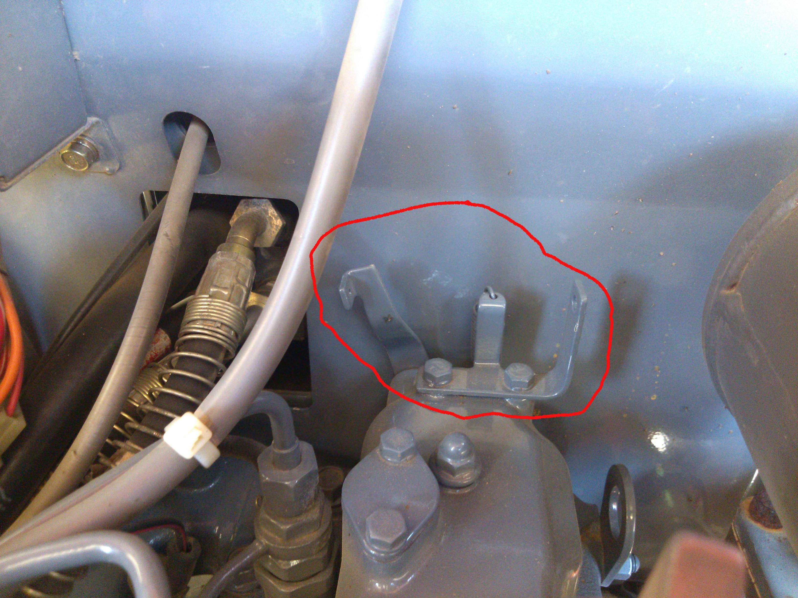

Like the thread header says; (if lever is moved upward while engine is running it will make a clacking noise and will kill the engine.)

De-compression valve (aids in starting) Doesn't look like its ever been connected???

Yeah had a old 175cc Yamaha Enduro that had 2 threaded holes in the top of the head, one was for spark plug the other a compression release could be fitted there. Some older bikes had to have a compression release just to start them.
I digress, so if it is a compression release (kinda sorta thought that), WHY? Seems silly to make a working part then not use it.

Here is a guess as to why it is there. I had a 3 cylinder marine diesel that that a hand crank for emergencies. If you ever tried to crank a high compression diesel by hand, you'd know why a compression release is needed. Daedong (spelling?) makes diesels for a lot of applications. Maybe small marine engines is one of them. If so, it is easier to just not connect it in tractor use rather than have a separate version of the engine.

"ah~ sokka~"? as they say in Japan, oh wait Kioti is Korean so "Ah... Al-get-sup-ni-da" , I see, so a left over from a probable other usage.

How does a diesel start without compression? Or do they do something like leave one cyl at full compression?

You get it spinning and then pop the compression release. It isn't easy.

I had de-compression on an old Kubota and really liked it. It puts less load on the starter because you can get engine spinning to higher RPM before putting compression load on it. Plus allows to spin the engine over for a few seconds to get that cold oil flowing for better lube when it starts.
