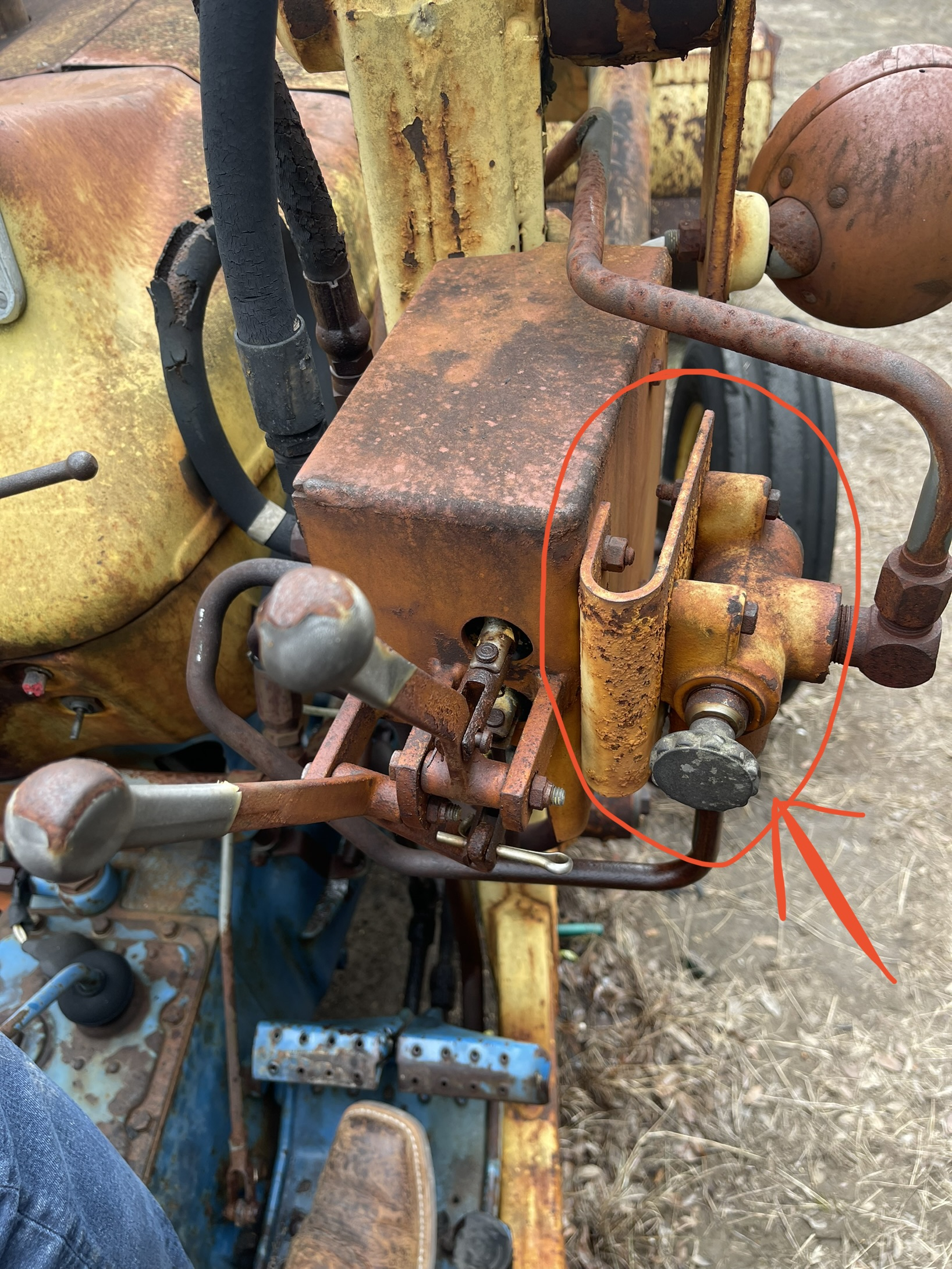

I just bought an OLD Ford 4500 Backhoe/loader and the valve packs for the loader and backhoe are different to any others I have seen. They seem to have an additional isolation valve. Was wondering if this is common, and what is the purpose. Pics attached so you can see what I am talking about.
Appreciate any help/comments you can give!!!

Looks like a diverter but it may be used as a speed valve. That's just a guess though.
/ What does this do? #3
Question #1 Is the valve at the backhoe spring centered and where do the hoses go?
Question #2 Does the selector valve on the loader control the backhoe? I used to work for a Ford dealer years ago and have operated the 4500's but it's been way too many years. I do remember the selector valve but don't remember what it does.

As a WAG (Wild A$$ Guess) I would say its a pressure relief valve....
/ What does this do? #7
The last pic looks like a relief of some kind that is feeding the other valve on the backhoe.
IT dont look original.
Where do the hoses off the valve go? Does the backhoe have some other attachment like a hydraulic thumb?
Have you tried running the machine and operating that valve and see what it does?
I'd replace a few of them hoses....dont like that location of that hose loop and valve when sitting on the backhoe operating. Makes me cringe

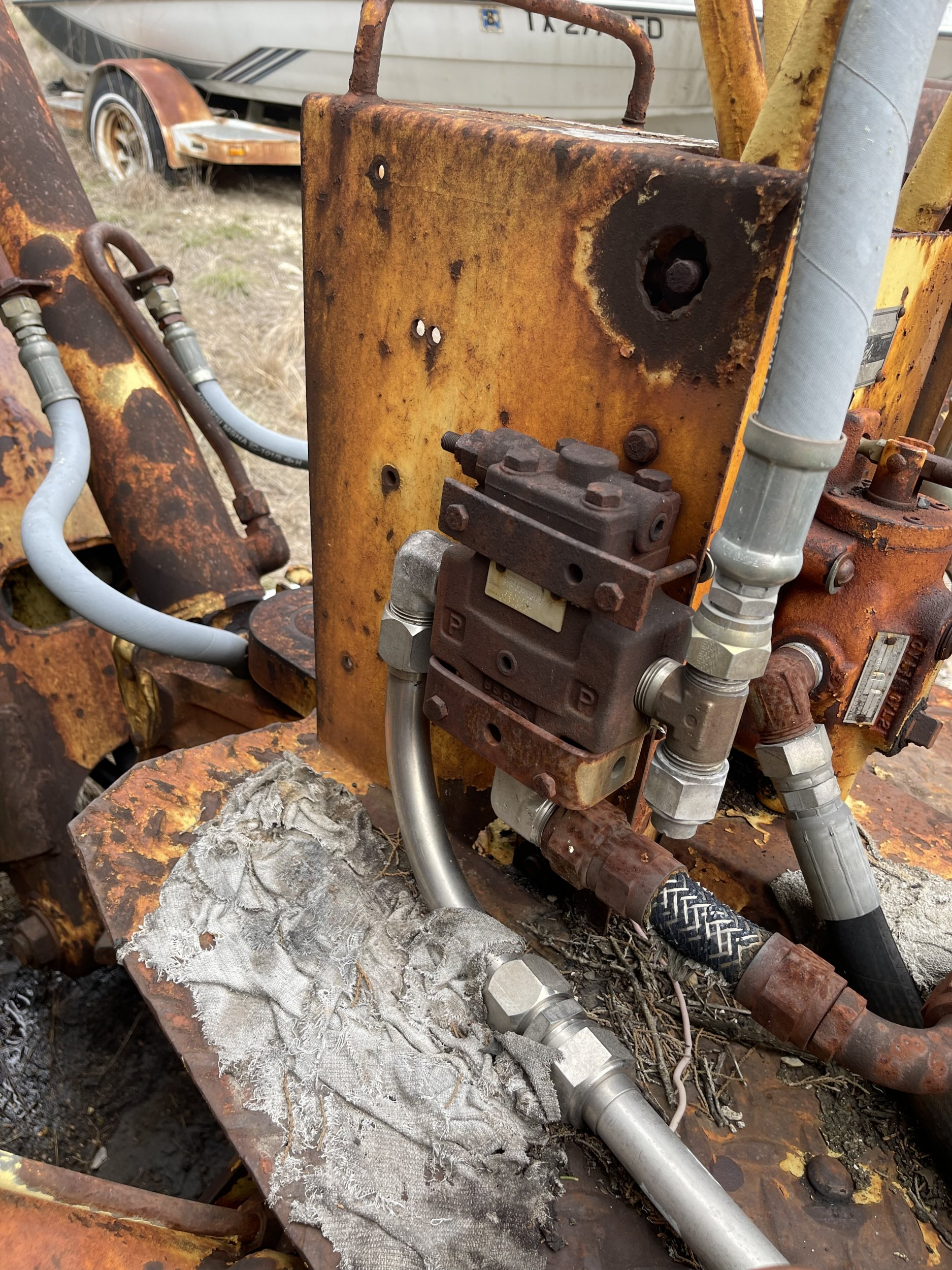

the first picture shows a lever operated directional valve that is connected directly to the pressure port via the gray hose. Where does the black hose go? This valve could be by-passing all the pump flow to some other function.
Second picture shows what appears to be a push-pull diverter valve. What do the lines going to that valve connect to?

Well the one on the side, that has the black hose coming off the bottom does indeed look like a type of relief valve. Where does the hose off the bottom go? Just back to tank?
The valve that is mounted on the control tower to the backhoe goes nowhere. It does nothing. Its just an open center valve that is serving NO purpose at this moment beyond what a simple coupler would do.
Now in the past it may have ran an attachment or hydraulic thumb. But since there are no other hoses, and the work ports are blocked off.....it has no function, and nothing to figure out

Could this actually be a control valve with the A&B ports plugged... And exactly what is gray hose connected to (on left side), another valve body( a "TEE" fitting)?...
/ What does this do? #15
e045aa2c-9b63-4a4e-b07d-bc1381dbba07-jpeg.776996
Yes, its just a control valve with teh work ports plugged. Like maybe the thing had a thumb at one time that was removed?
The thing on the side is just a pressure regulator
